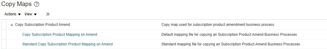

A new copy map for Amend is created in Copy Maps - Copy Subscription Product Mapping on Amend. You can modify this to meet your business requirements.
New Copy Map for Amend
You can set the copy map to be used in the profile option Copy Subscription Product Mapping on Amend.
