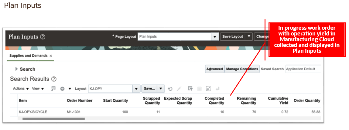

Example 2: Collection of an in-progress work order with operation yield from Oracle Manufacturing
The in-progress work order M1-1301 collected from Oracle Manufacturing has the following values:
  • Start quantity: 100
  • Scrapped quantity: 11
  • Completed quantity: 10
Since there's no shrinkage defined, the remaining quantity to be processed is 79 (100-11-10).
The work order has a cumulative operation yield of 0.72. When you apply cumulative operation yield to the remaining quantity, you get:
79 * 0.72 = 56.88
So, the expected order quantity after applying the cumulative operation yield of the work order would be 56.88.
In-progress Work Order with Operation Yield Collected from Manufacturing Cloud
In-progress Work Order with Operation Yield Collected from Oracle Manufacturing
