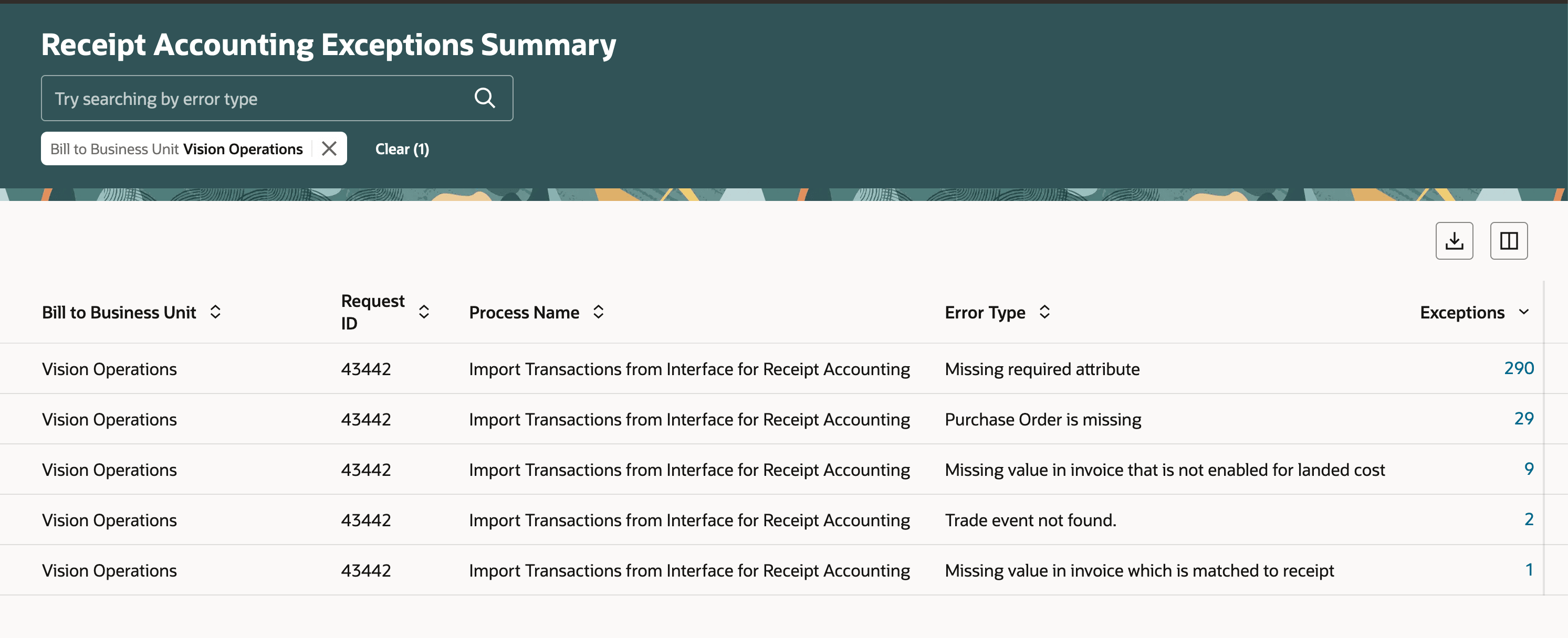

Receipt Accounting Exceptions Summary

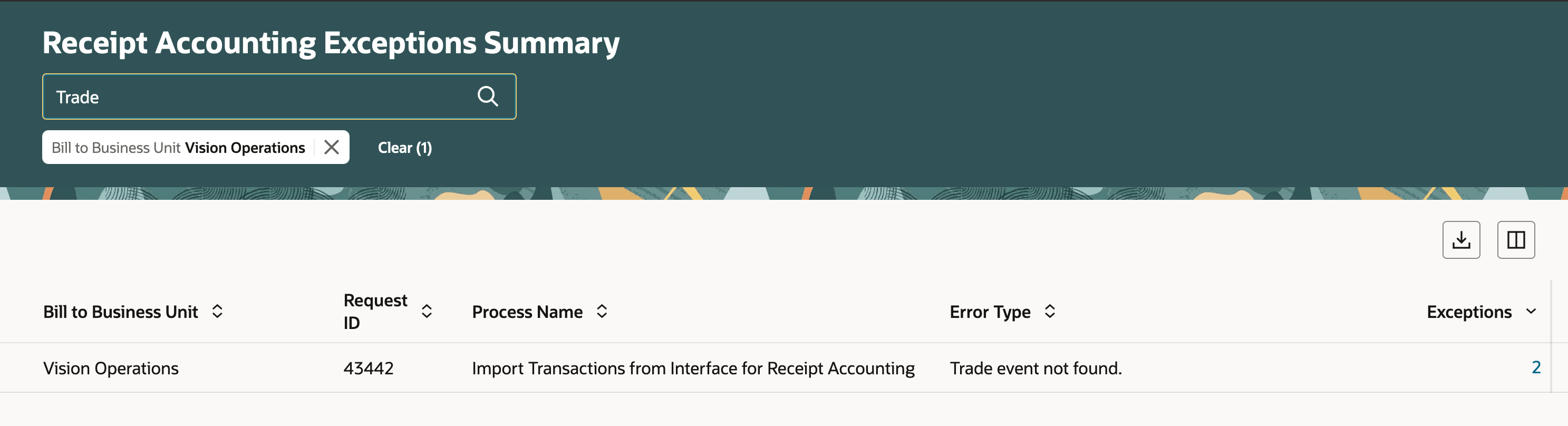

When you navigate to the Receipt Accounting Exceptions page, by default, you can view the summary page organized in the descending order of exceptions count. You can change the search criteria by selecting the business unit you manage, or by the error type:
Receipt Accounting Exceptions Summary - Search By Business Unit
Receipt Accounting Exceptions Summary - Search By Keyword
You can sort the data based on the following attributes in this page:
- Bill to Business Unit
- Request ID
- Process Name
- Error Type
- Exceptions
Click the exception count to view the specific transactions that can't be processed due to this error on the Receipt Accounting Exceptions page.

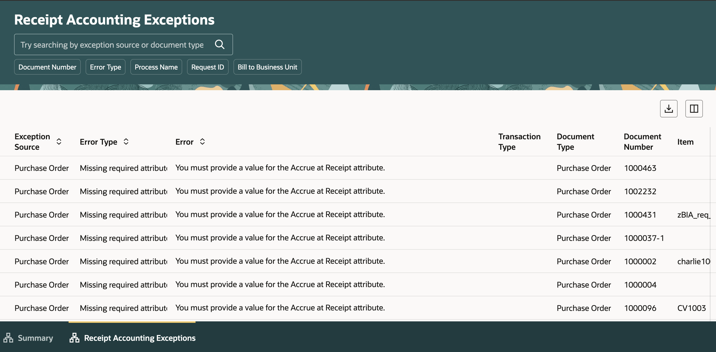

On this page, you can view the exceptions along with the transactions that can't be processed. You can navigate to this page from the Summary page in the context of specific error or you can directly access this page and investigate the exceptions based on your requirements.
You can filter the receipt accounting exceptions information by the following attributes:
- Document Number
- Error Type
- Process Name
- Request ID
You can also organize the information by the following attributes:
- Exception Source
- Error Type
- Error

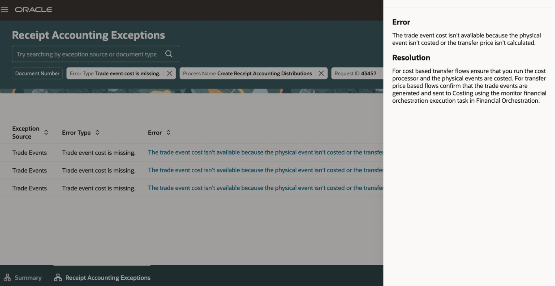

Click the error to see the suggested resolution.
Receipt Accounting Exceptions - Resolution

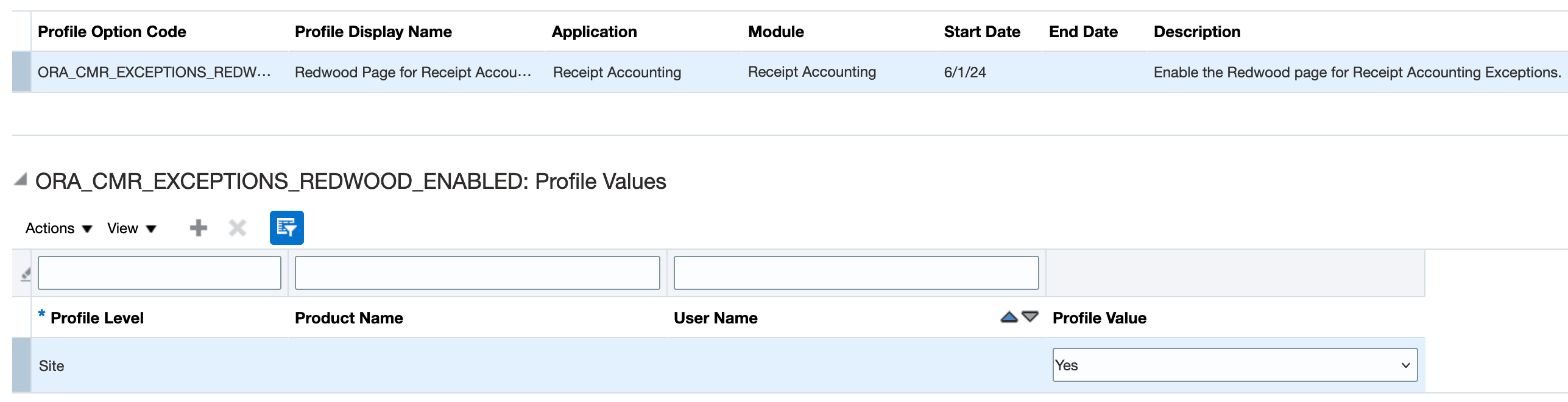

Steps to Enable
- In the Setup and Maintenance work area, search for and select the Manage Administrator Profile Values task.
- On the Manage Administrator Profile Values page, search for and select the ORA_CMR_EXCEPTIONS_REDWOOD_ENABLED profile option code.
- In the Profile Values section, set the Site level to Yes. The default value is No.
- Yes = enables the feature
- No = disables the feature
- Click Save and Close. Changes in the profile value will affect users the next time they sign in.
