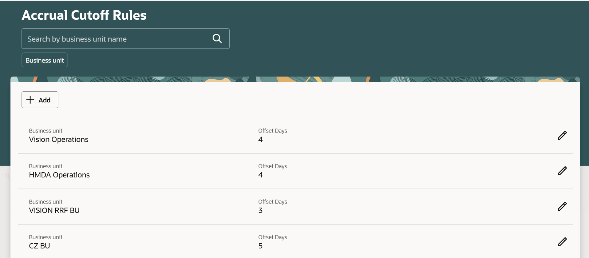

- Search Accrual Cutoff Rules
Accrual Cutoff Rules page

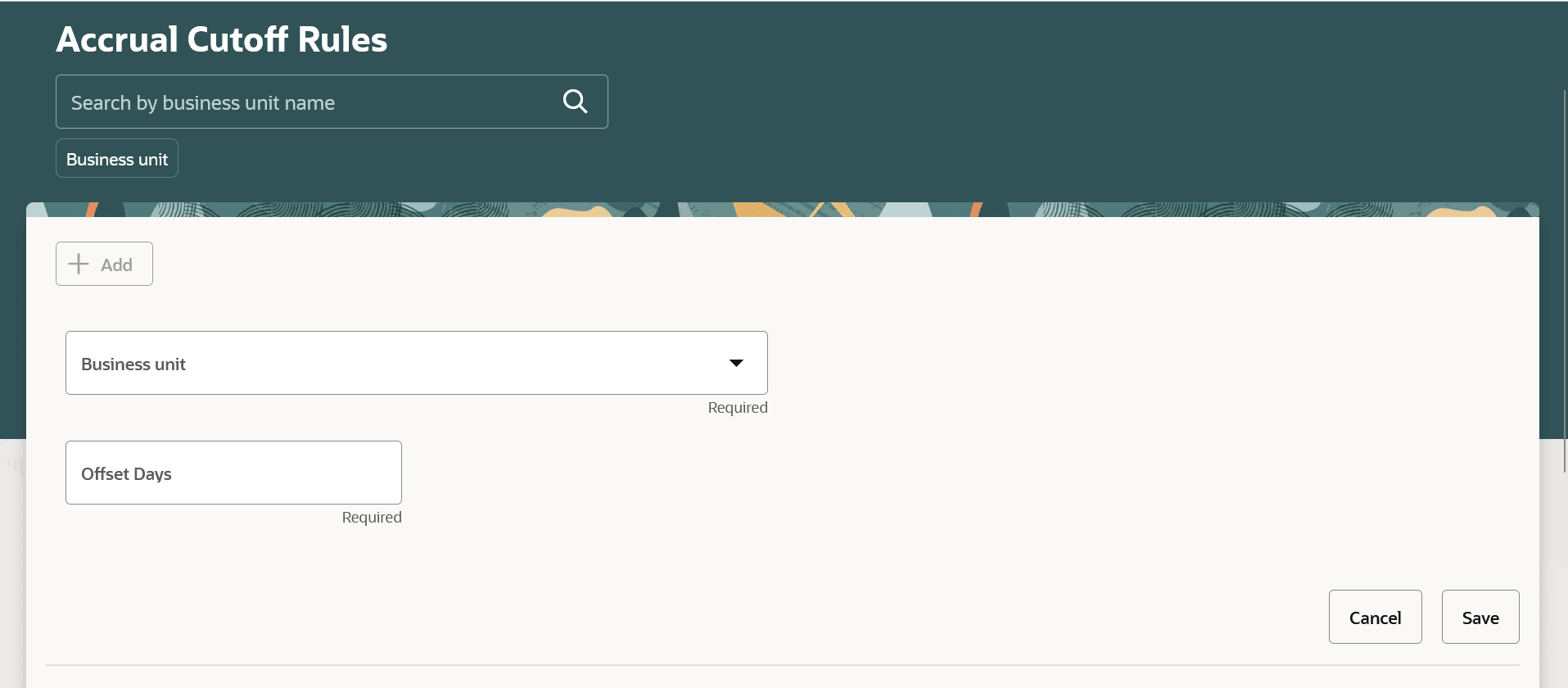

- Create Accrual Cutoff Rule: You can create a new accrual cutoff rule for a business unit which doesn't have existing rule setup.
