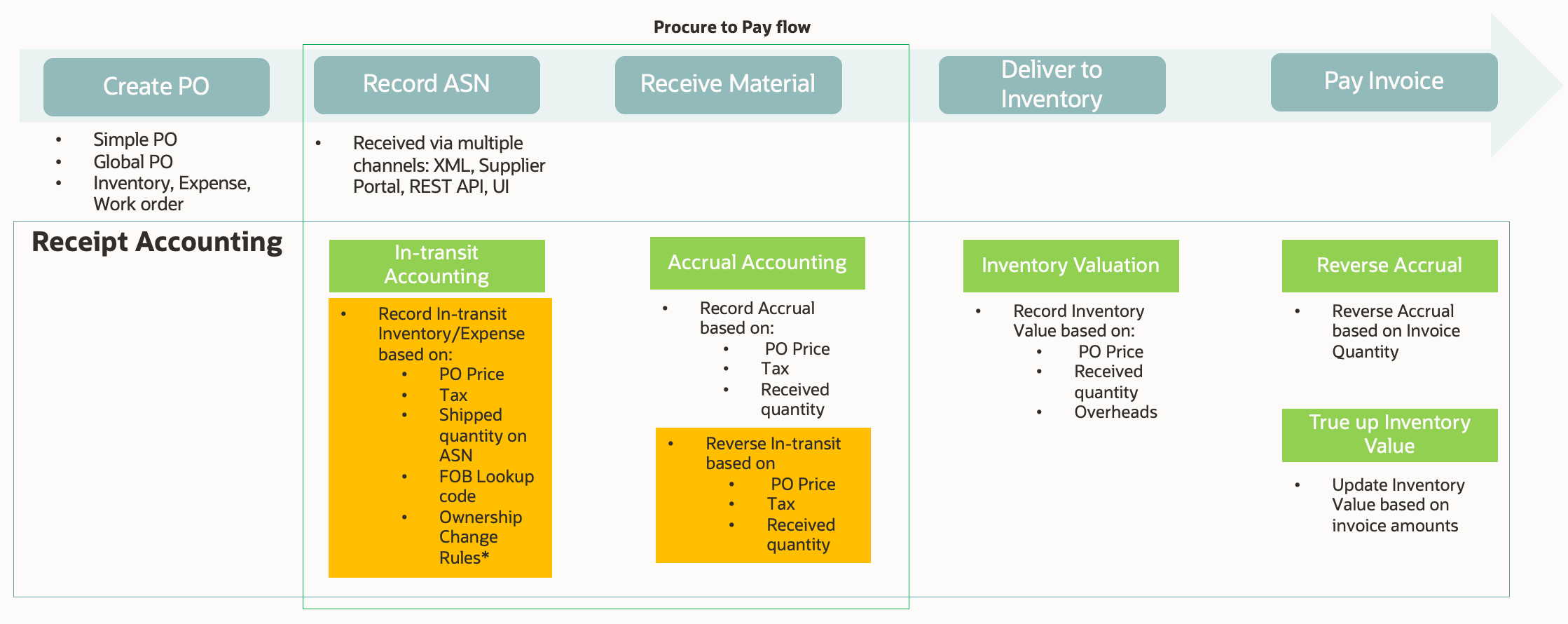

Generate in-transit accounting for the inbound purchase order shipments using an ASN in standard purchasing and global procurement flows. Here's a visual representation of where recording and accounting in-transit value fits in the overall procure to pay receipt accounting flow.
In-transit Inventory Accounting in Procure to Pay Flow
  • The new Record In-transit Inventory and Expense for External Purchases schedule process computes the in-transit value and creates new transactions and distributions for recording in-transit inventory or expense for purchase order based shipments
  • This process considers the following information to compute in-transit value for each purchase order schedule and shipment line combination:
    • ASN Data: All valid ASNs in expected or partially received status for open purchase orders.
    • Purchase Order: All open purchase orders for accrue at receipt purchases (except consignment).
    • The in-transit amount is computed by multiplying the net shipment quantity with the PO price + nonrecoverable tax.
    • Net shipment quantity is equal to shipment quantity on the ASN minus receipt quantity for the purchase order schedule.
  • Transactions and accounting distributions are created for each purchase order schedule and ASN shipment line combination.
  • The in-transit inventory or expense is reversed by the next run of the process when goods are received.
  • Valid ASNs are determined based on the In-transit Valuation Ownership Change Rules set up by you for each FOB lookup code.

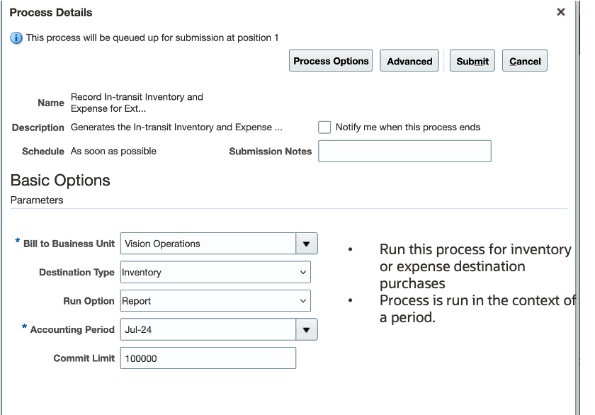

  • The process can be run from the Scheduled Processes work area or the Receipt Accounting work area in the Report mode or the Accounting mode:
    • Report mode lets you view in-transit value at any point of time based on latest and greatest purchase order and shipment information and not create accounting distributions. This helps you in avoiding additional transactions and distributions in cases where shipments and receipts are likely to be recoded in the same accounting period.
    • Accounting mode also creates new set of transactions and distributions every time the process is run.

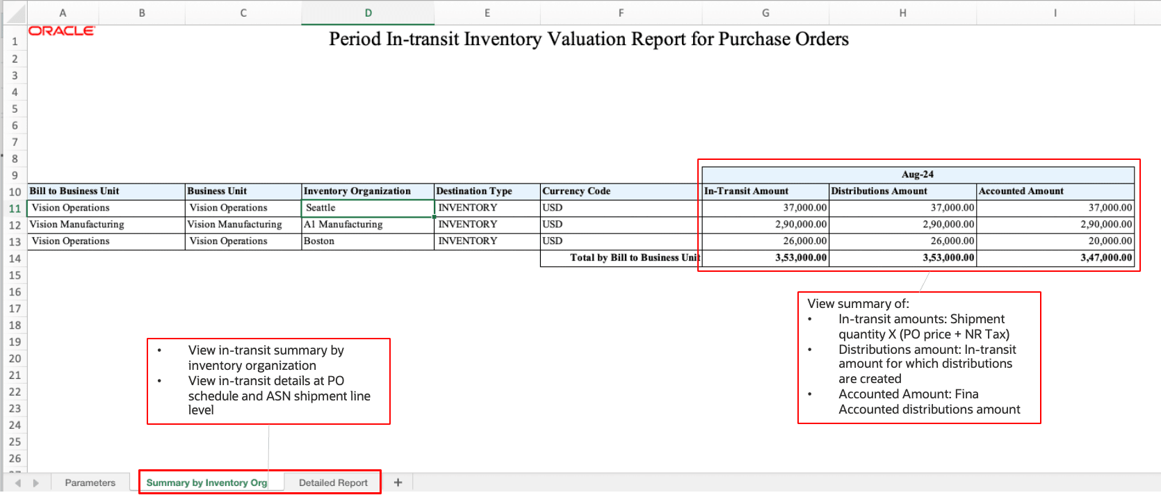

  • The process automatically generates a Period In-transit Inventory Valuation Report for Purchase Orders, which can be used to view:
    •  Summary in-transit value by inventory organization
Summary Report

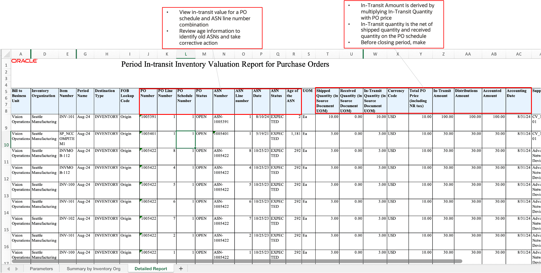

  • Detailed in-transit information for each purchase order schedule and shipment line
Detailed Report

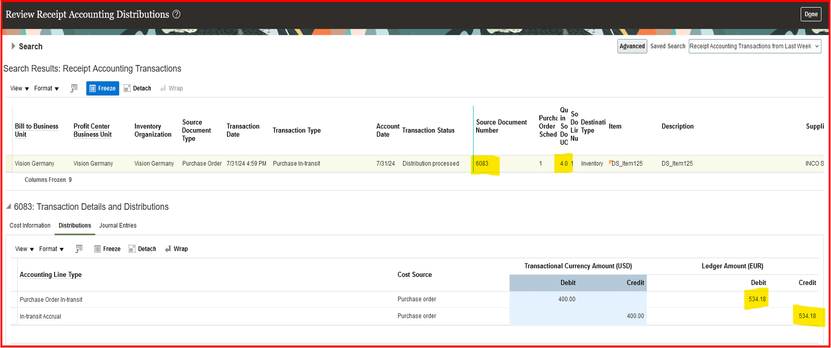

  • The process automatically creates transactions and accounting distributions that can be viewed on the Review Receipt Accounting Distributions page. You can view such transactions by searching for purchase order number or ASN number.
Review Receipt Accounting Distributions for In-Transit
  • Journal entries are created using the Create Accounting process and can be view in the journal entries tab of the Review Receipt Accounting Distributions page
Journal Entries for Purchase Order In-transit

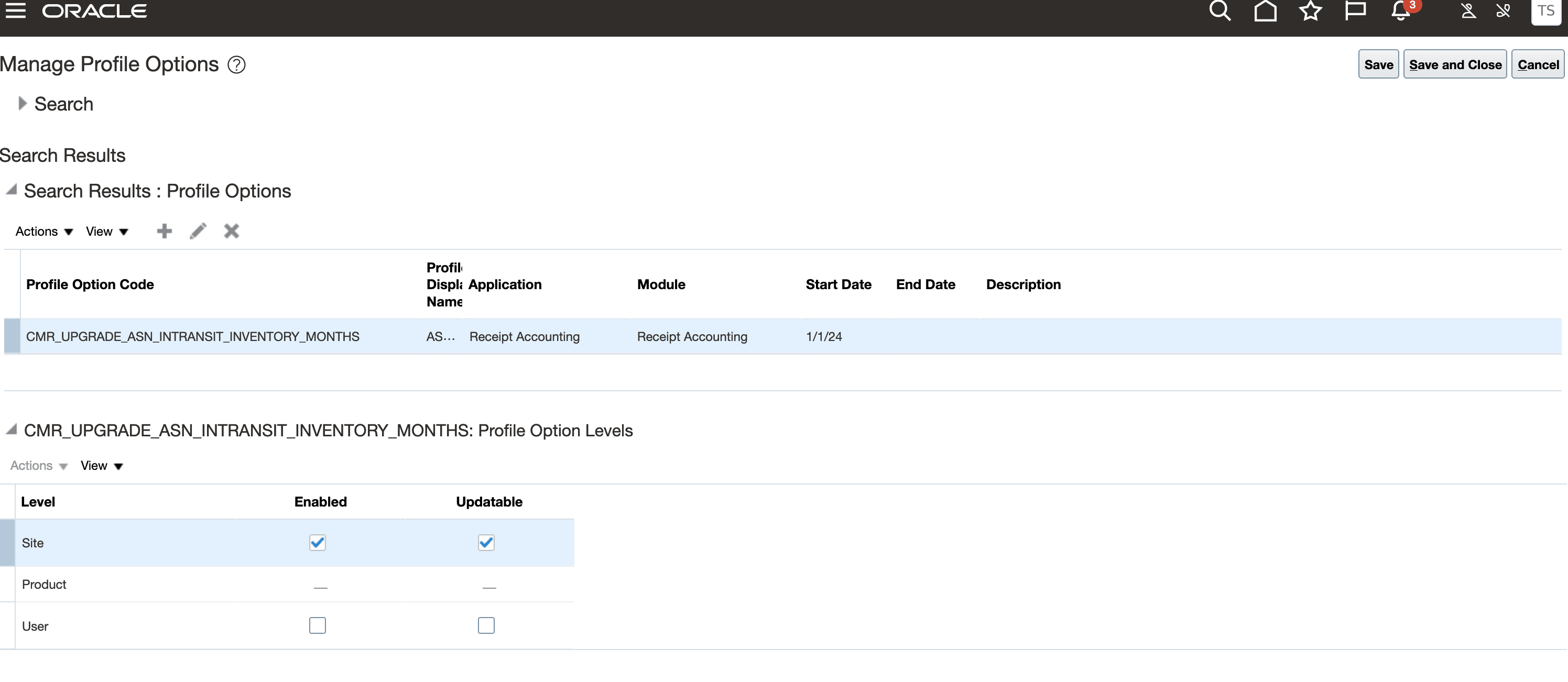

  • Optionally, create and set up a one-time profile option CMR_UPGRADE_ASN_INTRANSIT_INVENTORY_MONTHS under Receipt Accounting application and module to consider open ASNs for a different time period than the default of 3 months when running this process for the first time. You can provide any value between 1 and 12. Any value greater than 12 months or a junk value provided by the user is ignored and the process considers the default as 3 months. See tips and considerations for more details. The profile can be set up based on the below steps:
    • Create new profile option in the Manage Profile Options page:
Create a new profile option
  • Search the profile option on the Manage Receipt Accounting Profile Options page and provide a value between 1 and 12
Set up profile option value

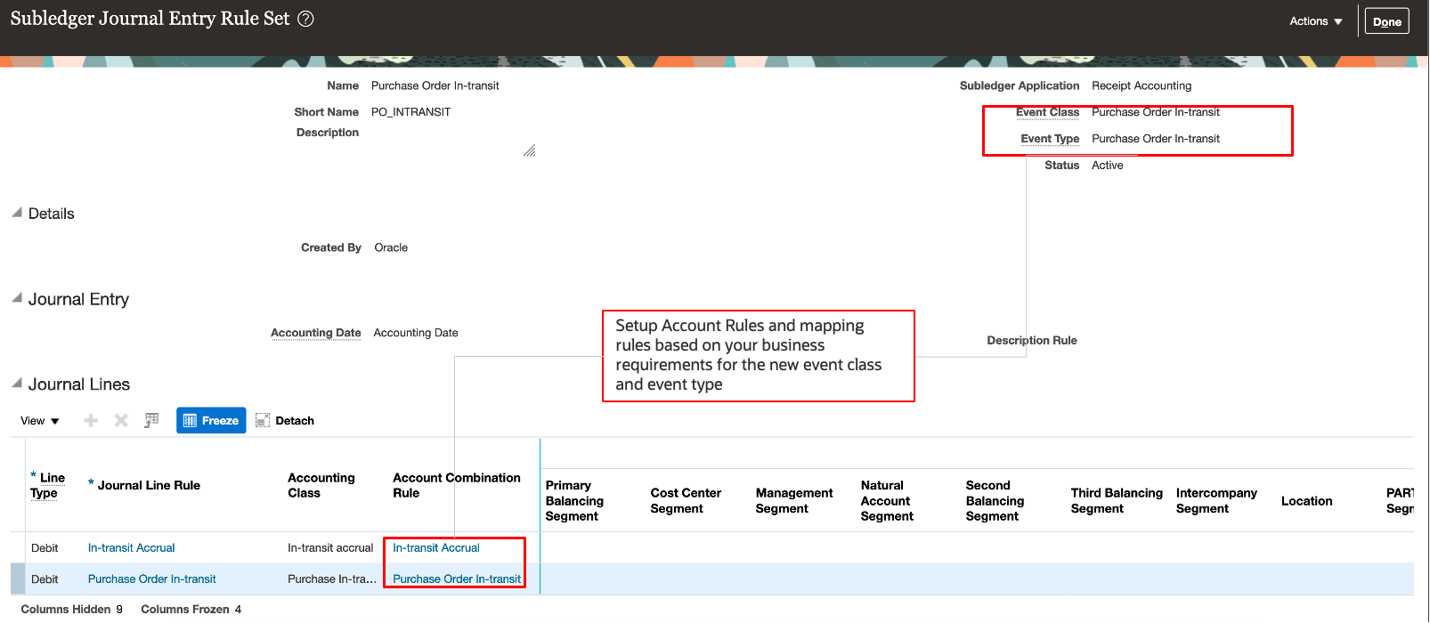

  • Ensure that the subledger accounting setup (mapping sets, account rules) is complete for the new event type. You can modify the seeded mapping set and account combination rules based on your business requirements
Journal Entry Rule Set for Purchase In-transit
