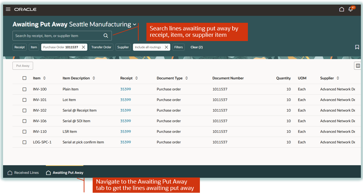

Click the Received Lines task, and then select the Awaiting Put Away tab. The Awaiting Put Away page displays the lines that have been received or inspected and are awaiting put away.
You can search for lines awaiting put away by entering the receipt, item, or supplier item as a keyword in the Search field. Additionally, you can filter your search using the Receipt, Item, Purchase Order, Transfer Order, and Supplier attributes.
You can use the Filters button to refine your search with additional attributes:

Lines Awaiting Put Away

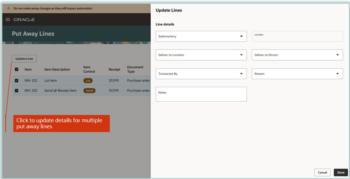

You can select multiple put away lines and update the subinventory, locator, deliver-to location, deliver-to person, transacted by, reason, and notes for the lines during put away.

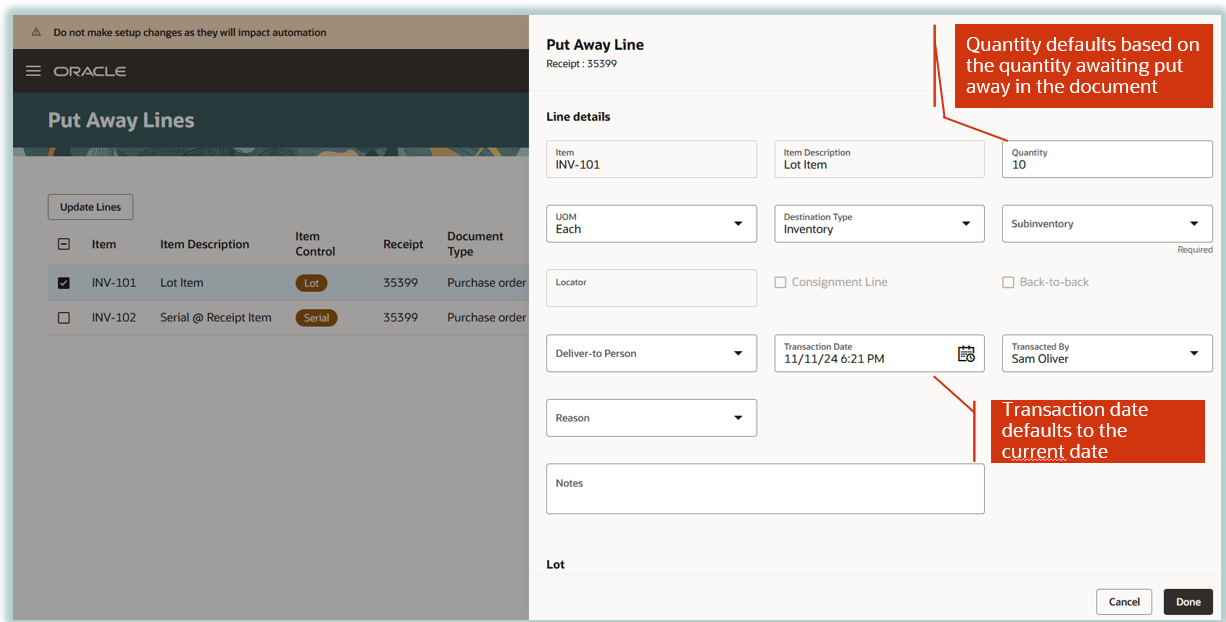

Update Put Away Lines
You can update the put away details for a specific line in the Put Away Line drawer. In the drawer, the transaction date defaults as the current date and the quantity of the line awaiting put away defaults in the Quantity field. You can append attachments to the put away line during put away.
