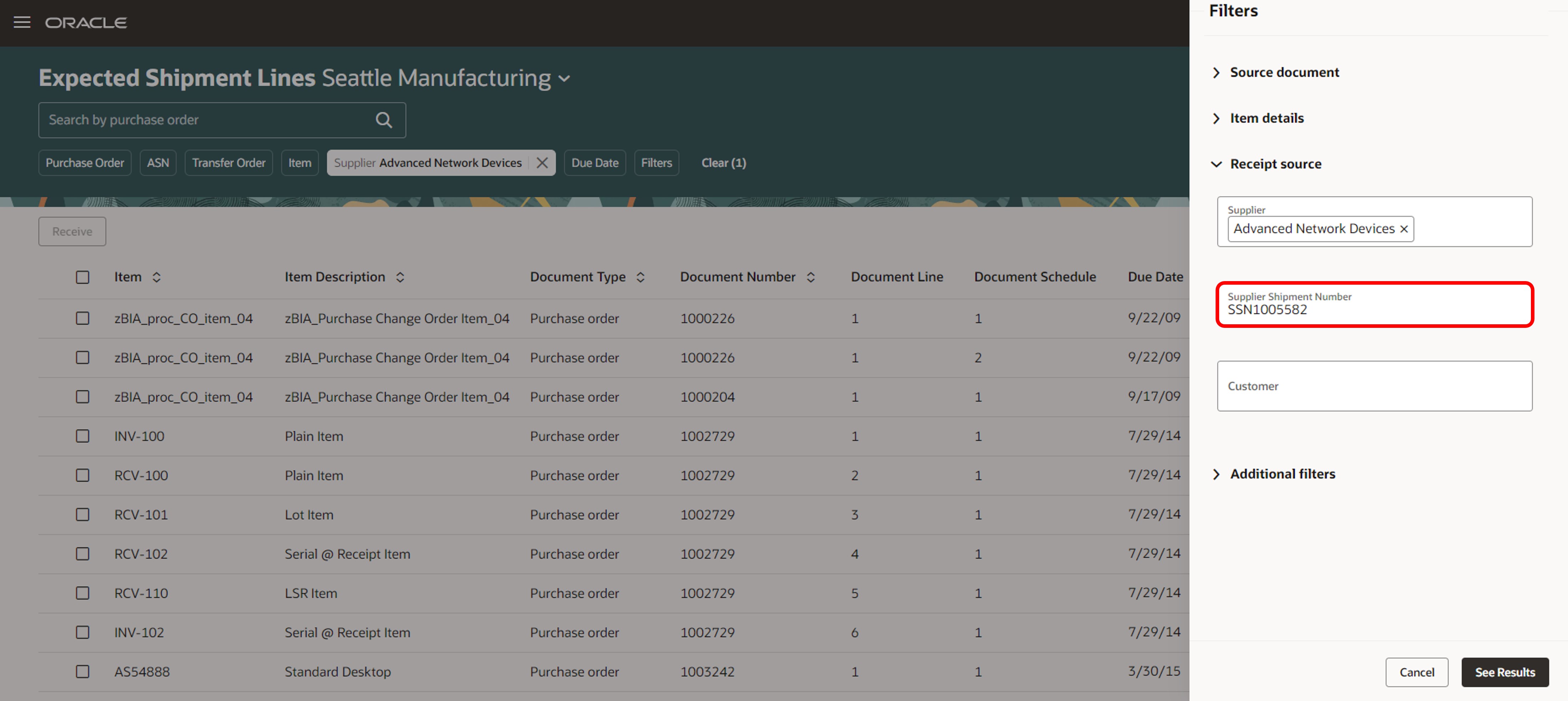

On the Expected Shipment Lines page, you can search for expected shipment lines by the Supplier Shipment Number after filtering by supplier.

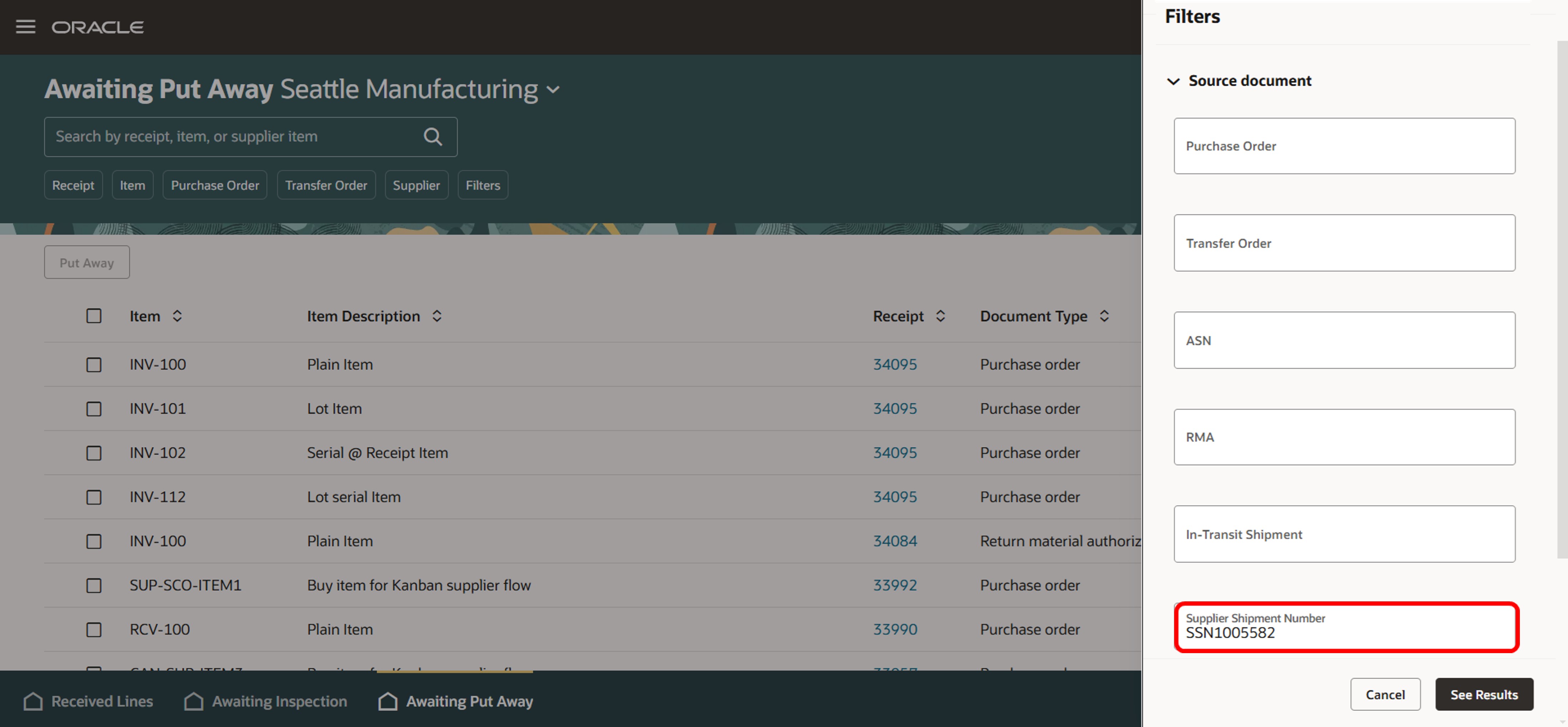

On the Awaiting Put Away page, you can search for receipt lines that are awaiting put away by the Supplier Shipment Number.

This feature allows you to easily search for and view your expected and completed receipts that share the same supplier shipment number.
