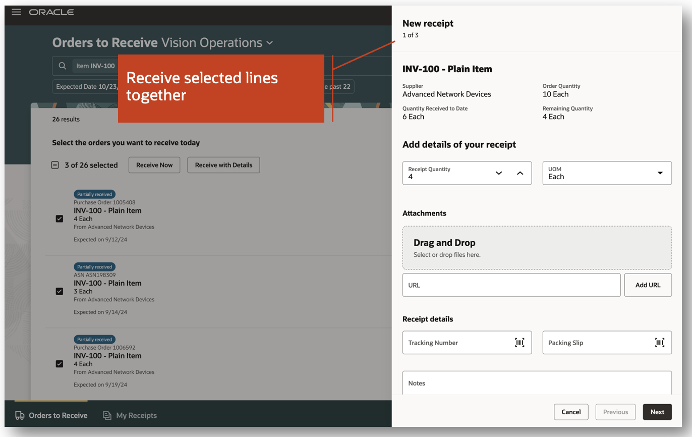

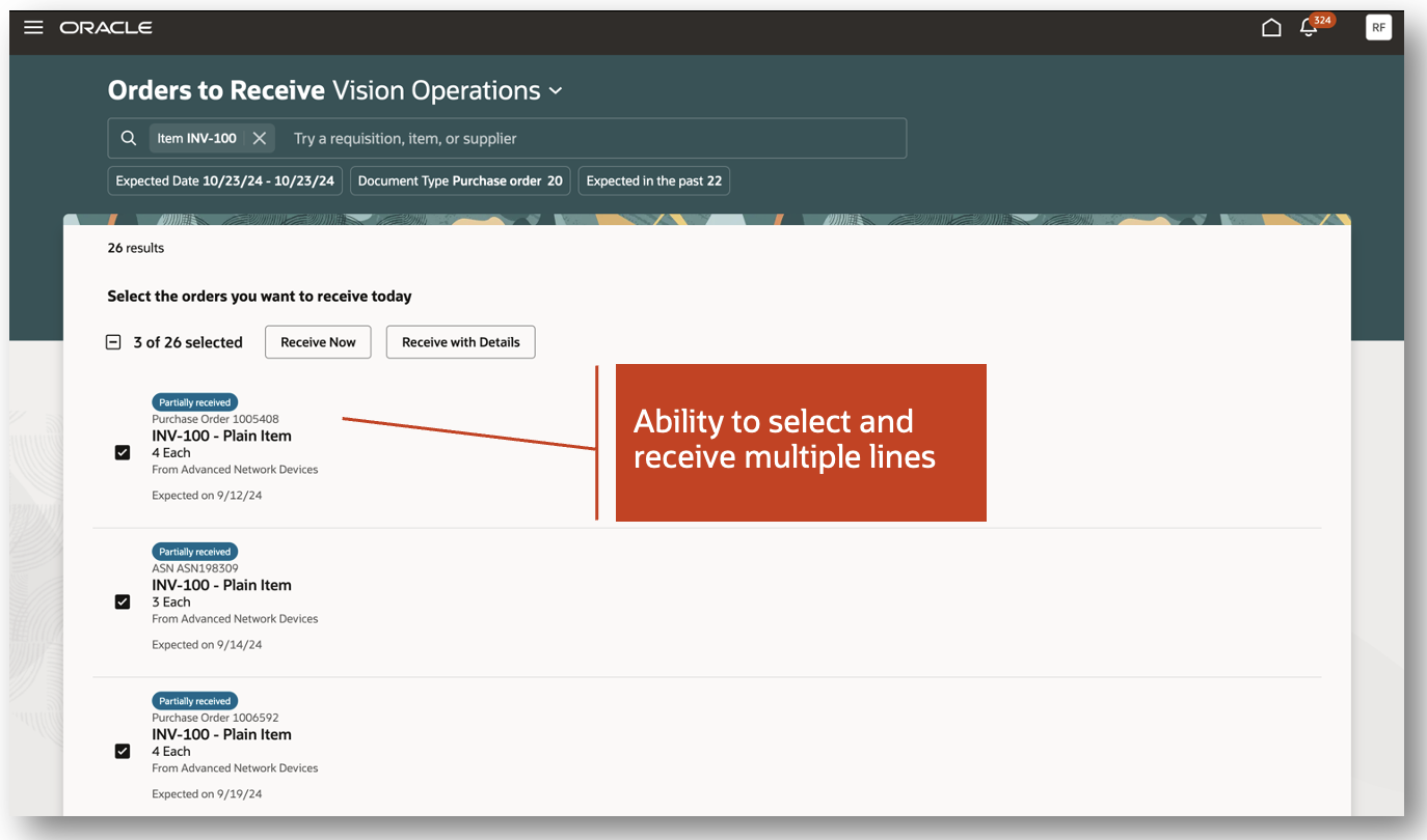

You now have the ability to receive multiple order lines together and create a single receipt for those lines when receiving goods in the Responsive Self-Service Receiving application as a casual receiver. Once you search for your orders, you can select one or more orders to receive. You can easily select the orders you want to receive by selecting the checkbox associated with each order.
Select and Receive Multiple Lines
Once you've selected the orders you intend to receive, you can click the Receive Now button to perform an immediate receipt. You also have the option to click the Receive with Details button to enter the receipt details when performing the receipt. Once you've performed the receipt, you'll be presented with a message indicating that the receipt was created successfully.
This feature allows you to process receipts quickly and accurately by selecting multiple lines together when creating receipts as a casual receiver.
