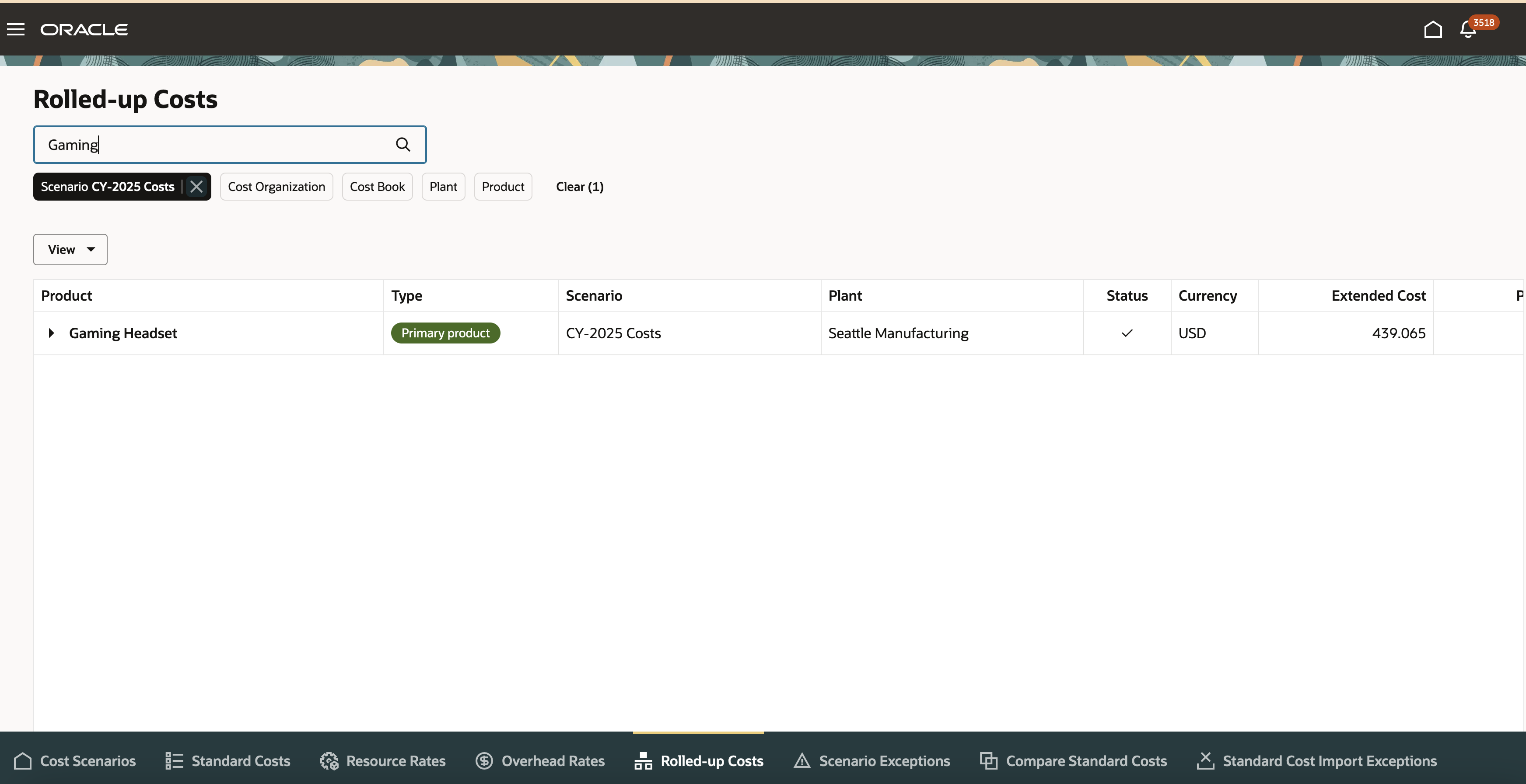

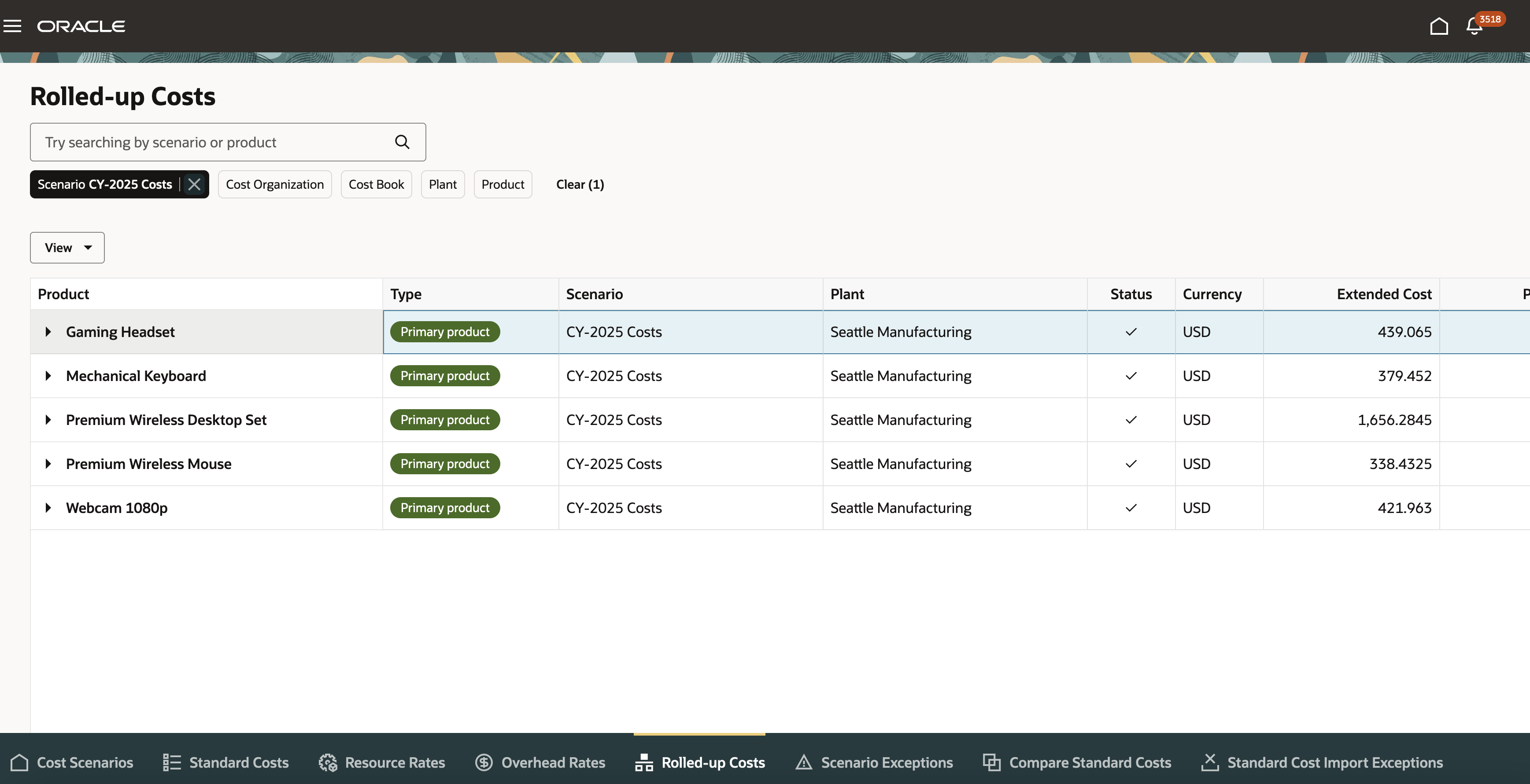

Rolled-up Costs page displays all the product costs from the cost scenario that has been rolled up most recently. You can search for the records and filter the results based on your requirements.
Rolled-up Costs Page
Most importantly, you can now search for the rolled-up cost of the product by the item number. You can use this filter to search for product cost within a cost scenario or find the rolled-up costs of the product across cost scenarios.
Search by Item Number

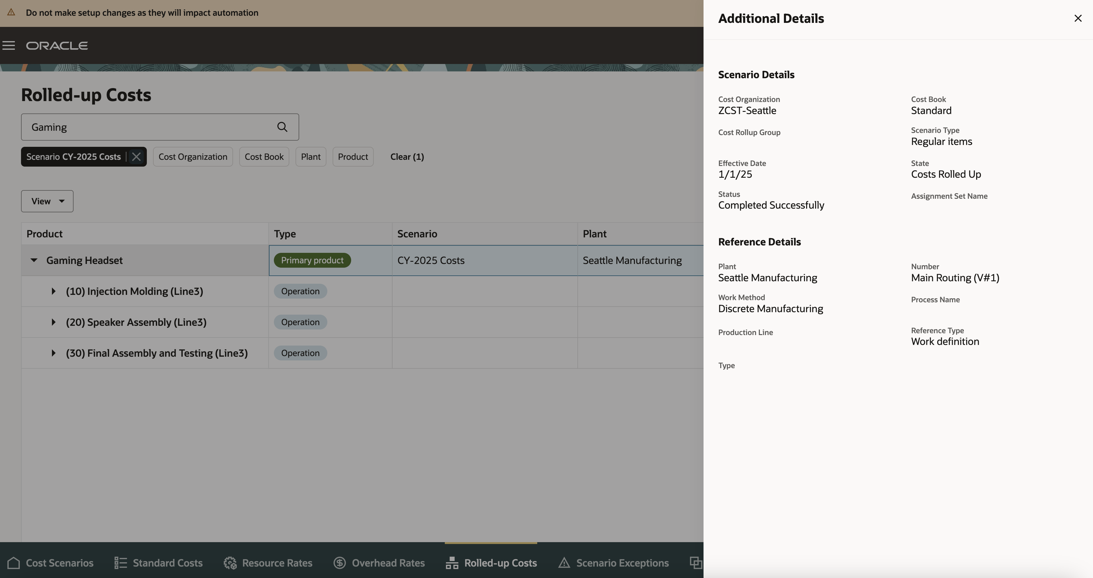

The Additional Details view provides you with the reference information for a product. The sourcing rule information would also be displayed, if you use the supply chain cost rollup process.
Additional Details in Rolled-up Costs Page

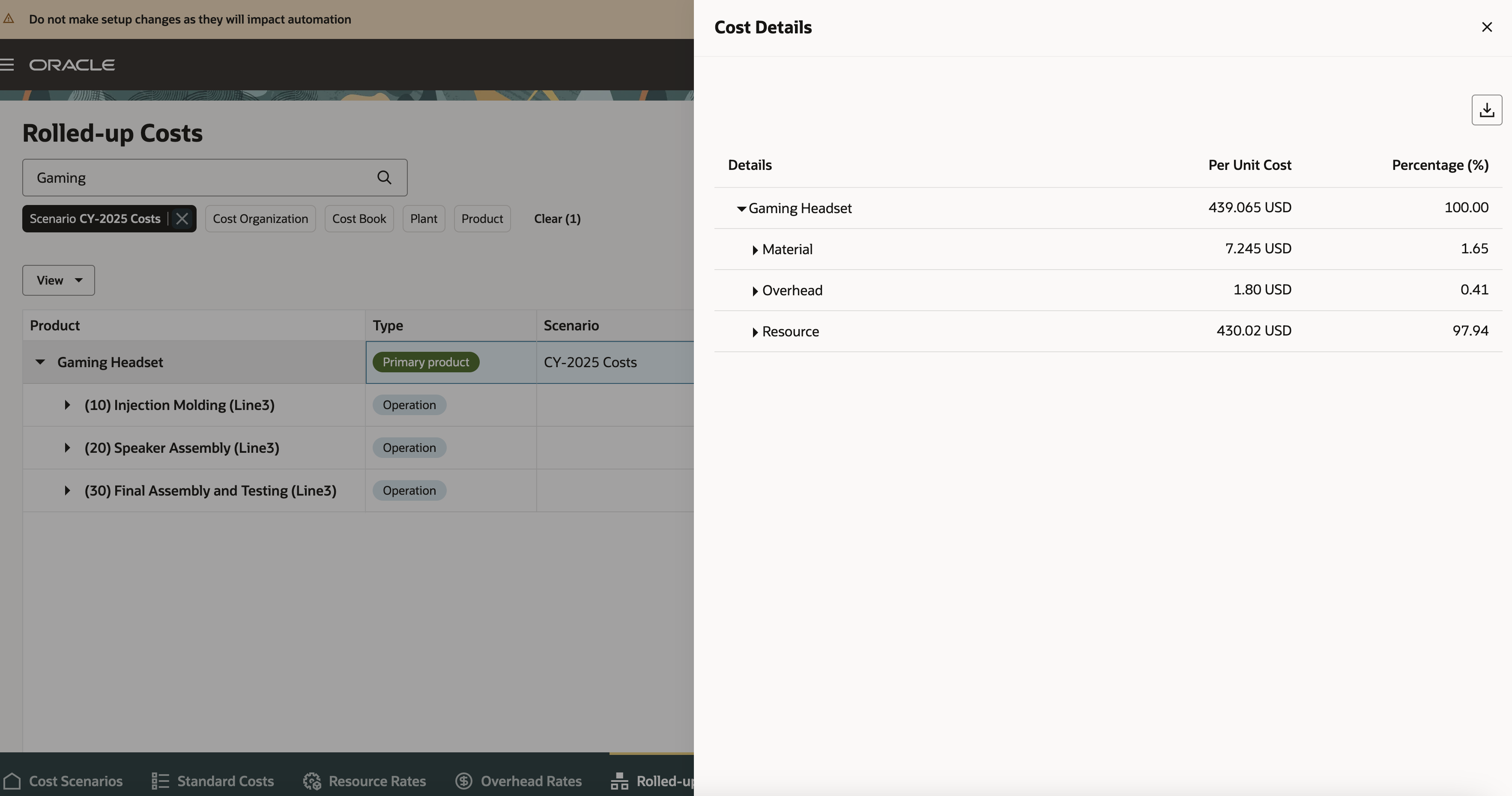

Similarly, the Cost Details view provides the cost breakdown across cost elements. This will be enabled for products, components, materials, and resources.
Cost Details in Rolled-up Costs Page
Similar to the ADF page, you can drill down the product cost records to see the underlying operations, materials, resources, overheads, sourcing rules (if using supply chain cost rollup enabled process), residual costs (if using process manufacturing) and estimated scrap loss (if using operation yield).
