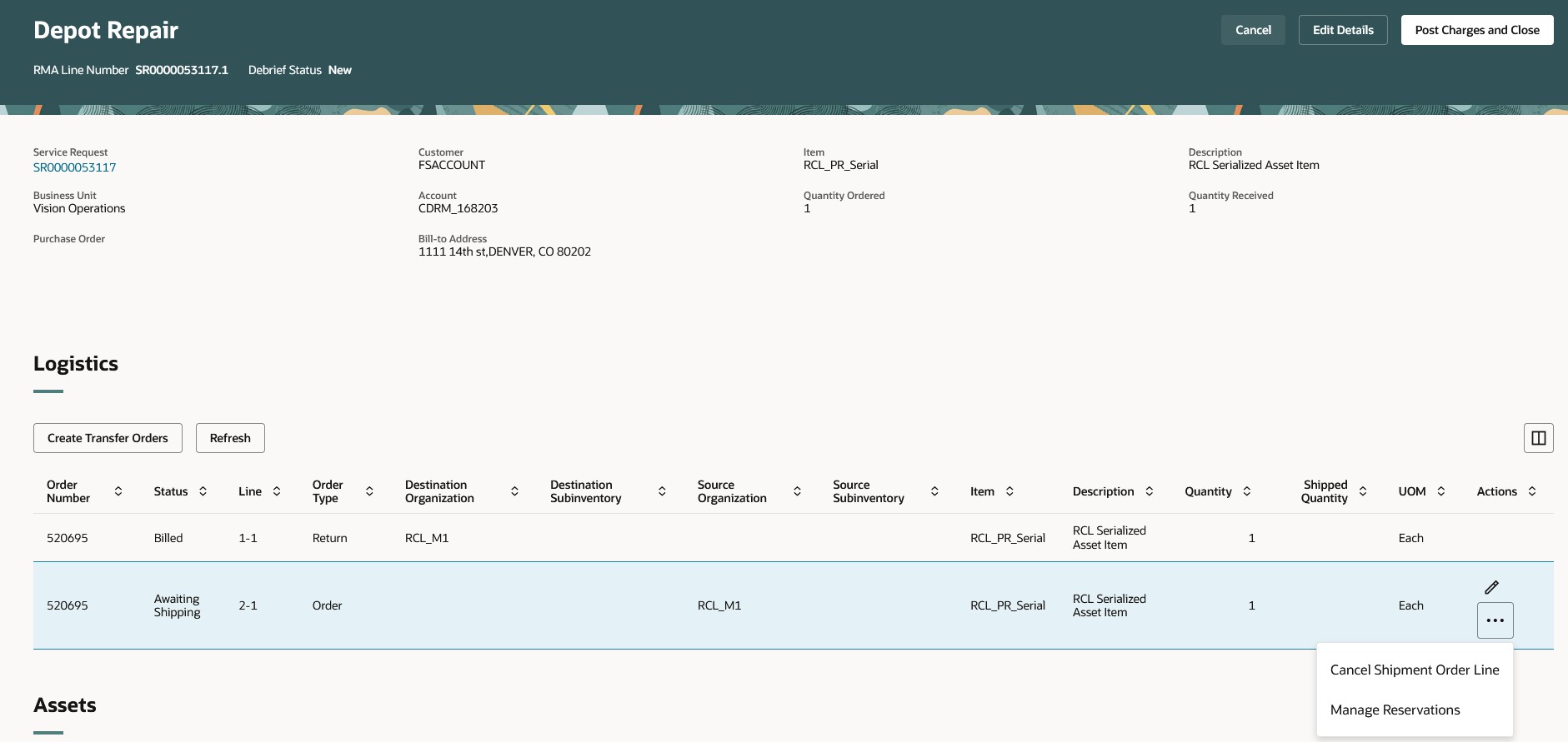

A new Manage Reservations action has been added to the Logistics region for shipment lines where the quantity ordered is greater than the quantity shipped. This action opens a new Manage Reservations UI, as shown in the following screenshots.
Depot Repair UI Logistics Region
Depot Repair UI Logistics Region - Actions Menu

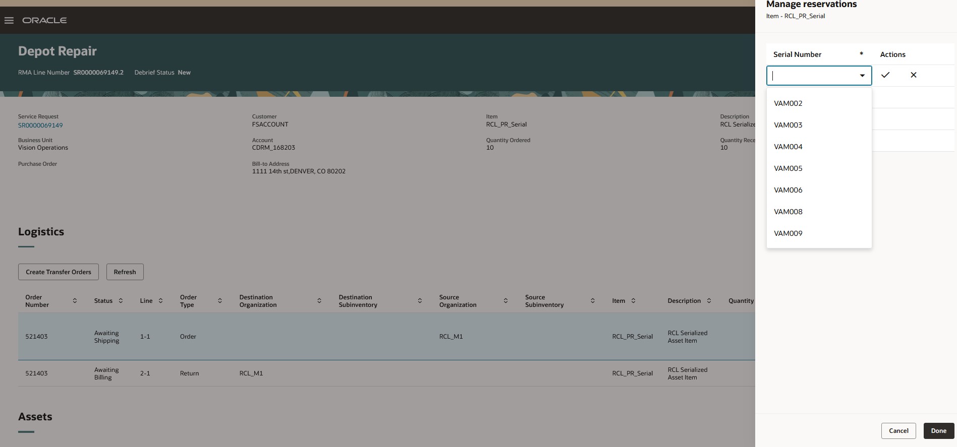

The Manage Reservation UI allows to view and create serial number reservations against the shipment sales order line.  The serial number LOV displays unreserved serial numbers located in the source organization or sub-inventory.  Select a serial number and then click the check mark to create a reservation.
Manage Reservations UI - Serial Number LOV
