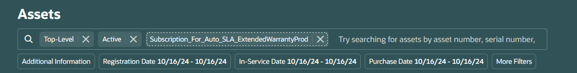

Find Assets by Associated Subscription Number
Type in the subscription number in the search field of the Assets page and press the Enter key. The Results table shows assets associated with the subscription number. Here's a screenshot of the search field that shows existing predefined filters and a filter to search by subscription number.
Asset Information Management Search Field with Default Filters and Search by Associated Subscription

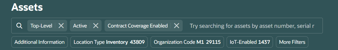

Find Assets by Contract Coverage Enabled Filter
You can also search by a new predefined filter, Contract Coverage Enabled. All the predefined filters for assets are available right under the search field. Click a filter to apply it on your search. Here's a screenshot of the search field that shows all the predefined filters available to improve your search. The search field also shows the Contract Coverage Enabled filter applied on search.
Asset Information Management Search Field with Default Filters and Contract Coverage Enabled Filter
