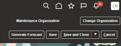

Here's a screenshot that shows the new Generate Forecast button at the top of the Work Requirement page.
Generate Forecast Button on the Work Requirement Page

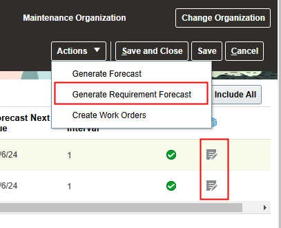

Here's a screenshot that shows the actions at the top of the Assets page and at the row level for an included asset. The actions dropdown includes Generate Forecast, Generate Requirement Forecast, and Create Work Orders.
Generate Requirement Forecast Action on the Assets Page

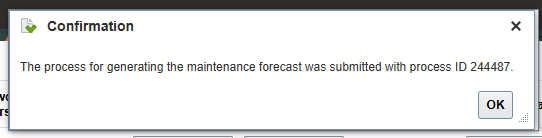

When you click the Generate Forecast button, a scheduled process is run. You get a confirmation message as shown in this screenshot.
Confirmation of scheduled process

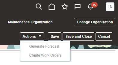

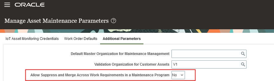

The new actions to generate the forecast for a work requirement or only for an included asset within the work requirement's affected asset list will only be enabled if the Asset Maintenance Parameter option Allow Suppress and Merge across Work Requirements in a Maintenance Program is set to No. Here's a screenshot of the Manage Asset Maintenance Parameters page that highlights the parameter.
Asset Maintenance Parameter Option Allow Suppress and Merge across Work Requirements in a Maintenance Program
We recommend setting this parameter to No, thereby disabling this capability unless you have an established business requirement and fully understand its capability and limitations. Merge and suppress options that support multiple work definitions across intervals in a cycle are best modeled and forecast within a single work requirement.

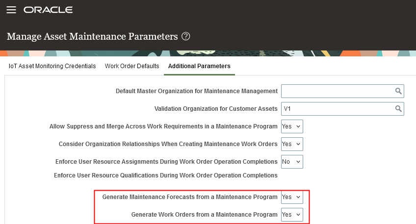

The actions to generate the forecast or work orders from the program page can be individually disabled if their parameters are set to No.
Parameters to Disable Functionality from the Maintenance Program page
