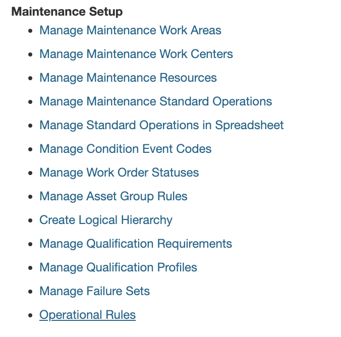

Use the new Operational Rules task in the Maintenance Management work area to create rules that can create maintenance work orders based on condition events.
Operation Rules task in Maintenance Management
Operational Rules Task in Maintenance Management
The Operational Rules page shows a list of existing rules. You can create, edit, and delete rules from this page.
Operation Rules Page
Operational Rules Page

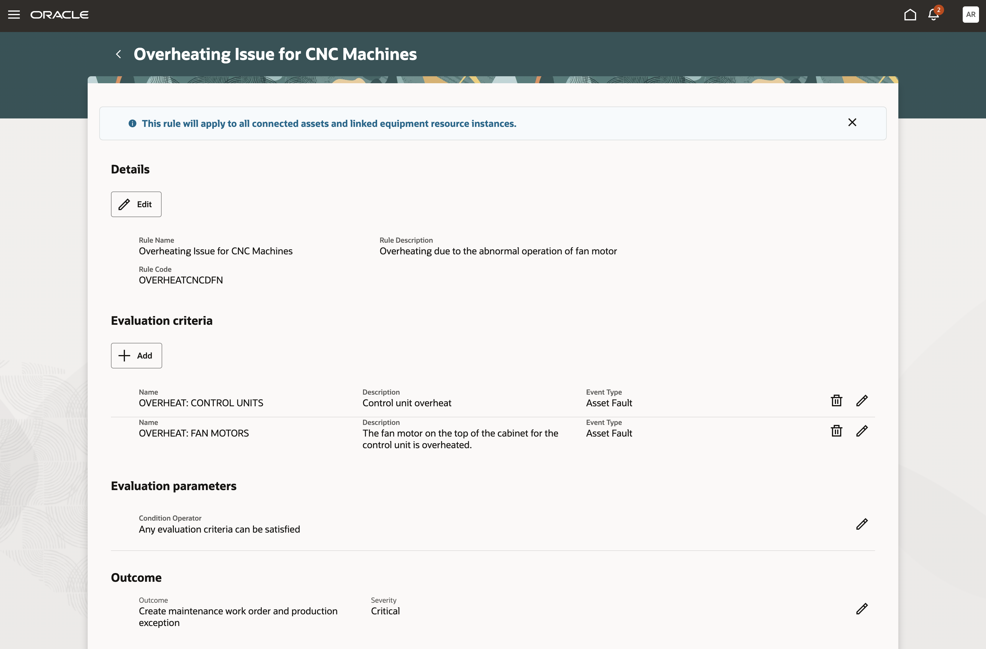

The rule definition screen lets you edit the rule:
  • Details of the rule contain the general definition of the rule, such as the name, code and description.
  • Evaluation criteria defines the conditions that are evaluated for incoming events.
  • Evaluation parameters define if any or all evaluation criteria need to be satisfied for the rule to trigger.
  • Outcome defines the actions that are executed if the evaluation is successful.
Rules Definition Page
Rules Definition Screen

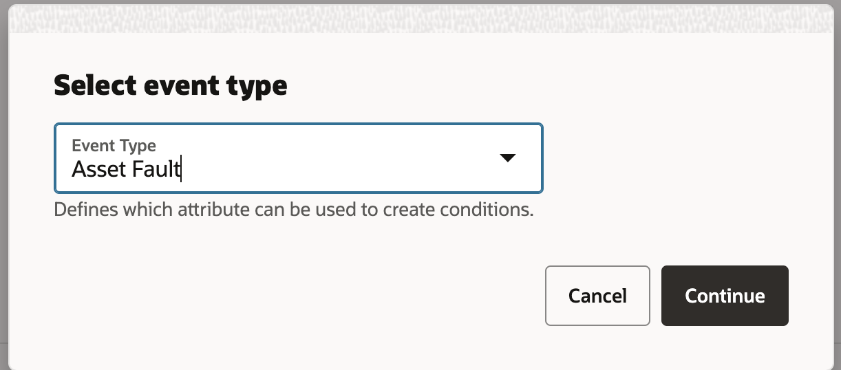

When adding an Evaluation criteria, use the Asset Fault event type for Maintenance.
Asset Fault Event Type

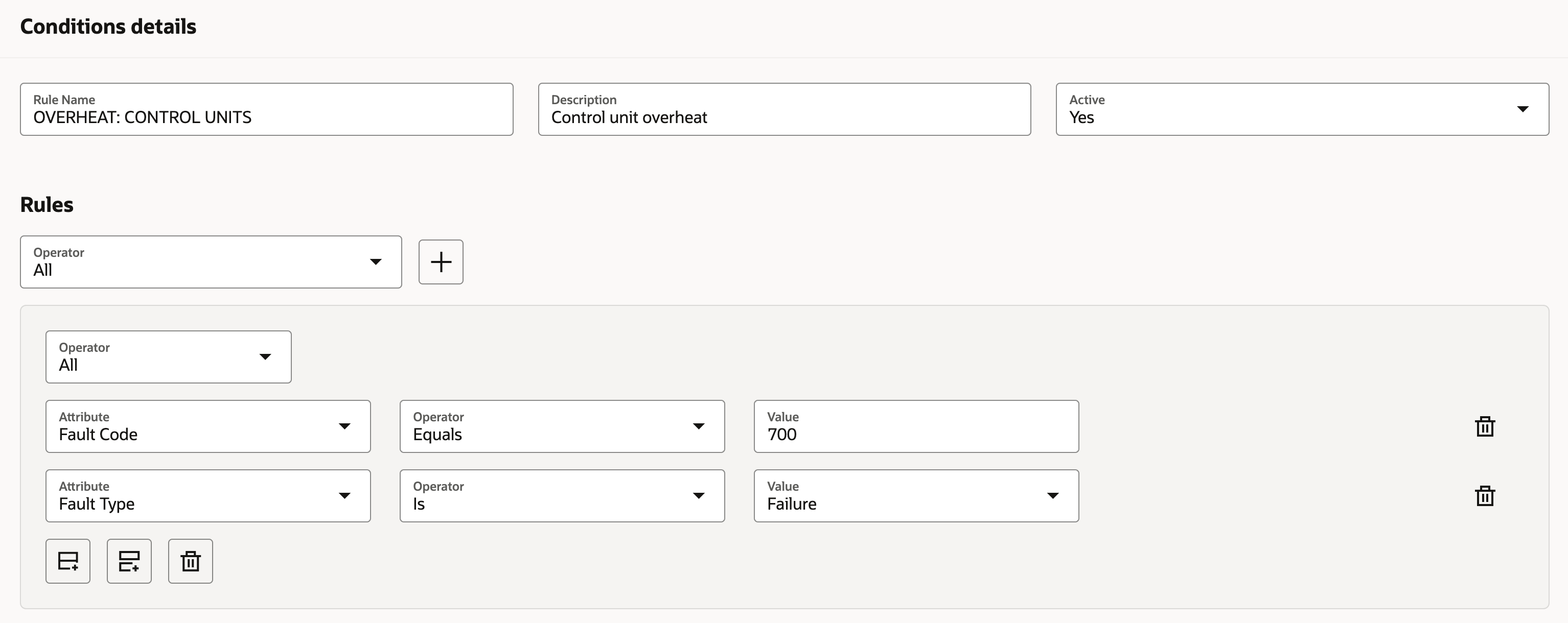

Every evaluation condition contains multiple sections:
  • Condition details include the condition name, description, and whether the condition is active.
  • The Rules section has operators at the rules and conditions levels, which determine if Any or All of the condition lines must be met.
  • Condition lines define the rule conditions using Attributes, Operators, and Values. Any combination of Fault Code and Fault Type attributes can be used for asset faults. Fault Code and Fault Type are those sent by the connected equipment. Examples of operators include Equals and Not Equals.
    For example: Fault Code equals 700.
Evaluation Condition Screen showing Condition details and Rules
Evaluation Condition Screen Showing Condition Details and Rules

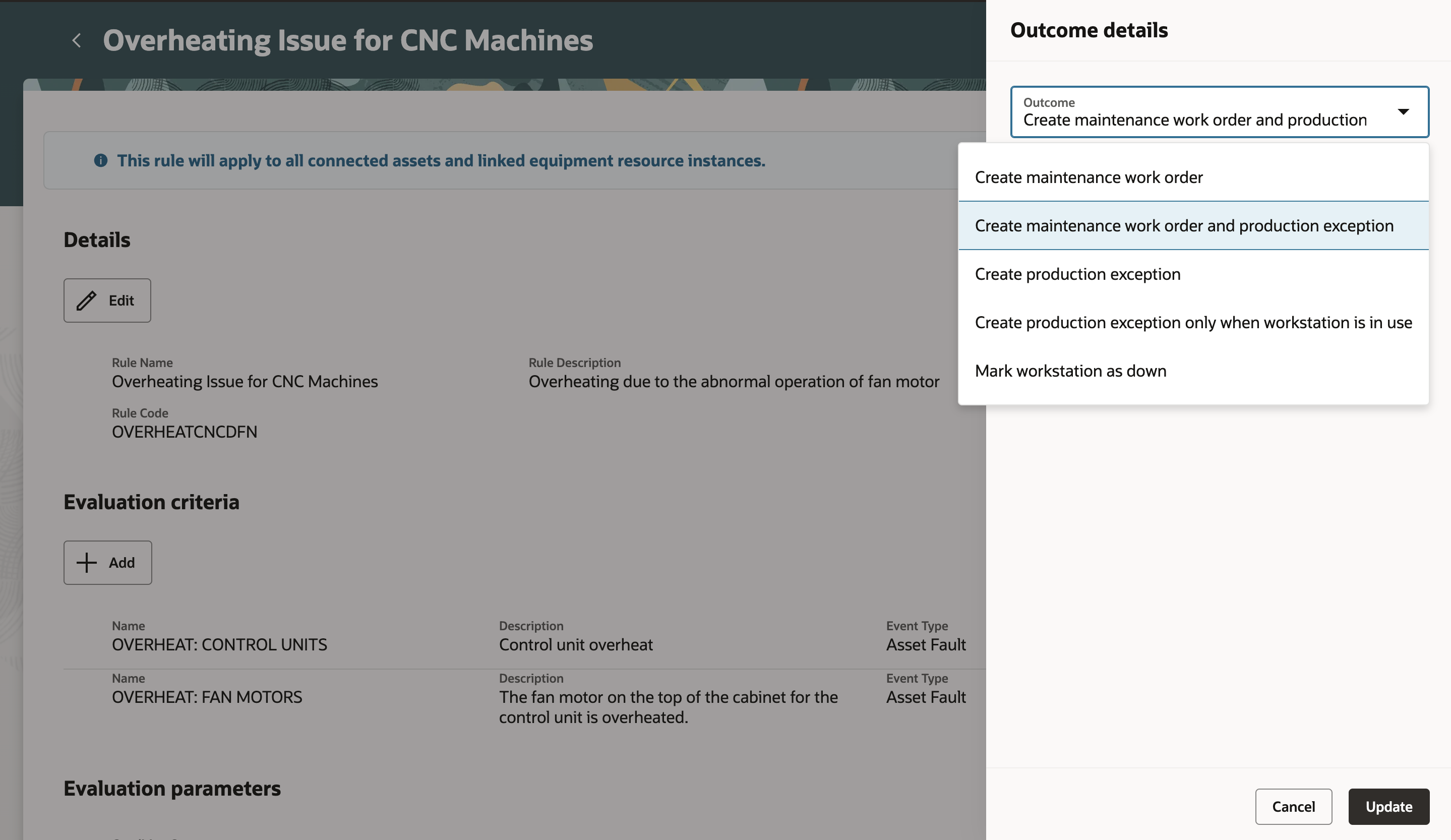

The Outcome section defines the actions that are executed upon successful evaluation of the evaluation criteria. For Maintenance use one of the first two options:
  • Create maintenance work order.
  • Create maintenance work order and production exception.
Outcome details panel
Outcome Details Drawer
