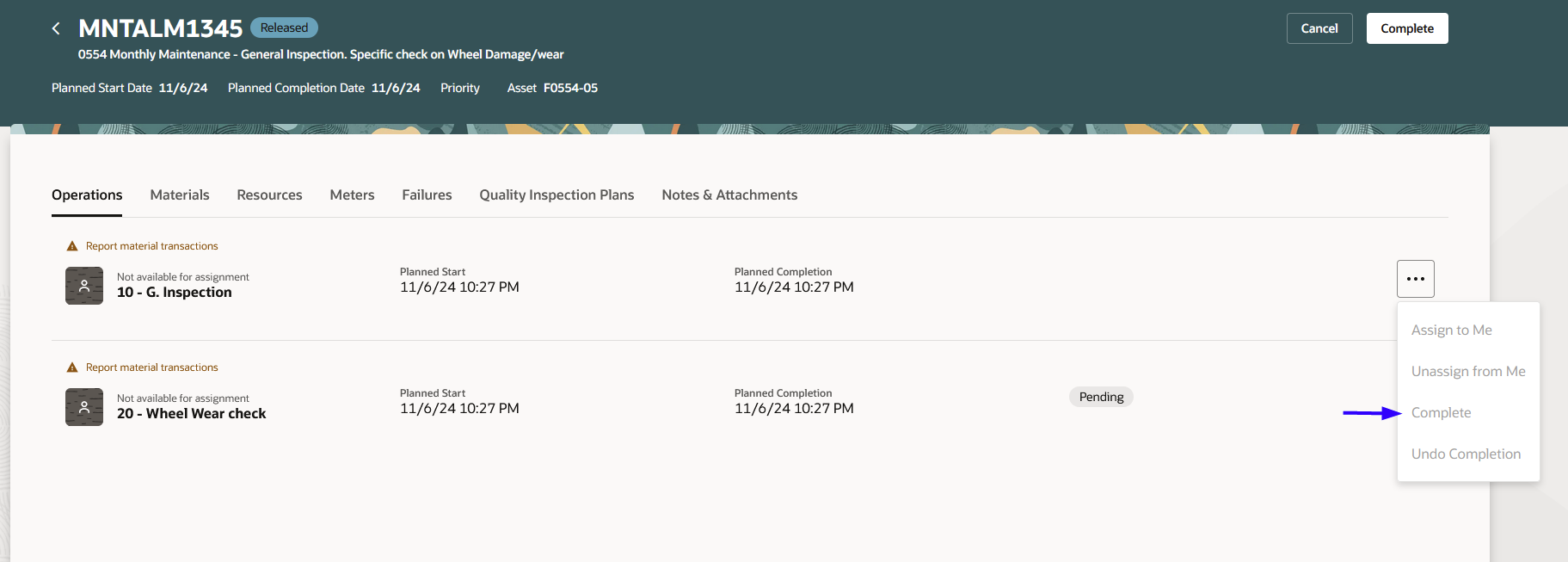

The following screenshot shows the Complete option for the operation disabled until the material transaction is completed:
Work Order Operation Tab
Work Order: Operations Tab

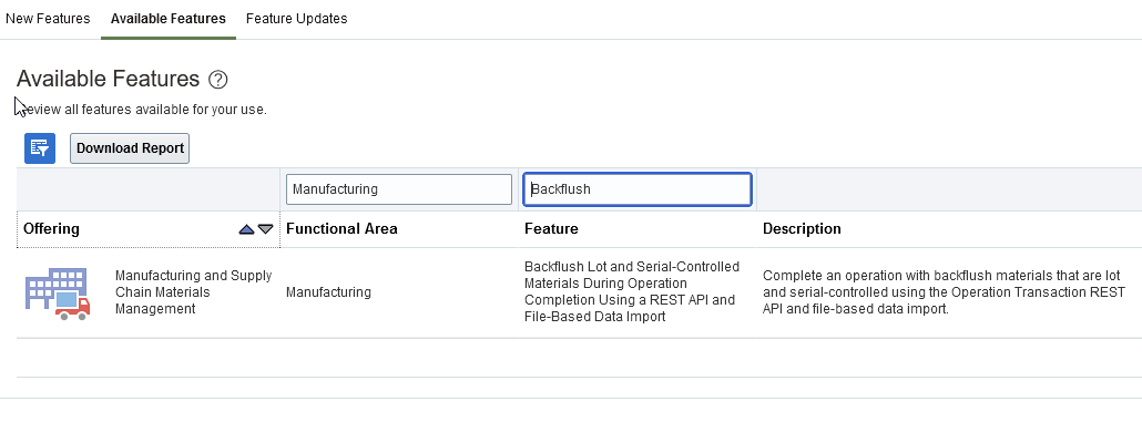

Steps to Enable
The manufacturing feature Backflush Lot and Serial-Controlled Materials During Operation Completion Using a REST API and File-Based Data Import must be enabled for this functionality to work.
Access Requirements
For this functionality to work, the Manufacturing feature Backflush Lot and Serial-Controlled Materials During Operation Completion Using a REST API and File-Based Data Import must be enabled.
Manufacturing Feature
