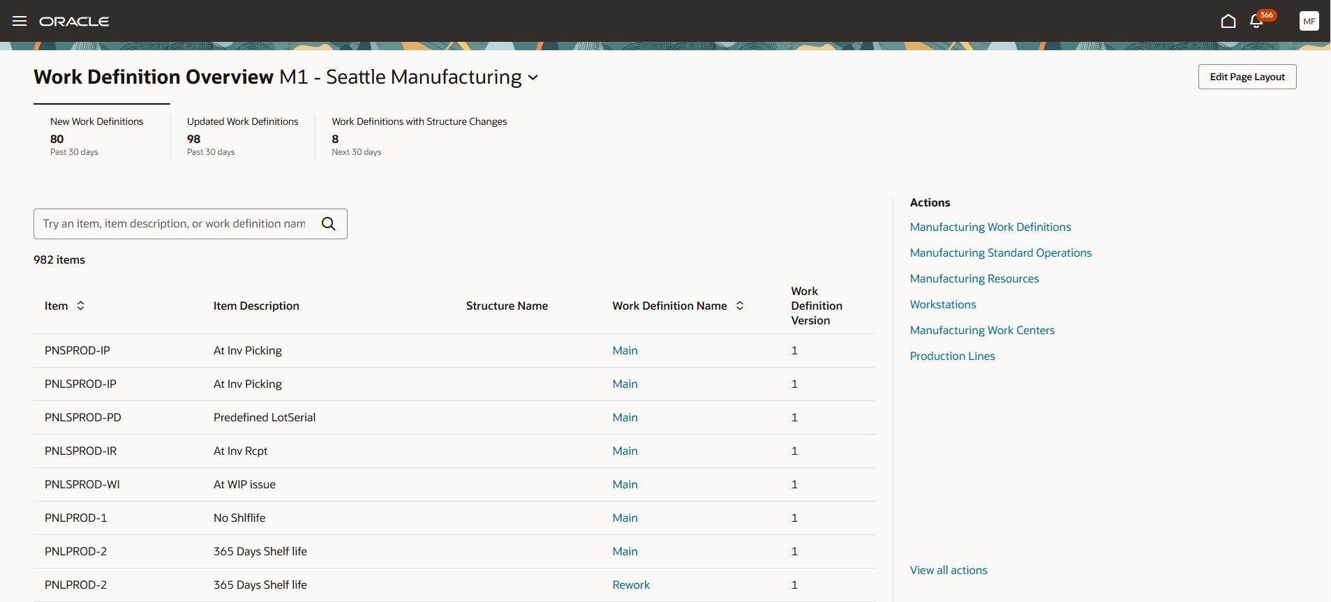

Manufacturing engineers need to understand and perform specific tasks that help design, develop, and optimize manufacturing processes, also known as work definitions for products. Now you can use the new Work Definition landing page for an overview of work definitions and highlighted work that needs attention, so you can take actions on them using an end-to-end Redwood user experience.
- Tasks with manufacturing plant context - View the work definition landing page for the default organization associated with the user. Take actions in the context of this organization. Select another organization to access its work definitions and actions as enabled by the user's organization access.
- Key performance indicators on work definition readiness - View a current summary of work definitions created or updated in the past 30 days or pending changes in the next 30 days.
- Direct search for a work definition - Search for a specific work definition based on keywords to quickly navigate to the work definition page for viewing or editing.
- Quick navigation to actions related to work definitions and plant setups - Navigate to commonly used actions and all actions available in the work definition work area. Pin additional actions to move them to the top of the list of all actions.
Work Definition Landing Page

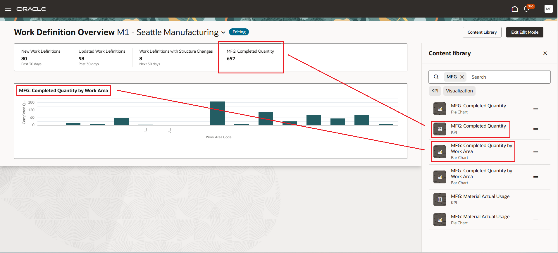

To add an OTBI-based KPI and visualization, click on Edit Page Layout. Drag the content of type KPI to the scoreboard region. Drag the corresponding visualization to the area below the scoreboard.
Add an OTBI-Based KPI and Visualization to the Landing Page
Manufacturing engineers can leverage a new work definition landing page experience that's optimized for productivity and faster performance, improving readiness for manufacturing execution.

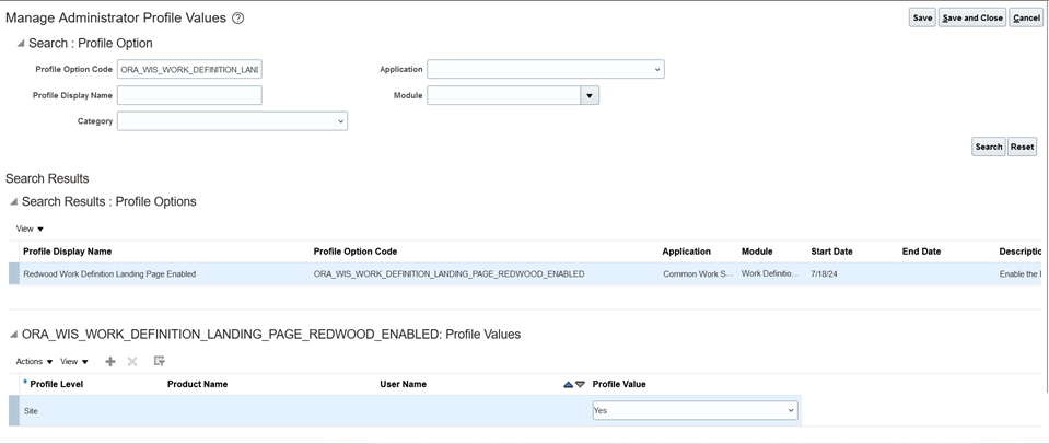

Steps to Enable
Follow these steps to enable or disable this feature:
- In the Setup and Maintenance work area, search for and select the Manage Administrator Profile Values task.
- On the Manage Administrator Profile Values page, search for and select the ORA_WIS_WORK_DEFINITION_LANDING_PAGE_REDWOOD_ENABLED profile option code.
- In the Profile Values section, set the Site level to Y or N. The default value of the profile option is N.
- Y = enables the feature
- N = disables the feature
- Click Save and Close. Changes in the profile value will affect users the next time they sign in.
You'll have the option to enable or disable this feature from 25A update.
Profile Option to Enable the Work Definition Landing Page in Redwood User Experience

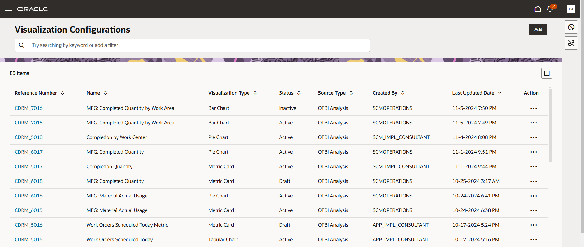

Creating a KPI and Visualization to Add to the Landing Page
You can define OTBI-based KPIs and visualizations using the Visualization Configurations tool. You must first create an analysis in OTBI. To create a KPI for the OTBI analysis, specify metric card as the visualization type. To create a visualization, specify bar chart, pie chart, tabular chart, and so on, as the visualization type. The Visualization Configurations tool can be accessed using the following URL:
https://<servername>/fscmUI/redwood/cx-analytics/application/container/dvconfig.
Create an OTBI-based KPI and Visualization in the Visualization Configurations Tool
