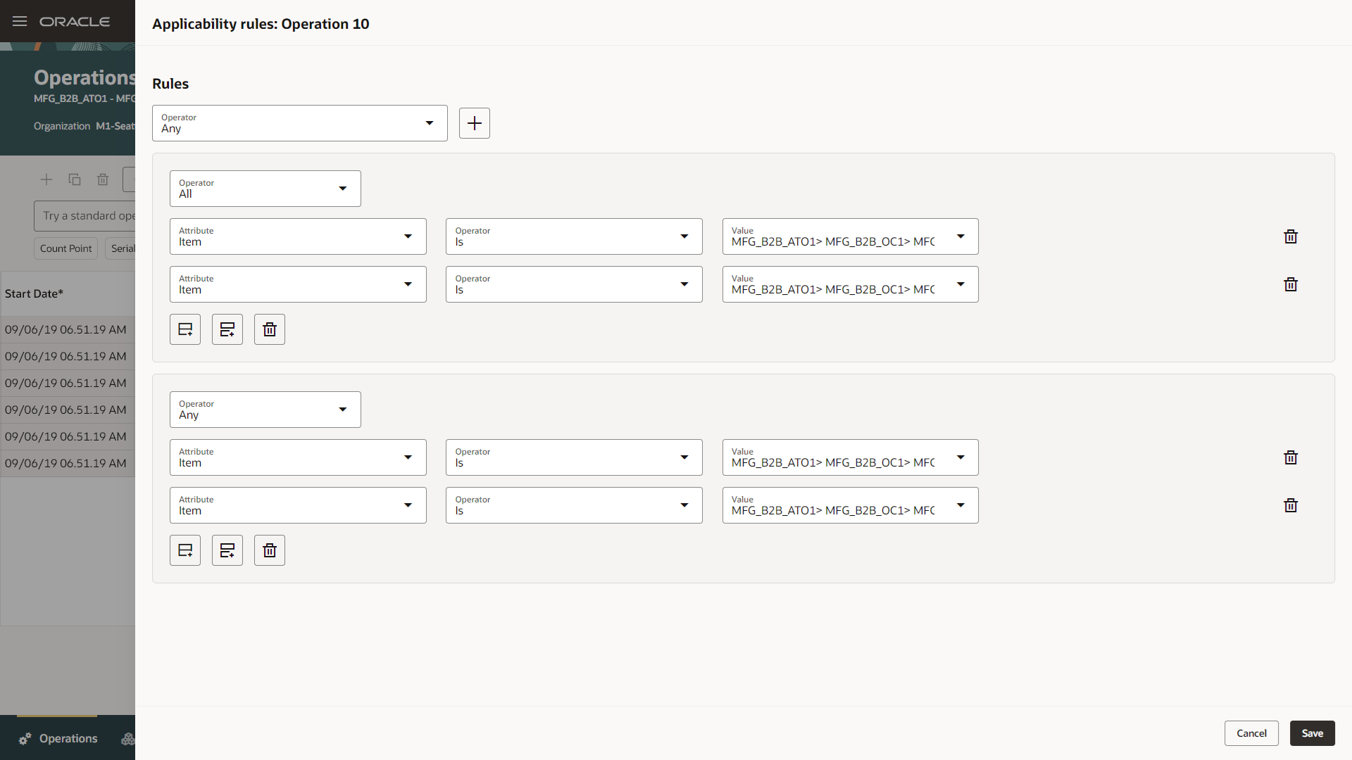

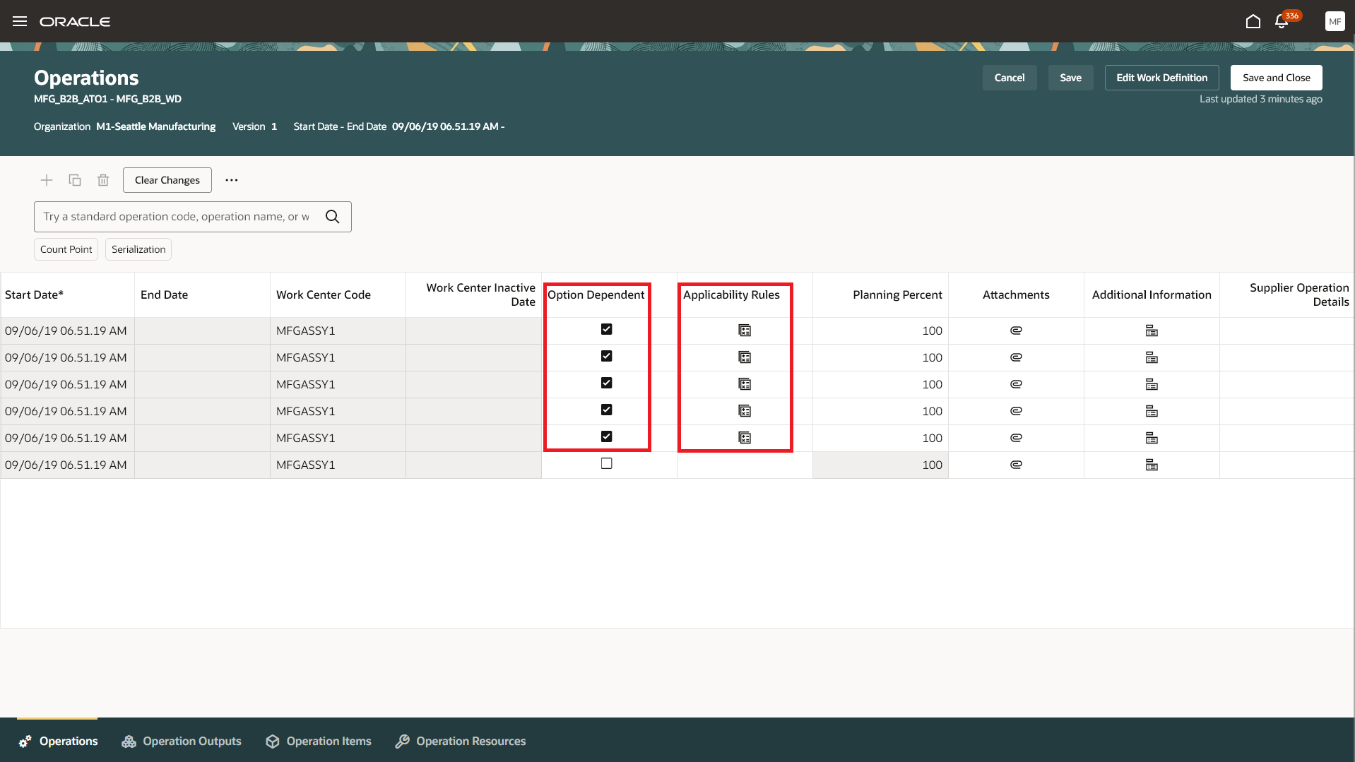

In a prior release, you could search for, create, and edit work definitions for Assemble to Order (ATO) model items using Redwood pages but couldn't access their applicability rules for option-dependent operations. An operational applicability rule defines the criteria to include an option-dependent operation in a configured item work order based on the selections made during the product configuration process.
Using the Redwood user experience, you can now augment ATO model work definitions and add a group of operation applicability rules based on the optional components selected from the multilevel ATO model item structure. For an option-dependent operation, you can create, edit, and delete applicability rules, which contain a set of conditions that apply to any combination of optional items from the structure. The list of items includes current and future effective option classes and options and show its component hierarchy relative to the top level ATO model item. These operation applicability rules are subsequently evaluated during the automatic creation of a configured item work order to dynamically generate the list of operations including mandatory and option-dependent operations.
Work Definition Operation with Applicability Rule link
Work Definition Operation with Applicability Rules Link
Applicability Rule for Work Definition Operation
Applicability Rules for Work Definition Operation
Operation applicability rules for option-dependent operations allow manufacturers the flexibility to adapt their production processes to make configured products.
