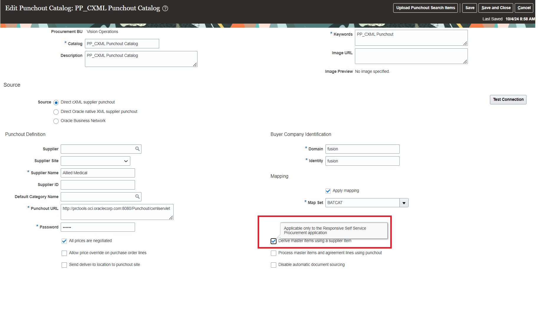

- The Derive master items using a supplier item option is enabled in the Punchout Catalog definition.
If a unique item can be found with an active supplier - supplier item trading partner relationship, then the requisition line will be created using the master item.
Derive Master Item Using a Supplier Item Option in the Punchout Definition

Manage Procurement Catalog Content (POR_MANAGE_PROCUREMENT_CATALOG_CONTENT_PRIV) to enable the check box "Derive master items using a supplier item".
