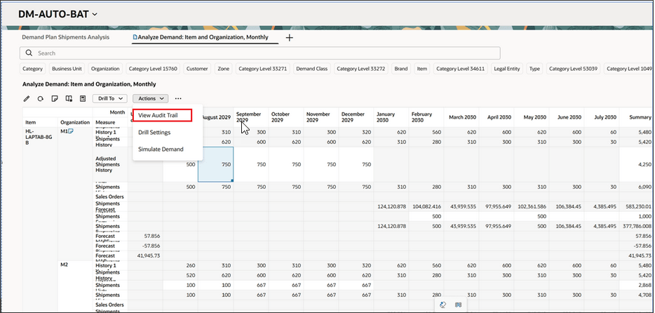

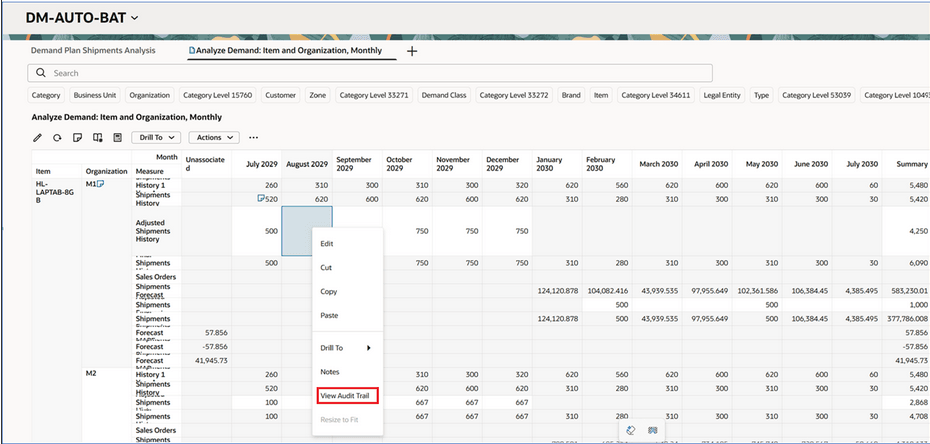

You can view the audit trail on an editable cell by selecting it in the table and doing the following:
- Right-click the cell, and select View Audit Trail.
- In the Actions menu, click View Audit Trail.

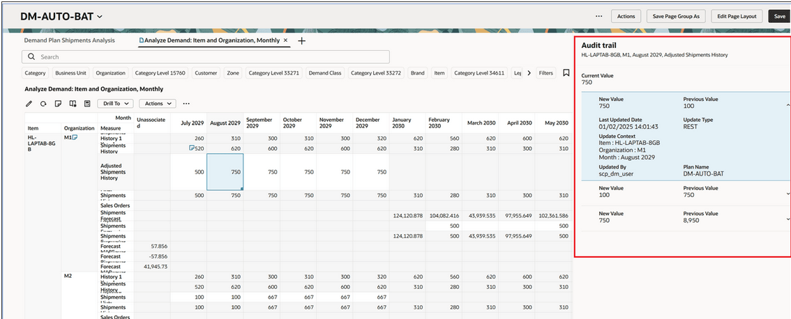

The Audit trail is opened in a drawer, and you can view the history of changes to the measure value of the cell. Remember that the audit trail displays the value that was updated directly in the selected cell in the table or the value that was updated in another table with a higher or lower data aggregation. This drawer provides a quick and easy way to track audit changes.
Audit Trail Drawer
NOTE: The Update Context field shows the context of the cell where the update was made along with any table and member filters. The page-level search and applied filters aren’t captured in the audit trail.
