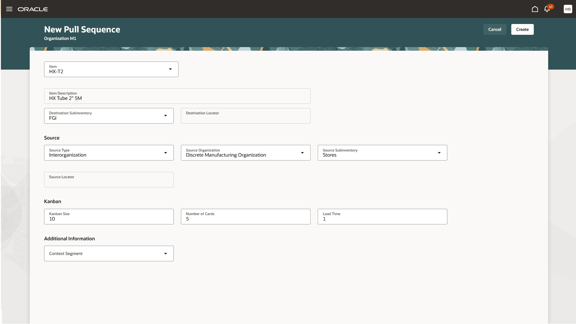

For an inter-organization kanban, you can create a pull sequence that specifies the source organization, subinventory, and locator in addition to the destination organization, subinvenory, and locator. You can then generate and print inter-organization kanban cards accordingly. When a warehouse operator scans an empty kanban card to send the replenishment signal, Oracle Fusion Supply Chain Orchestration automatically generates an approved transfer order for the supply requested between the source and destination, as specified for the item and pull sequence. As an inventory manager, you can see the kanban card supply status as In Process, and track the card activity with the transfer order and line information. The kanban card supply status automatically updates to "In Transit" once the material is shipped from the source organization, and updates again to "Full" once the material is received and put into the destination organization.
Pull Sequence Definition for source type as Interorganization
Pull Sequence Definition for Source Type as Interorganization

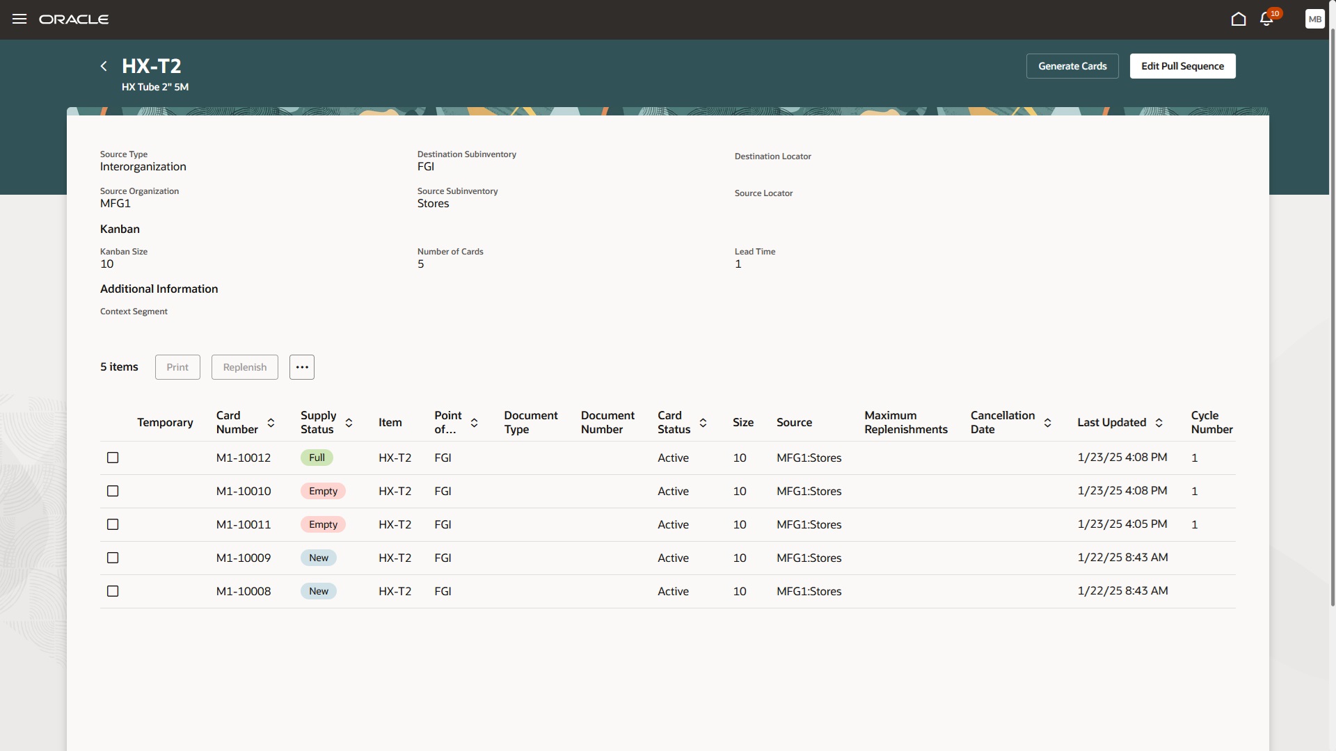

Kanban cards genearted for pull sequence of source type interorganization
Kanban Cards Generated for Pull Sequence of Source Type Interorganization

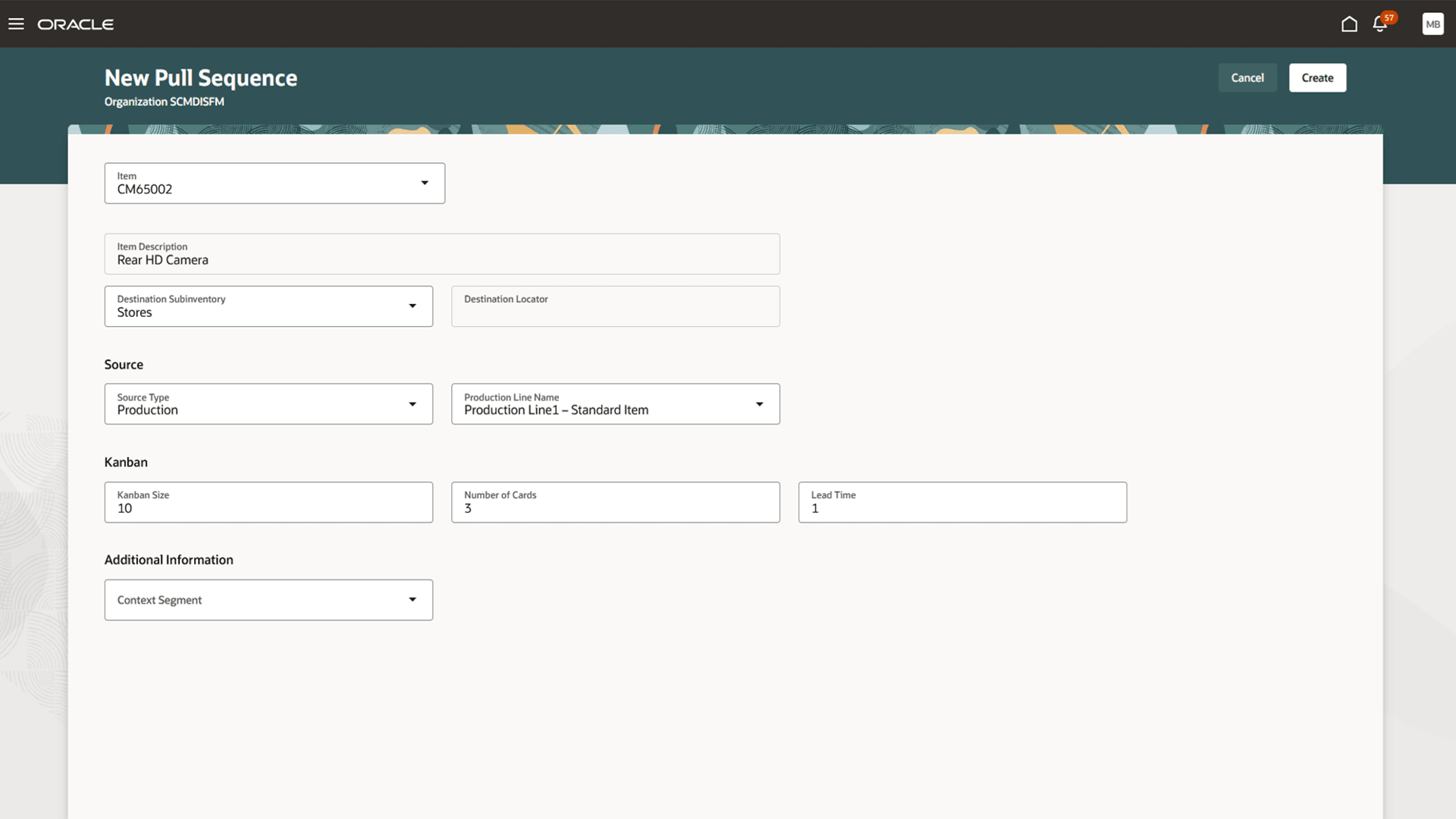

For a production kanban, you can create a pull sequence that specifies the source production line in addition to the destination subinventory and locator. You can then generate and print the corresponding production kanban cards. The execution of a kanban card automatically signals the replenishment process to generate supply by creating a flow schedule based on the corresponding work definition associated with the specified production line, or a discrete or process manufacturing work order based on the corresponding work definition with the lowest production priority. The released and completed statuses of the flow schedule or work order automatically synchronize with the "In Process" and "Full" supply status of the kanban card, respectively.
Pull Sequence Definition for source type as Production
Pull Sequence Definition with Source Type as Production
