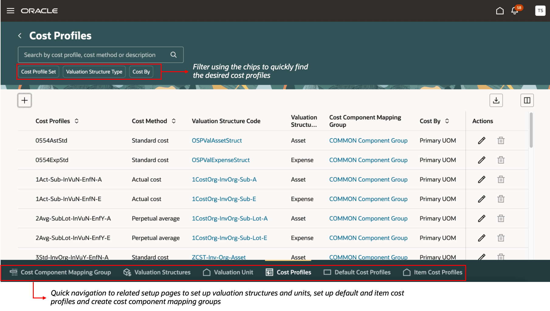

The Cost Profiles page displays all the cost profiles that you have access to, sorted by last updated date in the descending order, by default. You can search for the cost profiles and filter the results based on your requirements. The available filters are:
  • Cost Profile Set
  • Valuation Structure Type
  • Cost By
  • Cost Component Mapping Group (on selection of cost profile set)
  • Valuation Structure Code (on selection of valuation structure type)
You can modify and delete existing cost profiles. Using the navigation links at the bottom of the page, you can quickly access other related setup pages.
Figure 1: Cost Profiles Page
Cost Profiles Page

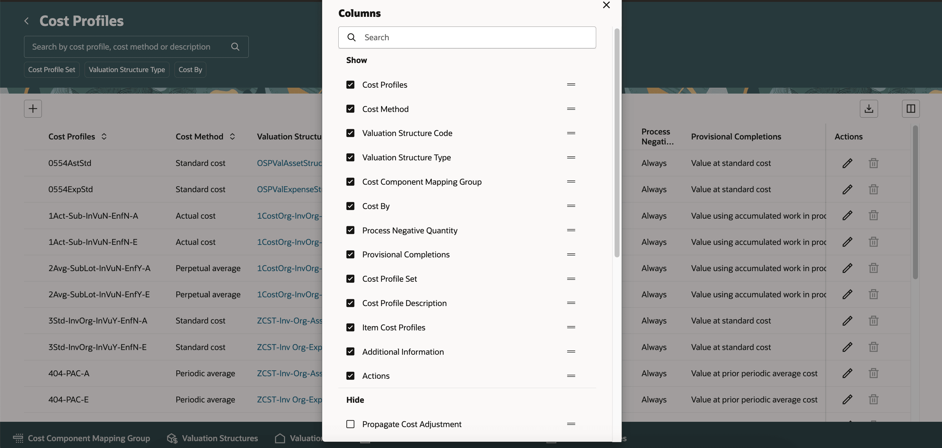

You can now rearrange and hide the available columns based on your preferences and requirements.
Figure 2: Rearrange and Hide Cost Profile Columns

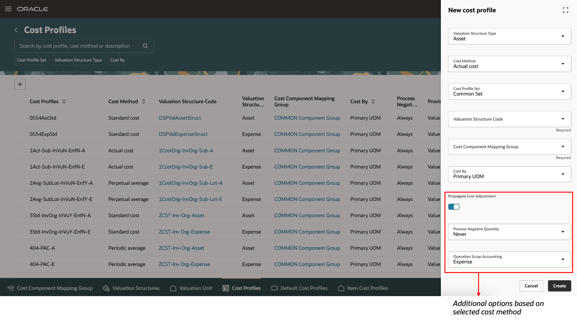

Create New Cost Profile
Click the Add (+) button to create a cost profile. The basic details like valuation structure, cost method, and cost profile set have default values that streamline the cost profile creation process. Options like negative quantity processing are auto-selected based on the cost method. After entering basic details, you can add additional specifications on the next screen, where most fields have a default value. You can easily navigate between sections to create and adjust transaction costing and work order valuation rules as needed.
Figure 3: New Cost Profile Basic Details

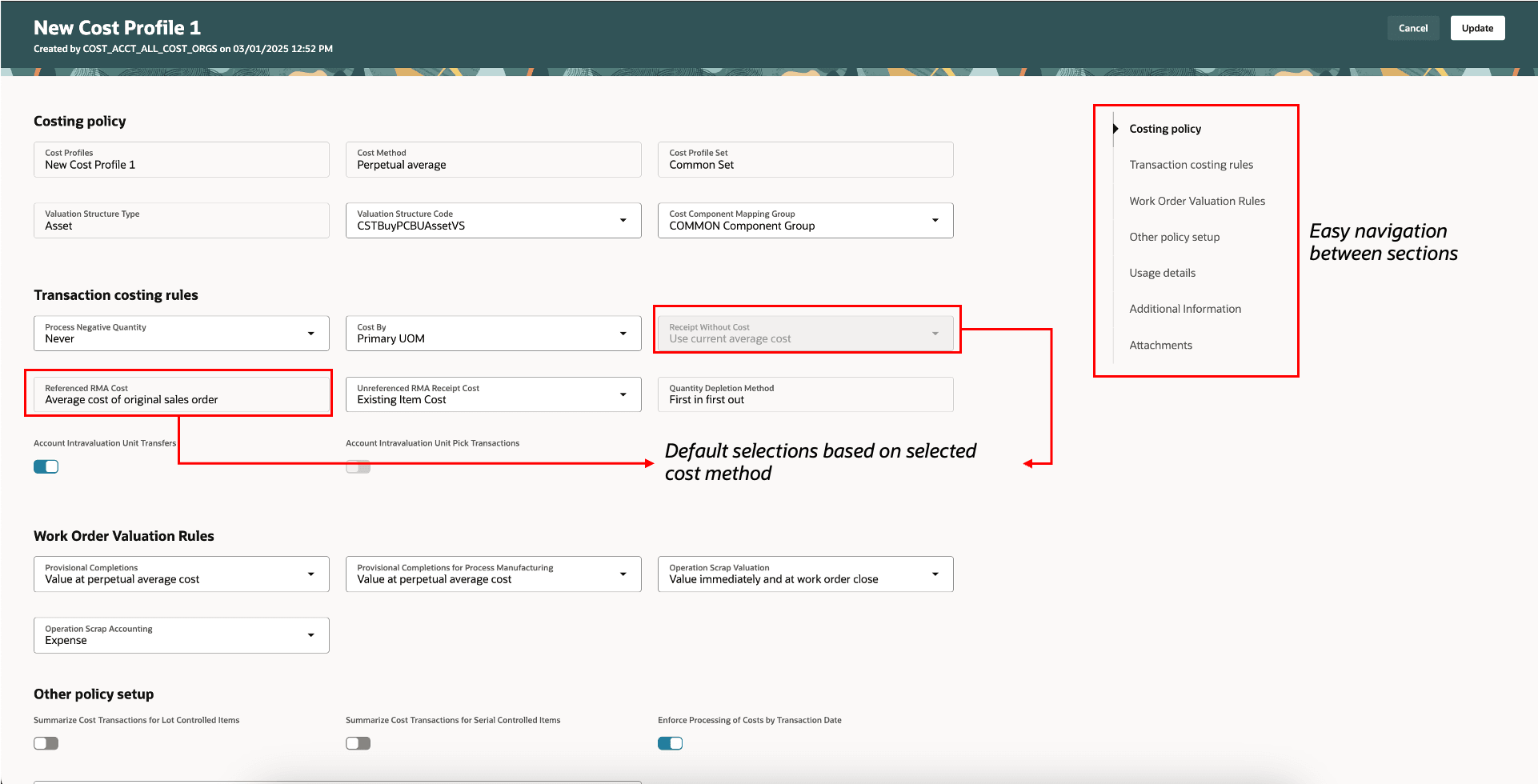

Figure 4: New Cost Profile Additional Details
Some of the benefits of this feature include:
  • Intelligent defaulting of recommended cost policies based on the cost method and valuation structure granularity chosen.
  • Better organization of the costing policies for more focused and easier management.
  • A central place for defining all your item costing and accounting rules.
