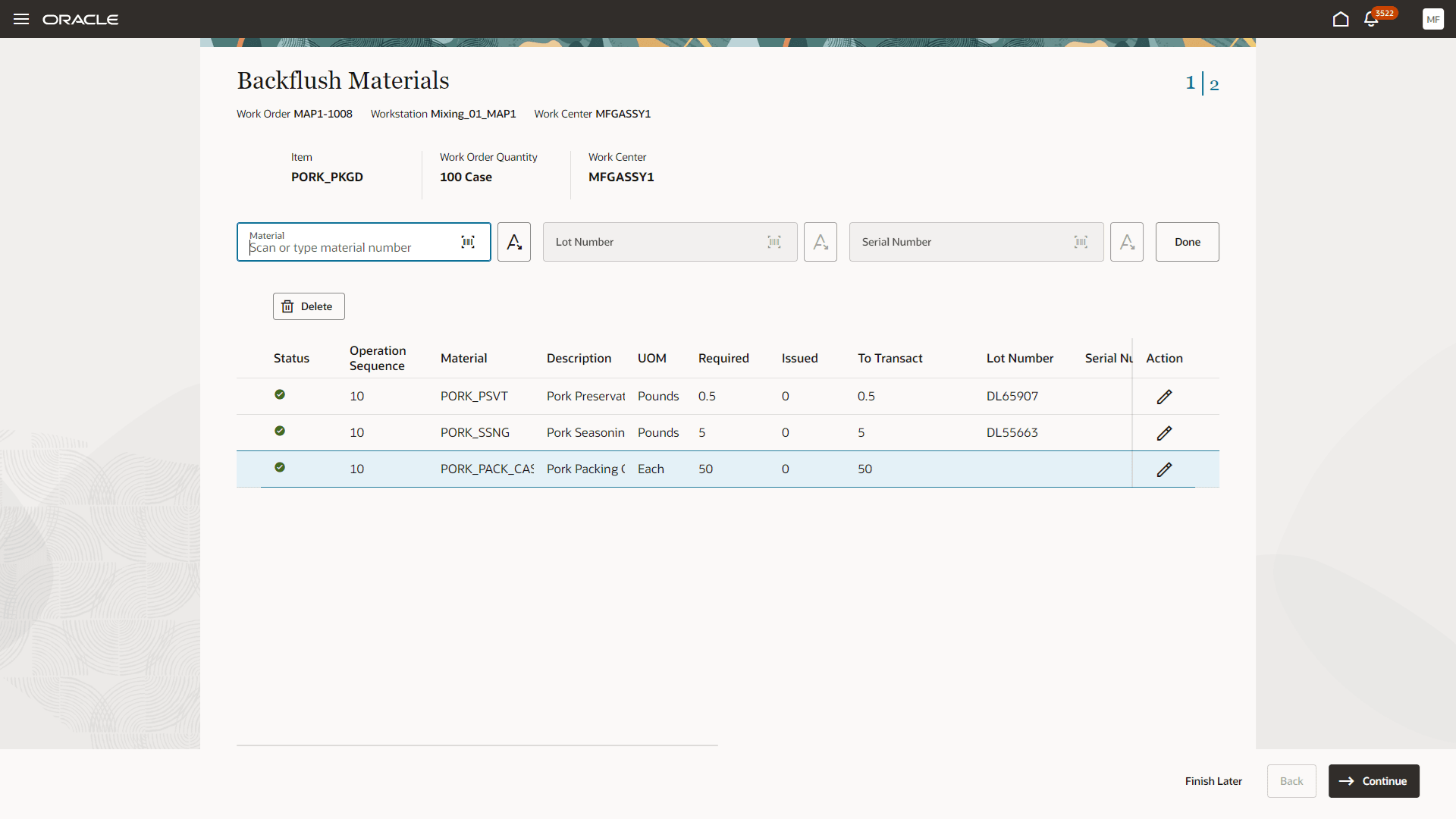

- Issue materials corresponding to primary products or co-products for an operation.

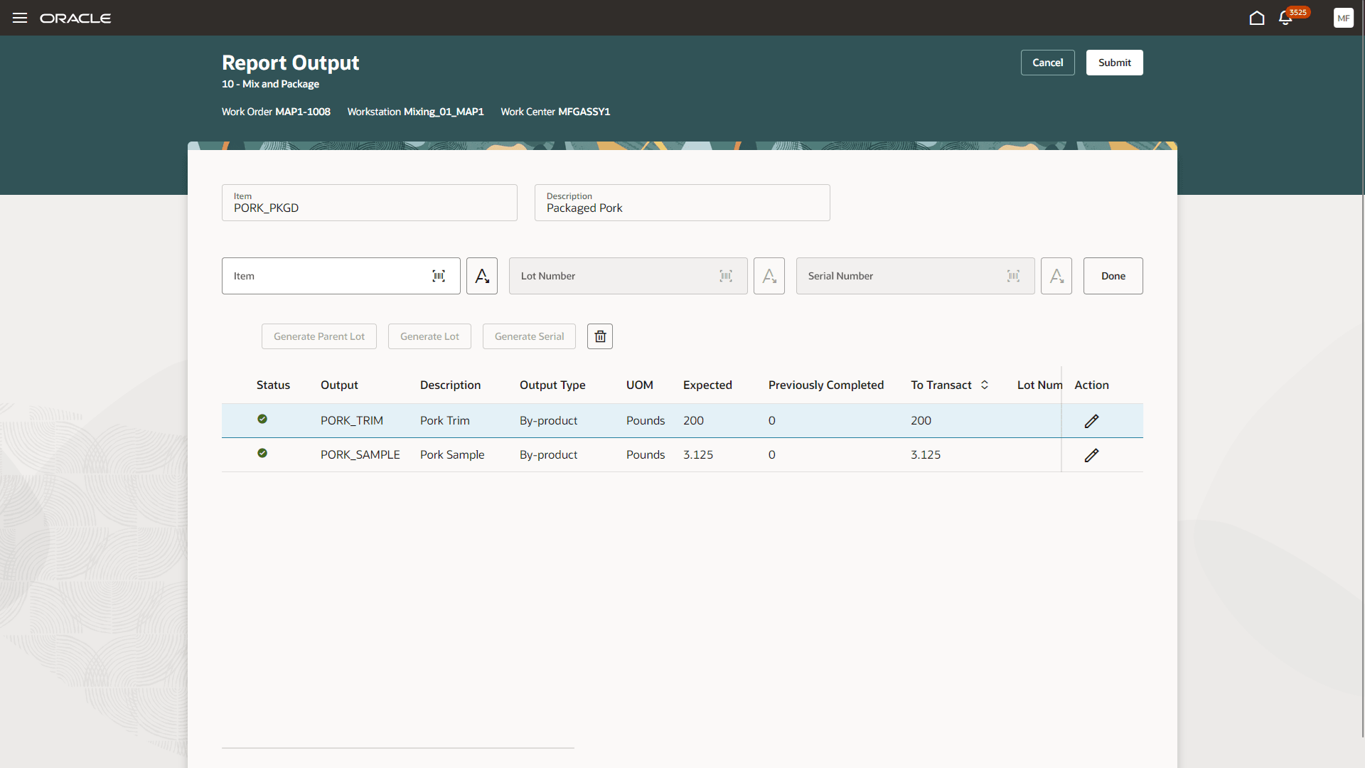

- Report ad hoc outputs for any operation during completion.

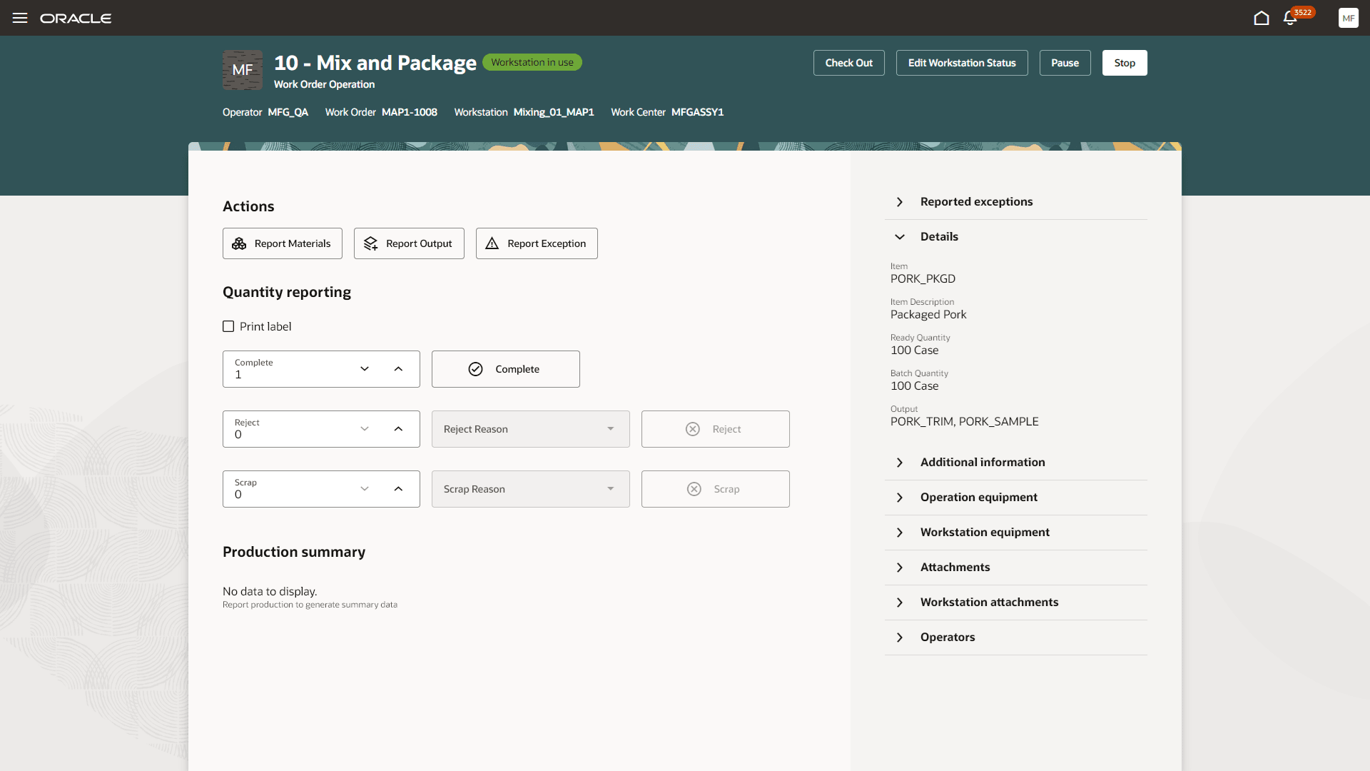

A Process Manufacturing Work Order Ready to be Worked Upon at the Workstation
Report Output for a Process Manufacturing Work Order
Issue Materials for a Process Manufacturing Work Order
Perform real-time work execution for the process manufacturing work method through a single user interface that provides a smooth and intuitive digital experience. Operators can focus on their manufacturing tasks with convenient access to all the information required to efficiently perform these tasks.

- When a process work order is released, the batch quantity of the process work order is shown as the Ready quantity for the first count point operation.
- Quantity Reporting for a process work order (Complete, Reject or Scrap) updates the work order operation quantities for the process work order.
- The Minimum Transfer Quantity mentioned in the work definition is defaulted as 'Complete' in Quantity Reporting.
