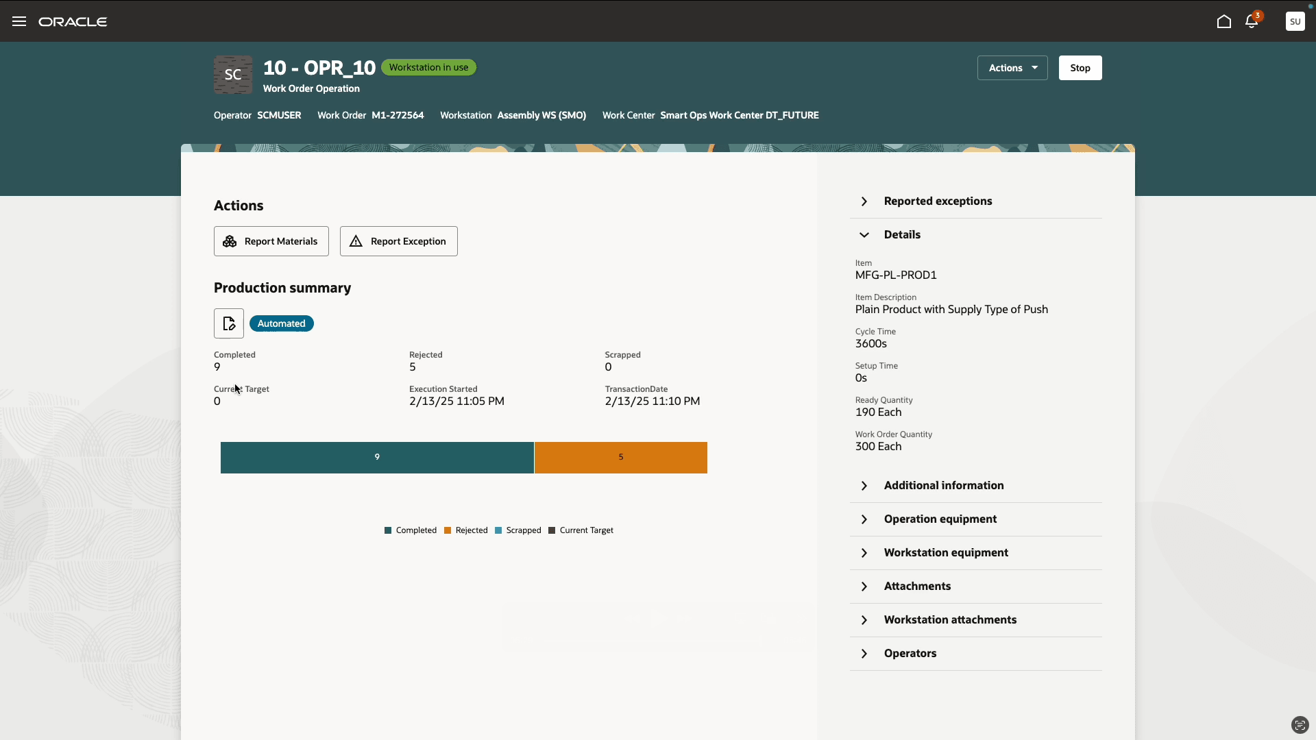

View Connected Equipment's Execution Progress

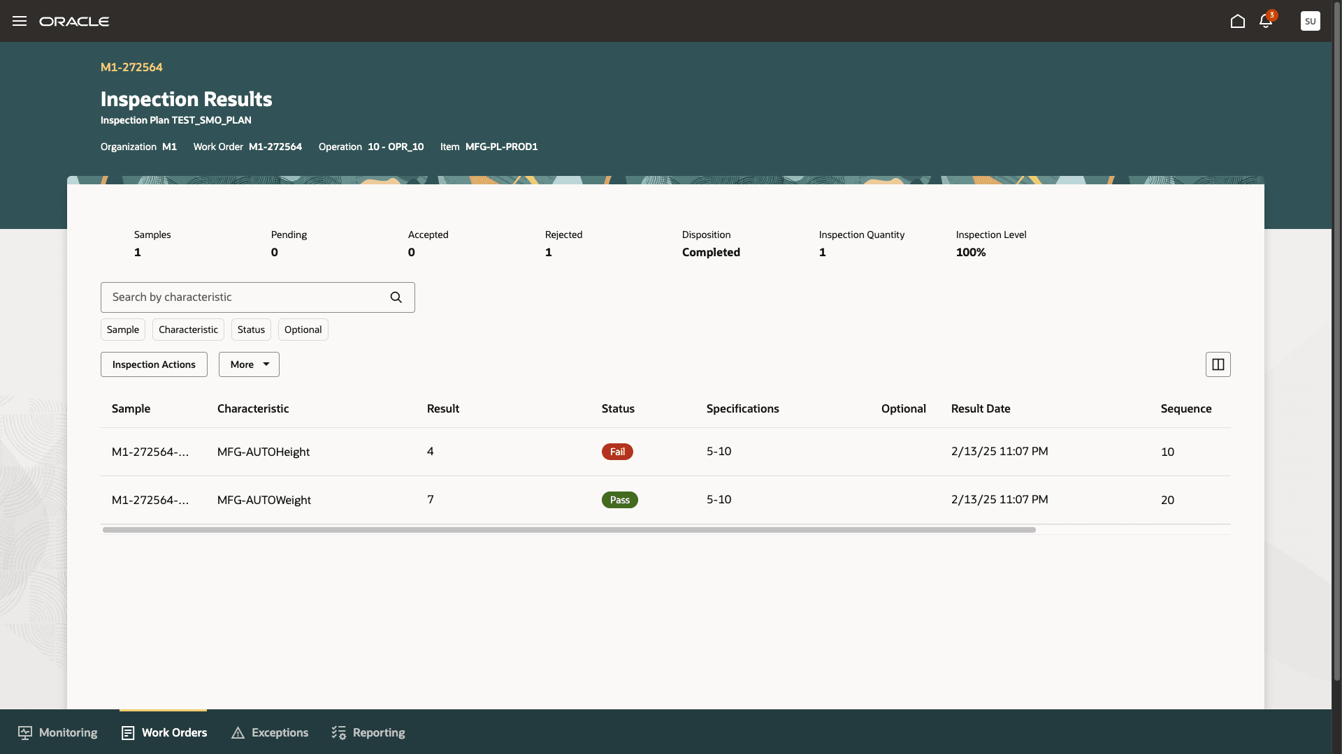

Send Equipment Sensor Data as Quality Inspection Characteristics Results
Manufacturers can record accurate information, improve operator productivity, and maintain contextual data for items on the floor.
Manufacturers can also use the collected sensor data to perform analytics that helps with continuous improvements in the processes.
