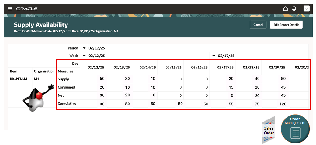

Use a redesigned page to display the total, consumed, net, and cumulative supply for an item across more than one organization, work area, work center, resource, or supplier site over time.
You can review the supply for an item across your supply chain to determine the amount of supply that’s available for each item organization and to diagnose delay.
Before this update, you could review supply availability only on the classic pages. Now you can review them on the redesigned pages too.
Try it:
  1. Go Home > Order Management > Show More > ctrl+f > Supply Availability.
  2. Select your item, then examine the results:
    Supply Availability page
    Note
  • The Supply Availability page displays the supply that's currently available for each item organization.
  • You can expand or collapse the period or week.
  • You can also access the Supply Availability page through a sales order. Open your order line on a redesigned page in the Order Management work area, click More Actions > Check Availability, and then click More Actions > Review Supply Availability.
  • For details about the measures, read See What Supply is Available and Allocated.
