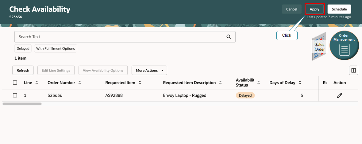

Use a redesigned page to modify the item and fulfillment options on an order line that's in draft status, and then check availability without scheduling the line. You can then make more changes to the item, ship-from organization, ship method, and other details to improve results before you commit supply.
Visualize the most acceptable simulation results in the Order Management work area without actually scheduling the draft order.
Make your modifications, then click the new Apply action on the Check Availability page:
Note
  • The action will return the final simulation results to Oracle Order Management without scheduling in Oracle Global Order Promising.
  • The results can include modifications that you make to various attributes and other changes, such as ship-from organization, shipping method, splits, and so on.
  • Click Submit on the sales order in the Order Management work area to submit your changes to fulfillment.
  • For details about how to access and use this page, see Redwood: Check Availability.
