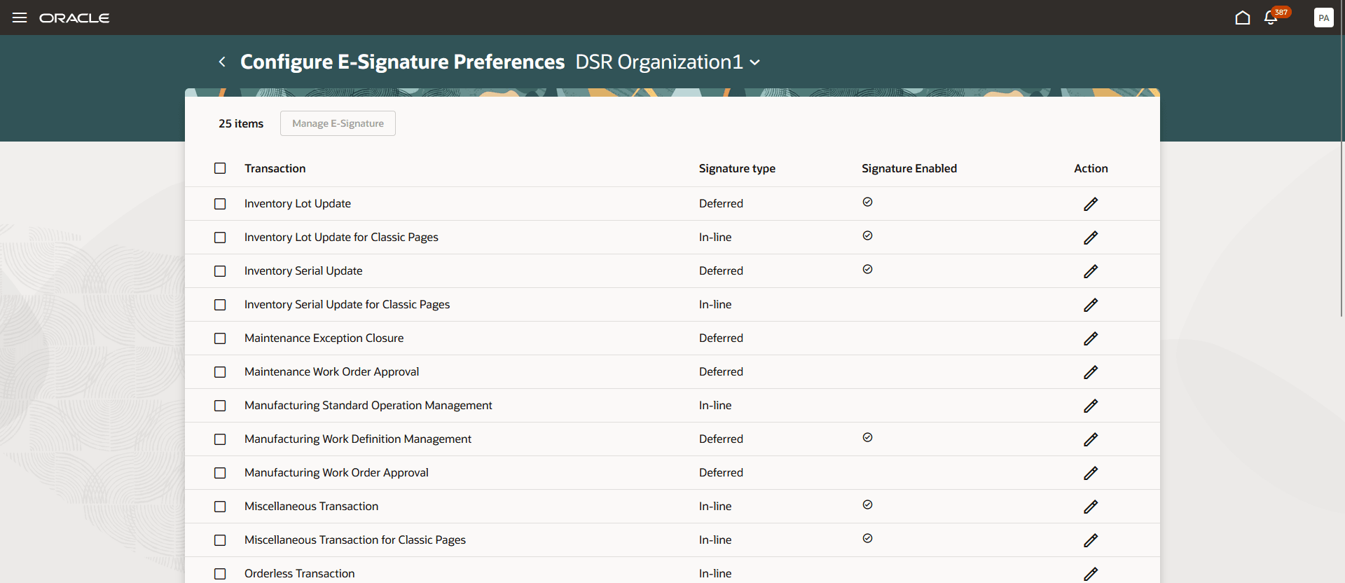

Configure E-Signature Preferences
You can use the Configure E-Signature Preferences page to enable e-signatures for your organization. This setup page now allows organizations to enable the e-signature functionality for the seven Redwood Inventory transactions. Once the e-signatures are enabled, these transactions must be approved before they can be processed.

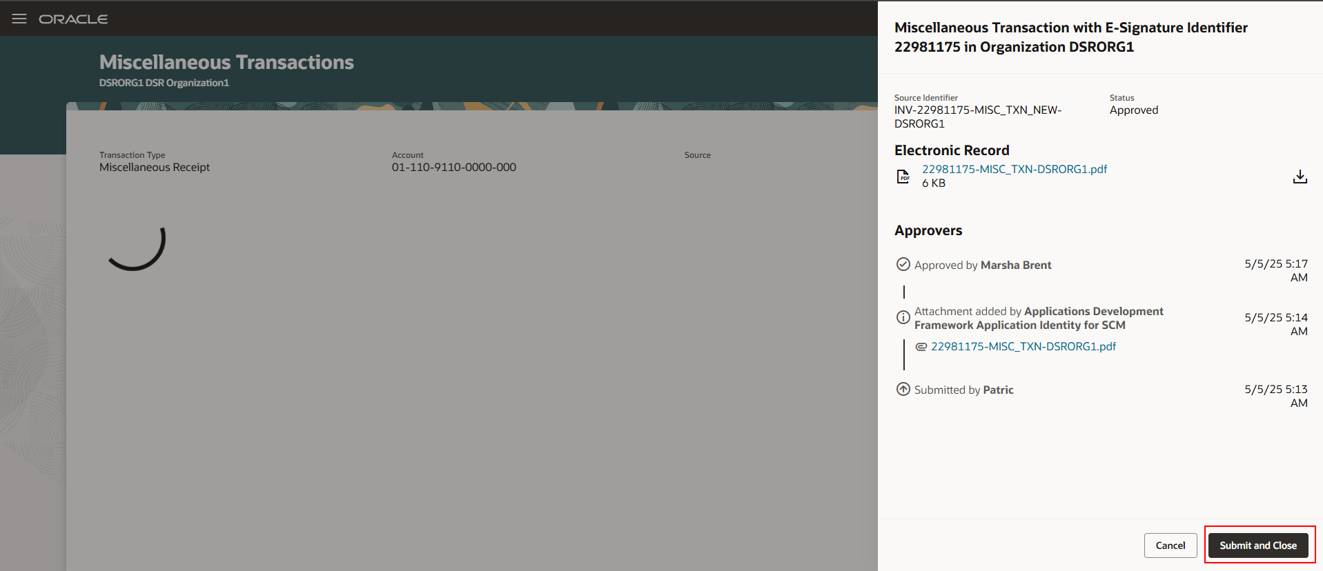

1.  In-line Mode Transactions: When an organization is configured to use e-Signature with the In-line signature type, the transaction approval flow proceeds as follows:
Submission Flow
The primary action button on the transaction page is relabeled to Submit for Approval.
Submit for Approval
Submit for Approval

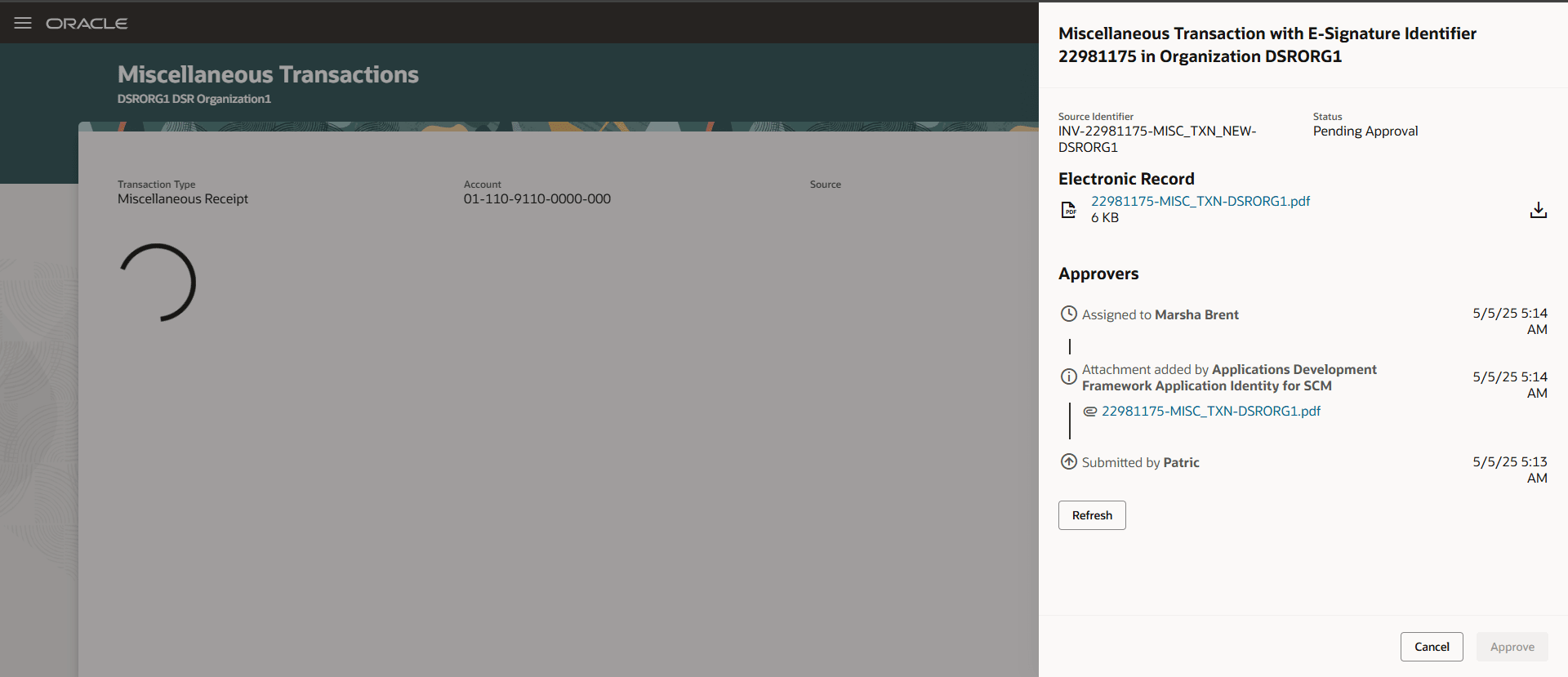

When a user clicks Submit for Approval, a panel drawer appears. This panel drawer displays detailed information related to the transaction, including:
  • E-Signature details
  • Source Identifier
  • A preview or link to the Electronic PDF Record
  • Approver list and their current status
  • Other supporting transaction information
In-line Panel Drawer
Approval Processing
The system sends an approval notification to the designated approvers. The user initiating the transaction can click Refresh on the panel drawer to update and view the latest status of the approval workflow in real time.
Once all required approvers have completed their approvals:
  • The Submit and Close button will be enabled.
  • Click Submit and Close to:
    • Commit the transaction to the system.
    • Display a message confirming successful completion.
Submit and Close
Submit and Close

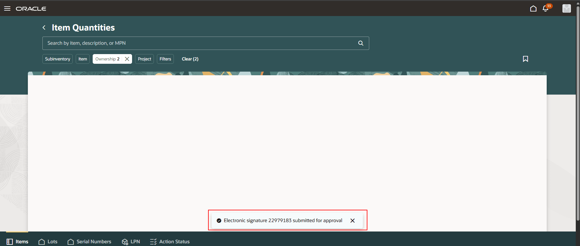

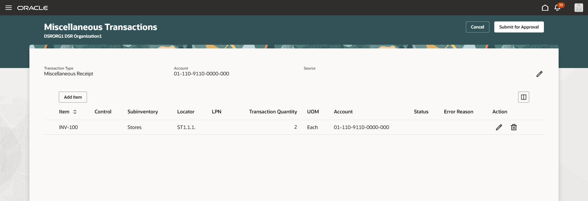

2.  Deferred Mode Transaction: When the signature type is configured as Deferred, the behavior differs in the following ways:
Submission Flow
  • The main action button is labeled Submit for Approval.
  • Upon clicking this button:
    • A toast notification appears displaying the e-signature ID generated for the transaction.
    • This ID can be referenced for tracking or audit purposes.
Deferred Mode Toast Message

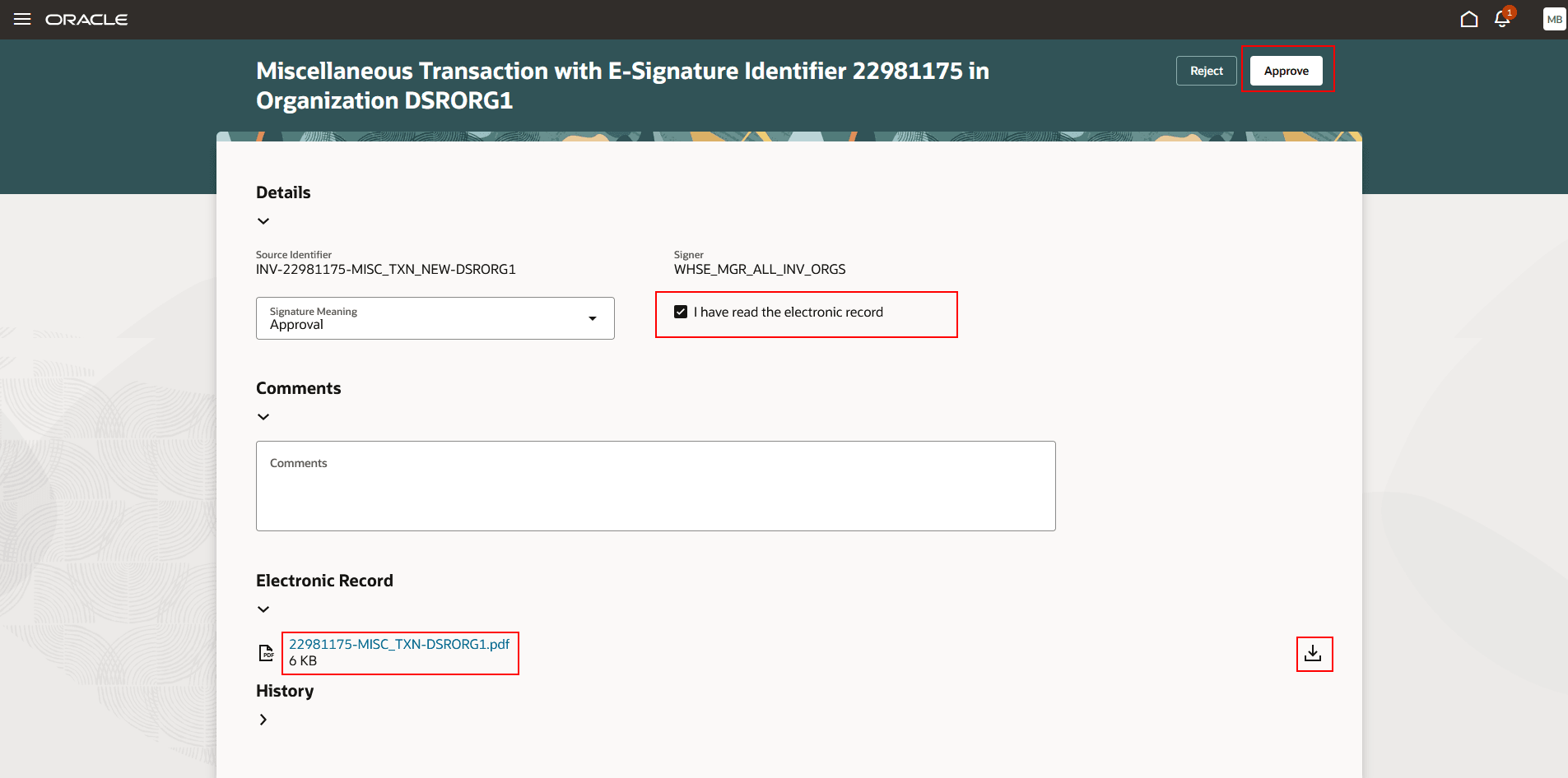

3.  Approval Notifications and Actions: Approvers can access pending approval requests through their worklist. When an approval request is opened, the following information is displayed:
  • Source Identifier
Available Actions: Approvers can choose to Approve or Reject the request directly from this interface. Their action updates the system status accordingly and triggers downstream workflows.
Approver Notification

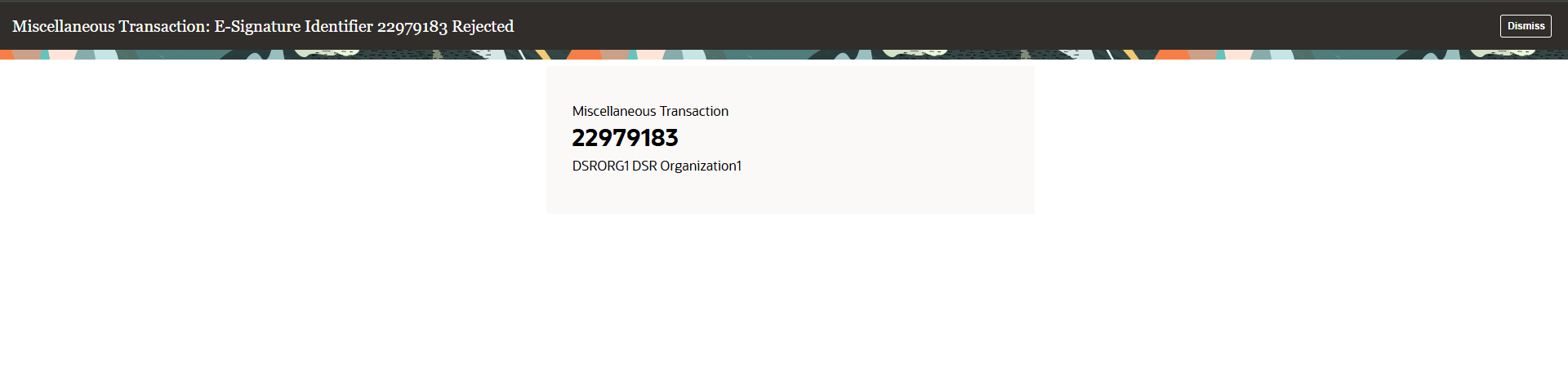

Reject Action by Initiator: In scenarios where the initiator is also an approver, the initiator has the option to:
  • Click the Reject button if they do not approve of the transaction. This results in the electronic record being updated with a Rejected status.
  • No further approvals will be processed after a rejection.

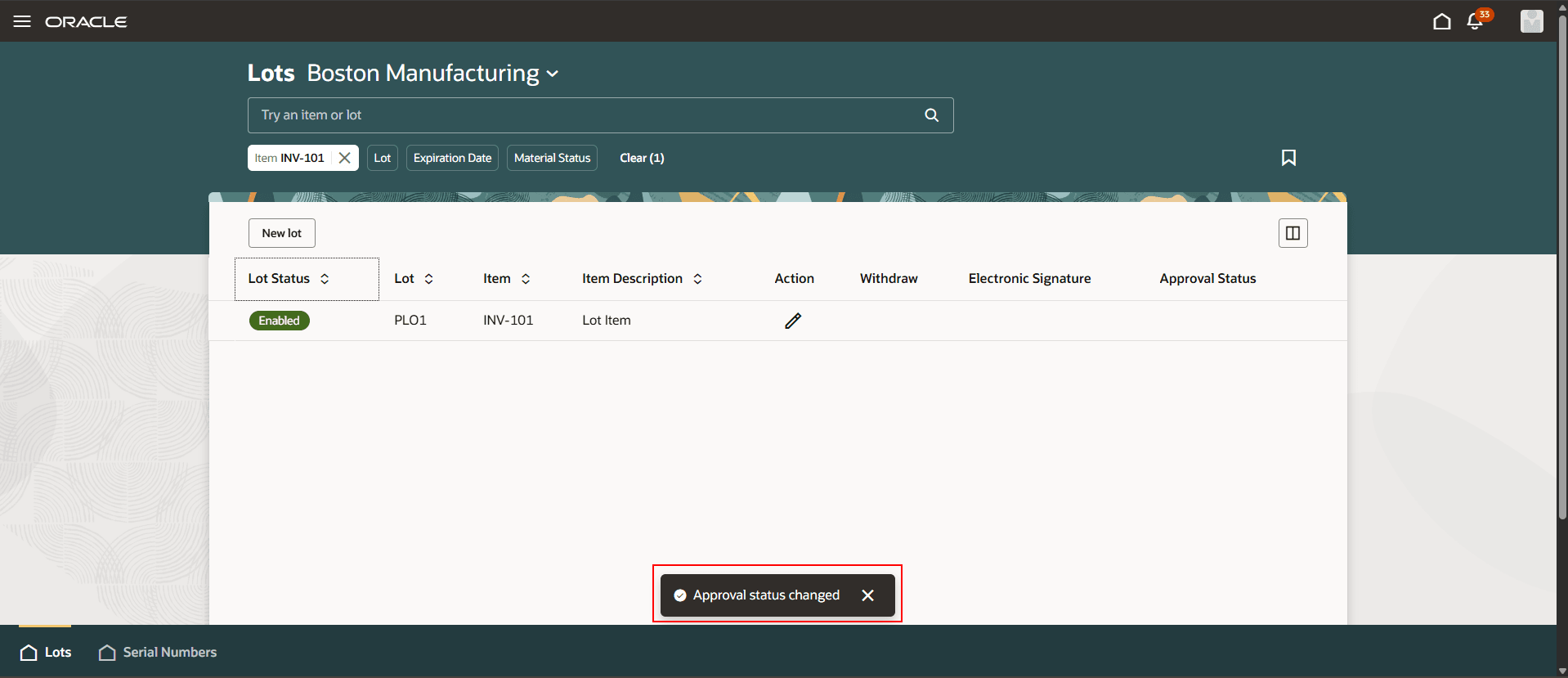

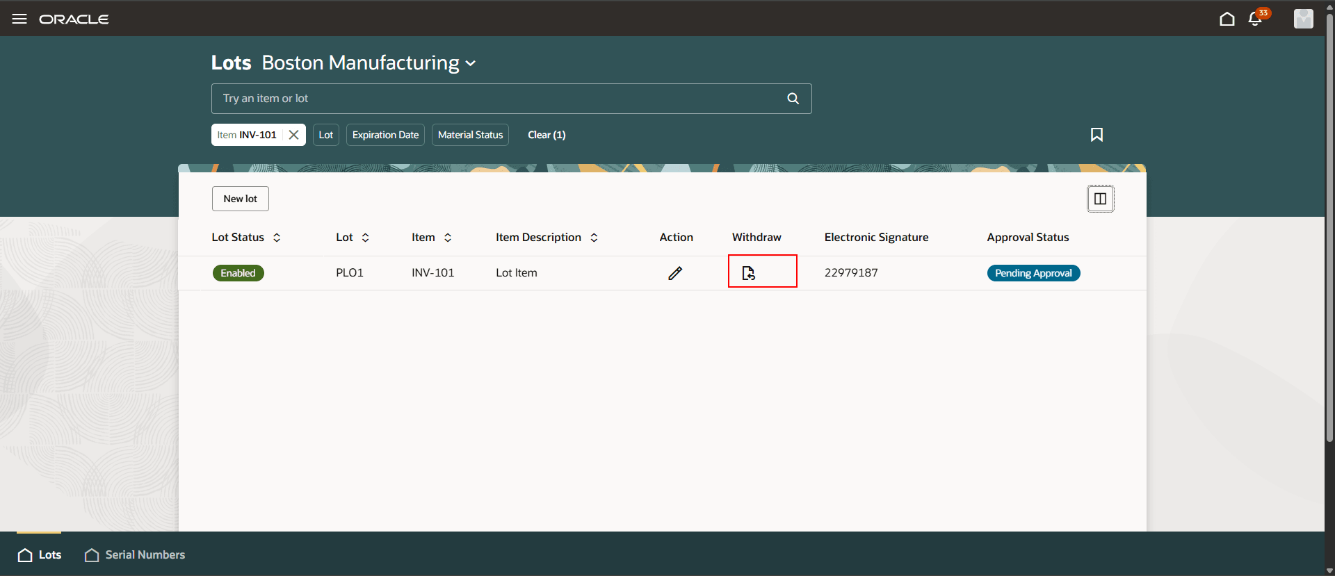

5.  Withdraw Action (Deferred Mode Only):
The withdraw action is supported for specific flows when operating under Deferred signature mode:
  • Inventory Lot Update
  • Inventory Serial Update
  • Ship Confirm
Conditions and Usage
  • If a transaction is in Pending Approval status, only a privileged user has the authority to withdraw the approval request
  • This is useful when:
    • The transaction requires modification before resubmission.
    • The approval process is stuck or experiencing long delays.
Withdraw Action
Withdraw Action
Behavior
  • Once submitted, such transactions:
    • Are still viewable in read-only mode.
    • Are locked and cannot be edited until withdrawn.
  • Upon performing the Withdraw Action:
    • The transaction Approval Status is reset and a toast message confirms this.
    • The transaction is editable again and can be resubmitted for approval if required.
Approval Status Reset

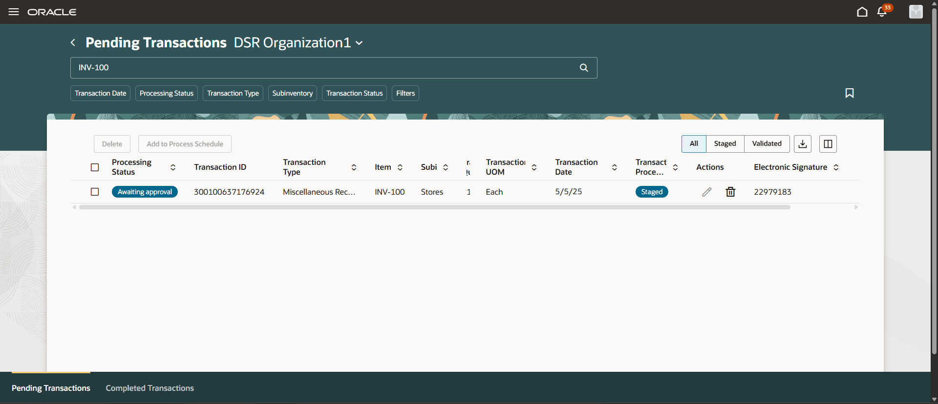

6.  Pending Transactions Page: The Pending Transactions Page is used to track Deferred Miscellaneous Transactions.
Features and Behavior
  • Users can view all the miscellaneous transactions that have been submitted with Deferred signature mode.These transactions will be of processing status Awaiting Approval.
  • Transactions on this page:
    • Are non editable.
    • Can be deleted if no longer needed
      • Deletion cancels the transaction.
      • Any pending approver actions are also nullified.

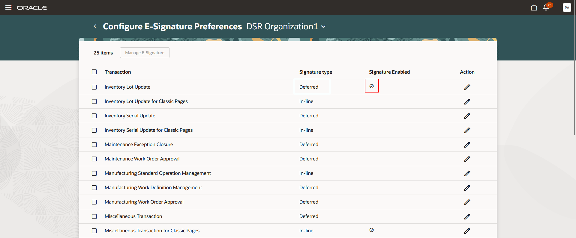

Configure Electronic Signature Preferences: You can use the Configure Electronic Signature Preferences page to enable E-Signature for your organization.
Follow these steps to enable or disable this feature:
  1. In the Setup and Maintenance work area, search for and select the Configure Electronic Signature Preferences task.
  2. Add a new organization or select an existing one.
  3. Click the Edit icon, check the Signature Enabled box, and choose the appropriate Signature Type.
  4. Click the check mark icon to save your changes.
  5. To enable or disable electronic signatures for multiple or all transactions at once, use the Manage E-Signature action.
