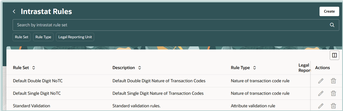

Use the new Intrastat Rules page to view, create, or update Intrastat Rules.
Intrastat Rules
Intrastat Rules

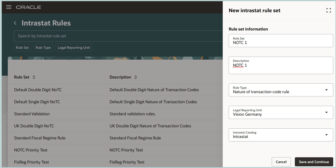

You can use the new Intrastat Rules page to create these types of Intrastat Rules:
  • Attribute validate rule
  • Exclusion rule
  • Fiscal regime code rule
  • Nature of transaction code rule
  • Statistical code rule
  • Statistical value calculation rule
  • Supplementary UOM rule

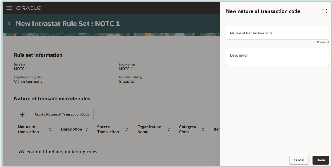

New Nature of Transaction Code Intrastat Rule
On the Intrastat Rule page for a Nature of transaction code rule type, click Create Nature of Transaction Code to create a new entry. This will be used on the Intrastat Transaction page. Similarly, you can use the Fiscal Regime rule type to create a new Fiscal Regime, and the Statistical Code rule type to create a new Statistical Code.
Create new nature of transaction code

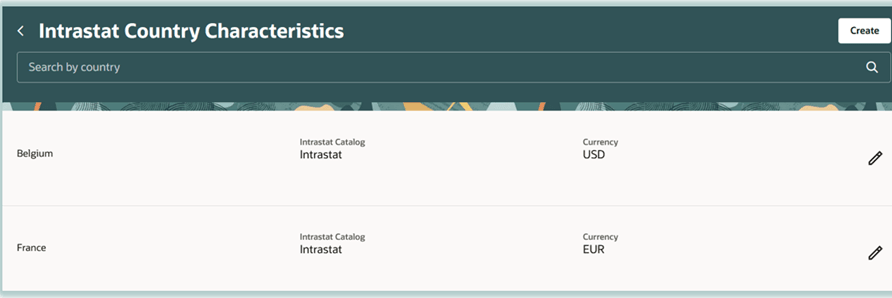

Go to the Intrastat Country Characteristics page to view, create, or update Intrastat characteristics for a country.
You can access the Intrastat Country Characteristics task from the Setup and Maintenance work area.

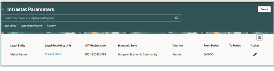

Go to the Intrastat Parameters page to view, create, or update Intrastat parameters for an LRU.
You can access the Intrastat Parameters task from the Setup and Maintenance work area.

  • The New Intrastat Transactions page in Redwood doesn't support the creation of a new Nature of Transaction Code, Fiscal Regime, or Statistical Code during the creation of a new Intrastat transaction.
  • On the Intrastat Rule page for a Nature of transaction code rule type, you can use Create Nature of Transaction Code to create a new entry to be used on the Intrastat Transaction page. Similarly, you can use the Fiscal Regime rule type to create a new Fiscal Regime, and the Statistical Code rule type to create a new Statistical Code.
