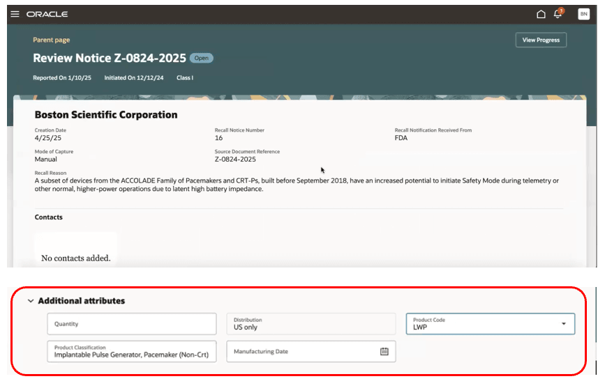

You can now enter additional attributes for a recall notice and its corresponding lines using descriptive flex-fields (DFF) while manually creating the recall notices through the user interface. These can be either context-sensitive flexfields or global flexfields.
DFFs in Recall Notice
You can also define business rules using DFF to hide an attribute, make an attribute a required field, or default a value in a flexfield based on another flexfield value.

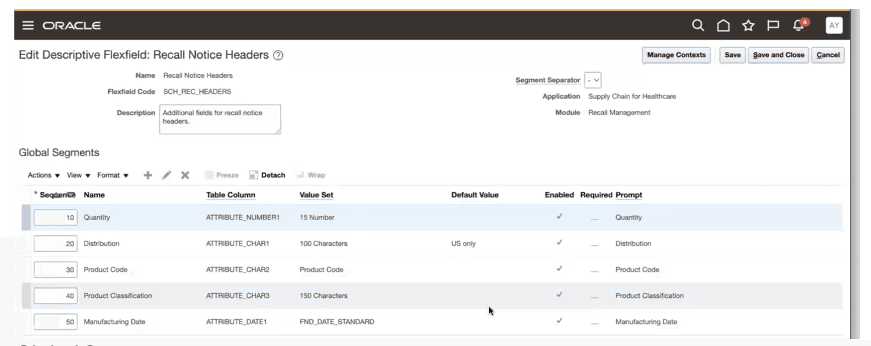

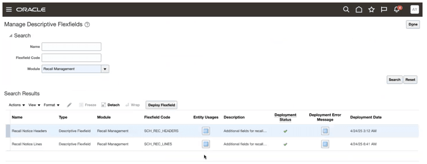

To enable this feature, define descriptive flexfields at the recall header or line level as follows:
  1. In the Setup and Maintenance work area, use the Manage Descriptive Flexfields task.
  2. Search with the module as Recall Management.
  3. Edit the Recall Notice Headers and Recall Notice Lines to add global segments or context sensitive segments as per your business needs.
  4. Deploy the flexfields.
