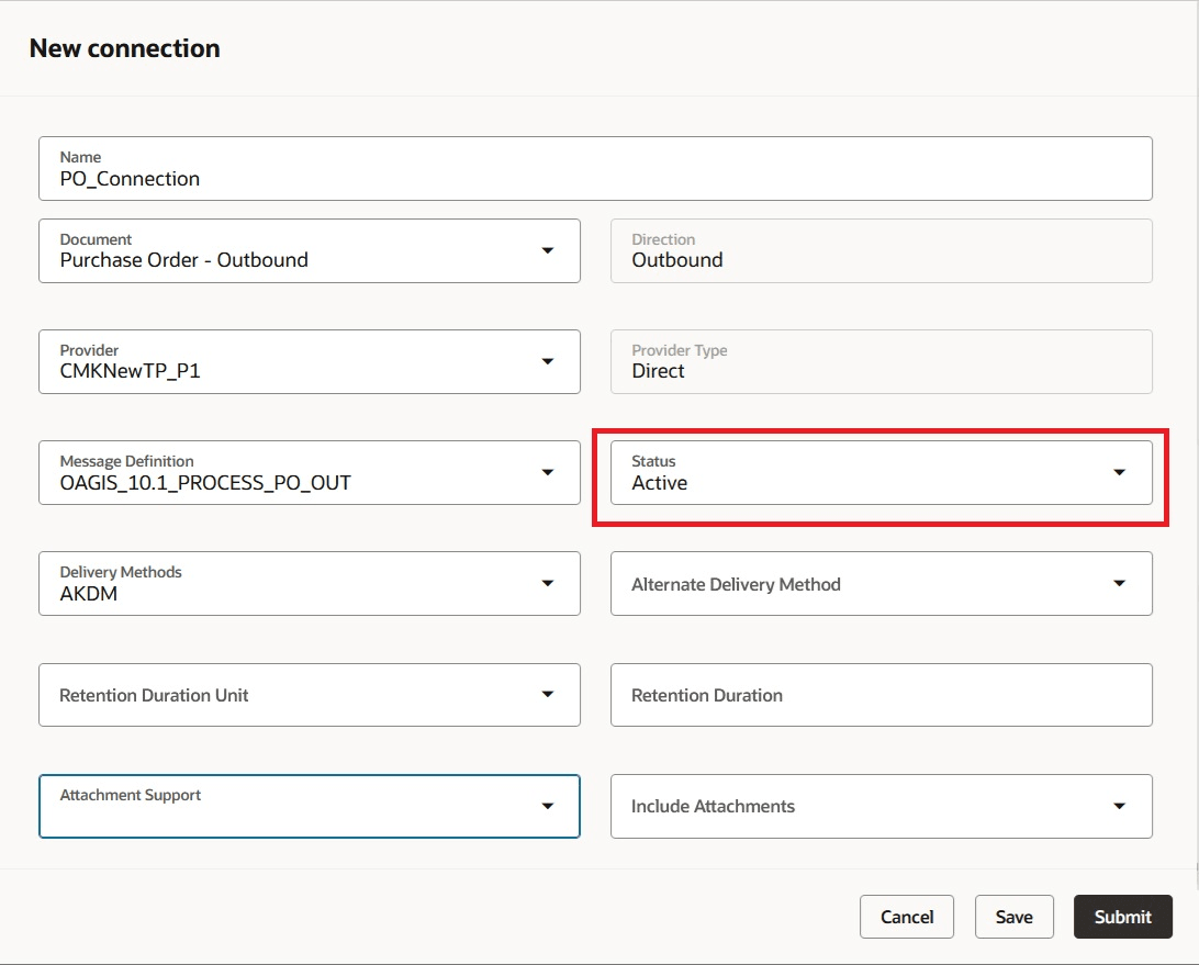

Create a Connection for Each of the Documents You Exchange
A connection identifies a specific configuration for exchanging a document with a third party and you must define an active connection for each of the documents you exchange.
  1. Select B2B Connections from the Task Panel.
  2. Select the Connections tab.
  3. Click Add to add a new connection and enter the details. Set the status to Active and click Submit.
  4. Repeat this process to create connections for all your purchasing and receiving documents.
Add a Connection
Add a Connection

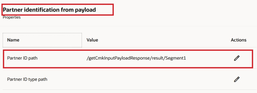

    1. For your outbound documents, you can configure the document so that you get the partner information from the payload for message processing.
    2. Enable the property group Partner identification from payload.
    3. Click Edit Properties and enter a value for Partner ID path. You can also enter a value for Partner ID type path. If you don’t enter a value, the partner ID type Generic is used.
Partner ID from Payload

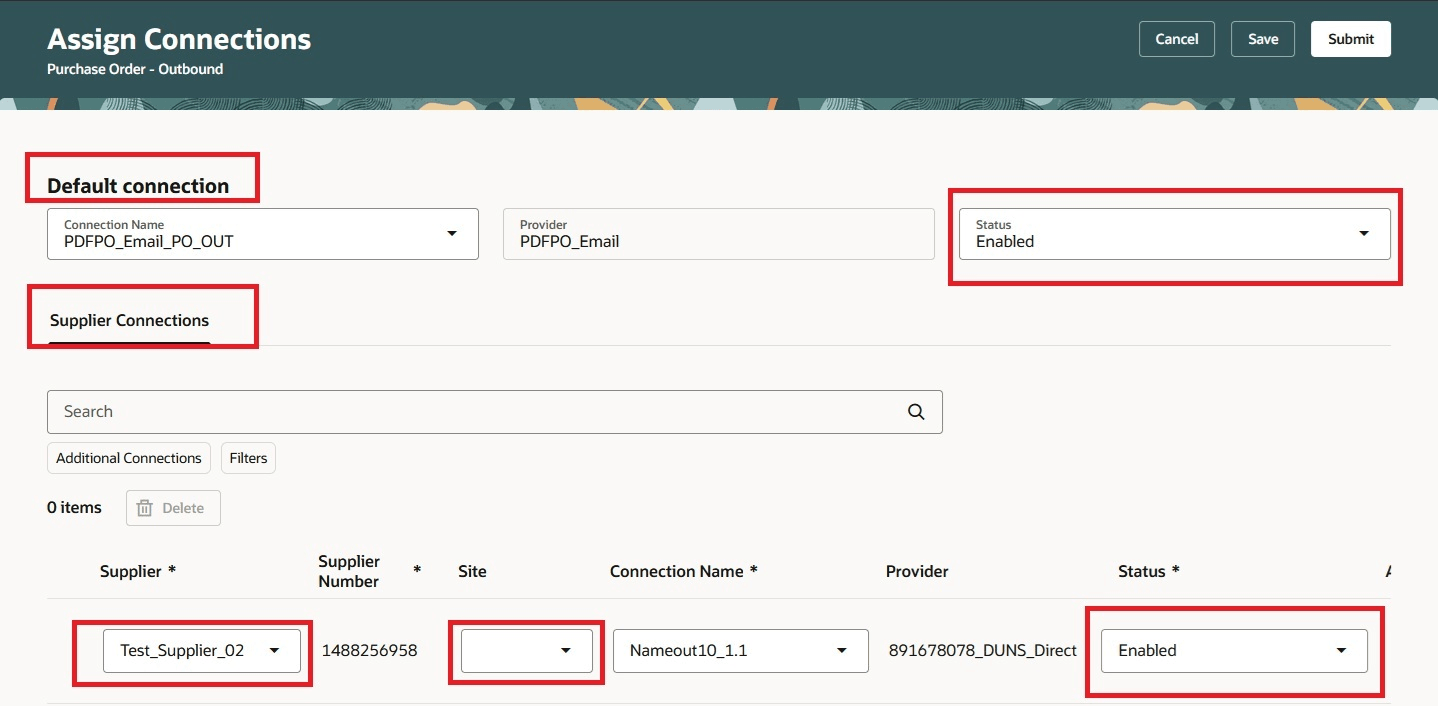

  1. After you have configured document properties for each of your documents, assign connections to your outbound documents. On the B2B Documents page, select the outbound document you are configuring and click Assign Connections.
  2. On the Assign Connections page, select a default connection for the document and enable it. This default connection is used to process the document where there isn’t another connection.
  3. If you want to use a different connection for a specific supplier, for example, a different service provider or transformation for a specific supplier, you can assign a supplier connection to the document in addition to the default connection. Supplier connections can be assigned to supplier or a supplier site.
  4. Click Submit.
Default and Supplier Connection

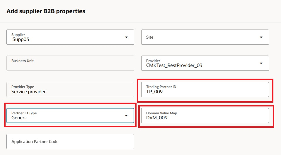

Add Supplier B2B Properties
If you have configured your outbound document to get partner identification from payload, you can add supplier B2B properties to associate domain value maps to your suppliers.
If you haven’t configured your outbound document to get partner identification from payload and you are using a service provider, you’ll need to add supplier B2B properties to provide partner identification information for each for your suppliers for message processing.
Here’s how you add supplier B2B properties:
  1. Select B2B Partners from the Task Panel.
  2. Select the Supplier B2B Properties tab, and click Add.
  3. Add partner information and or a domain value map. The site is optional unless you're providing an application partner code.
  4. Click Save.
