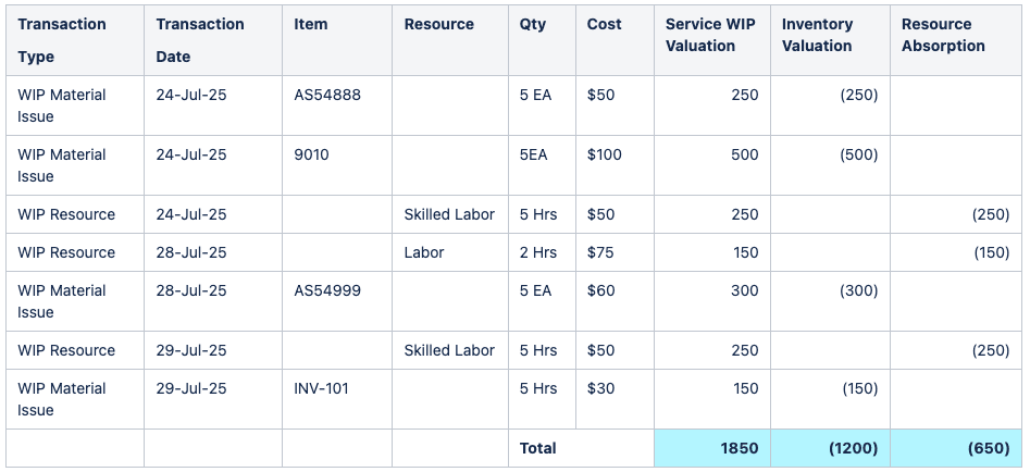

Let's take an example of a service work order where both parts and resources have been reported and Service WIP option is enabled.
Example: Cost Distributions when service WIP is enabled

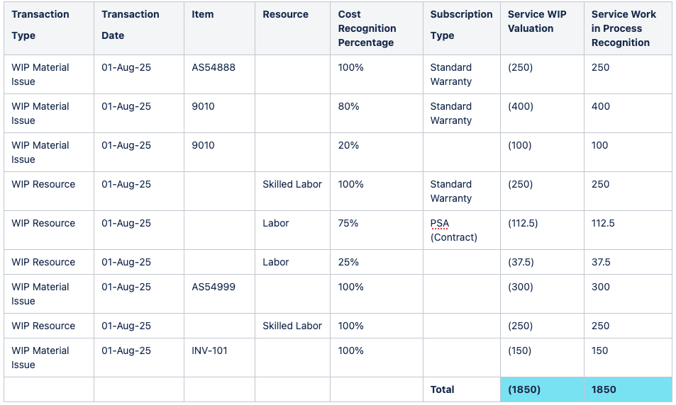

After the charges are posted in the Service Logistics application, the invoice and revenue recognition information gets interfaced to costing. Based on this information, the cost processor would create the following distributions to recognize the service costs.
Example: Cost Distributions created to recognize service costs

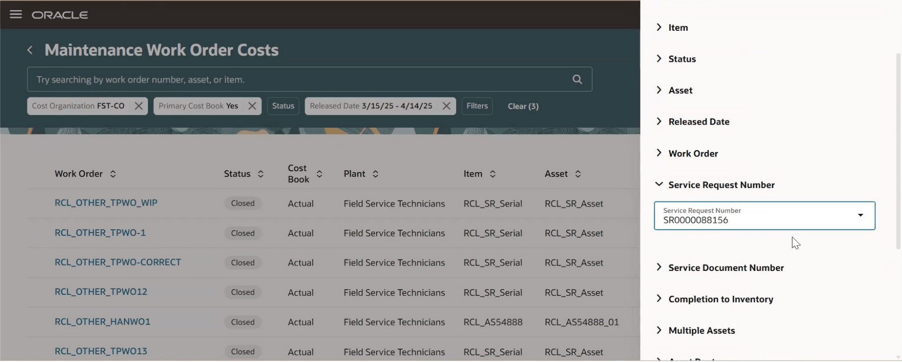

You can use the Maintenance Work Order Costs page to search for the maintenance work orders using the Service Request Number and Service Document Number.
New filters in maintenance work order costs page

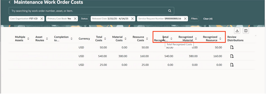

You can track the total recognized costs, recognized material, and recognized resource costs for each work order that has Service WIP enabled.
New columns added to the maintenance work order costs page

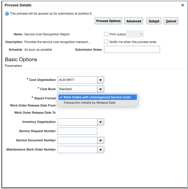

You can use the new Service Cost Recognition Report to track the total costs accrued in Service WIP and the Service Cost Recognition details.
