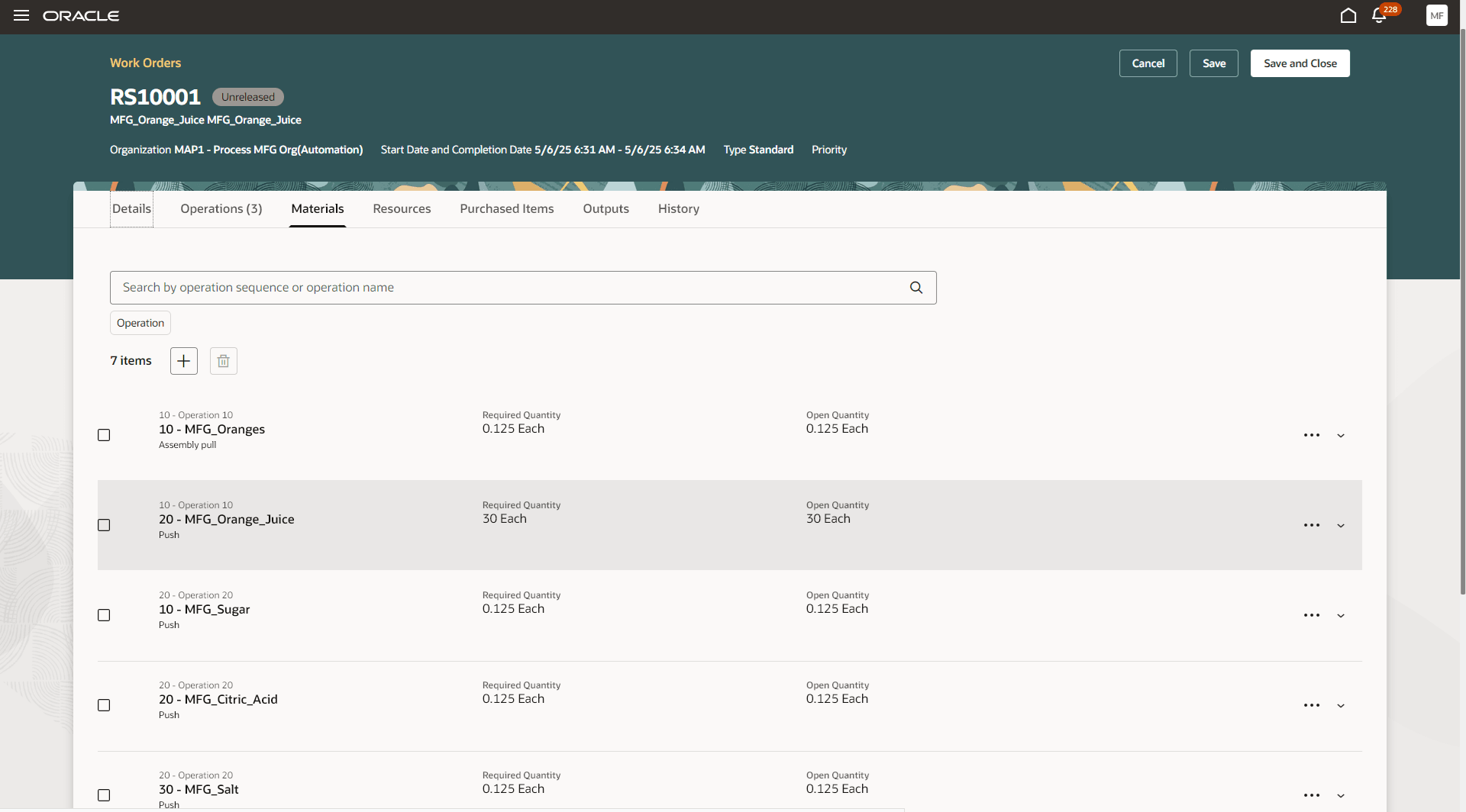

In specific process industries, it's common practice for manufacturers to recover a product or by-product from the production process and rework it back into the batch for further processing. Another business process takes the product left over from one batch as the starting point for the next batch, such as when filling a product into containers. In these dynamic scenarios, the same item can be used as an ingredient and a product of the batch, creating a circular reference between the batch input and batch output.
With this feature, you can issue and complete the same item in a process manufacturing work order. There are no restrictions that prevent the same item from being used as both the input and output for an operation, or for multiple operations. The added value between the input and output can be costed. However, a process manufacturing work order with a circular reference cannot be planned. We recommend that the work order should be created separately from the planning process and that separate work definitions be used for production execution and planning.
Same Item as both Input and Output in a Process Work Order
Same Item as Both the Input and Output in a Process Work Order

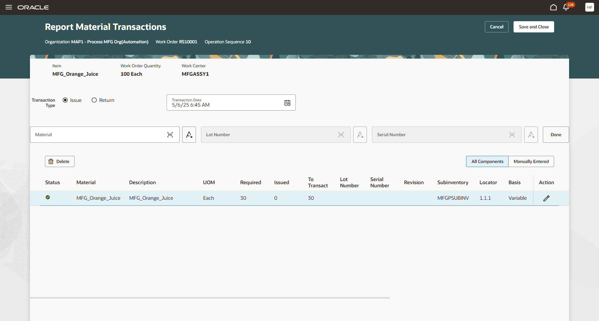

Output Item transaction as input Item
Output Item Transaction as Input Item
This simplified modeling to use the same item for consumption and completion helps process manufacturers accurately reflect their physical production processes without unnecessary changes to manufacturing setups and execution.

  • The Opt-in choice cannot be updated after you add an output item as input and transact the item in material or output transactions.
  • You can also report material and output transactions for a work order operation using the "Execute Production at a Workstation" action.
