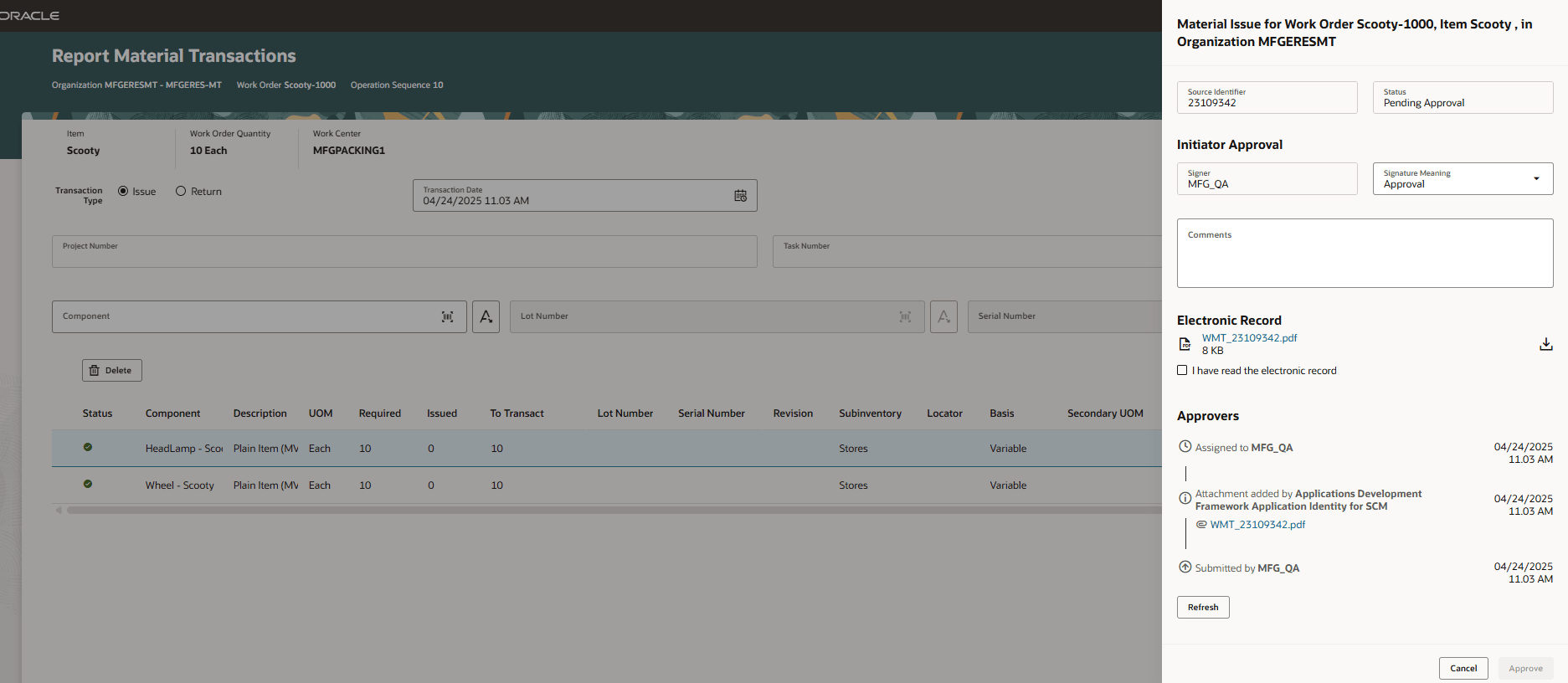

With this update, you can capture an inline e-signature approval and view the generated e-record when reporting material transactions for a work order operation using the Redwood user experience.
The following screenshot shows the submission of the material transaction for electronic signature approval process:
Submit Material Transaction for Electronic Signature Approval

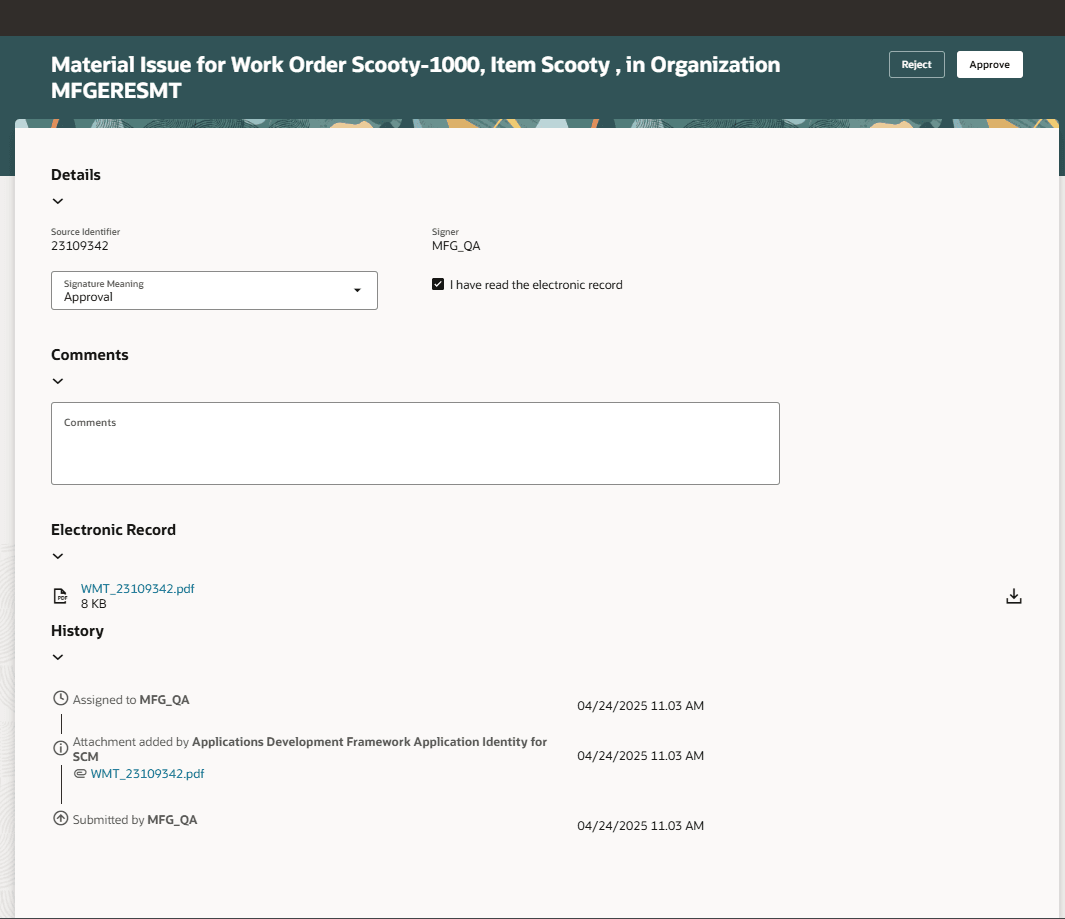

The approver can then review and approve the electronic record, in a Single Sign-On approval notification window, as shown below:
Electronic Signature Approval Notification Window

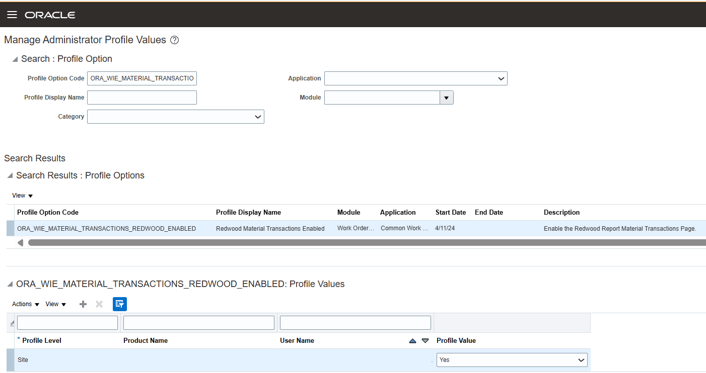

- Set up the Profile to enable the Redwood experience for material transactions, as follows:
- In the Setup and Maintenance work area, search for and select the Manage Administrator Profile Values task.
- On the Manage Administrator Profile Values page, search for and select the ORA_WIE_MATERIAL_TRANSACTIONS_REDWOOD_ENABLED profile option code.
- In the Profile Values section, set the Site level to Y or N. The default value of the profile option is Y.
- Y = Enables the feature.
- N = Disables the feature.
- Click Save and Close. Changes in the profile value will affect users the next time they sign in.
Profile Option for Accessing Material Transaction Using the Redwood User Experience
