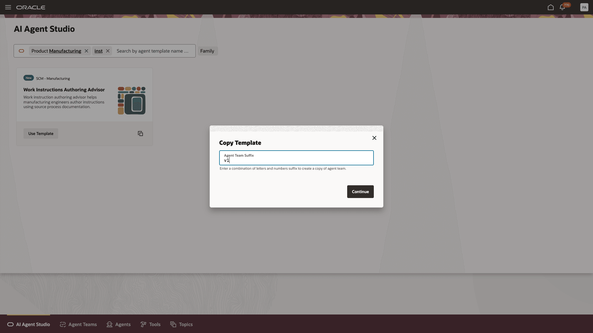

1. Create and Publish Agents Using AI Agent Studio
You can use AI Agent Studio to use or copy a preconfigured agent template to create Agents for your business processes. To automatically add a suffix to all artifacts in your agent team, you can Copy Template instead of Use Template. When you copy a template, you're directly taken to the agent team canvas where you can edit the agent team settings, agents, tools, and topics. The Use Template option takes you through a step-by-step process for configuring each artifact in the agent team.
For information on using AI Agent Studio, see How do I use AI Agent Studio?
Creating an Agent using Copy Template

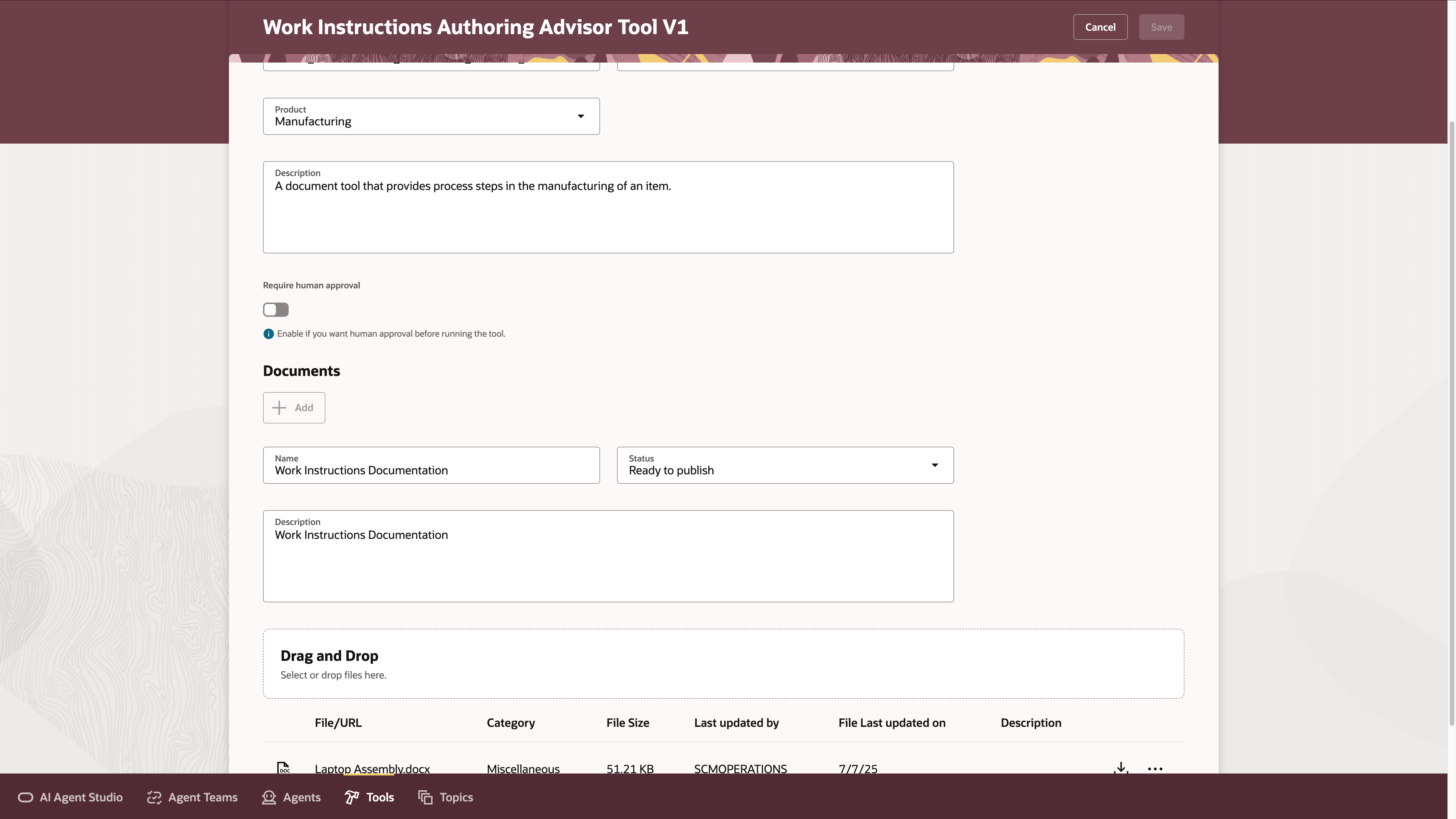

2. Publish the Agent with Documents:
  • Switch to the Tools tab and find the document that was created using the template. You can use the suffix or the name you entered while creating the agent to search.
  • Add the documents containing the work instructions knowledge base for your organization.
  • After you save the documents, change the status to Ready to Publish.
  • Finish publishing the documents by running the 'Process Agent Documents' scheduled process.
Publishing documents for the Agent
Publishing Documents for the Agent

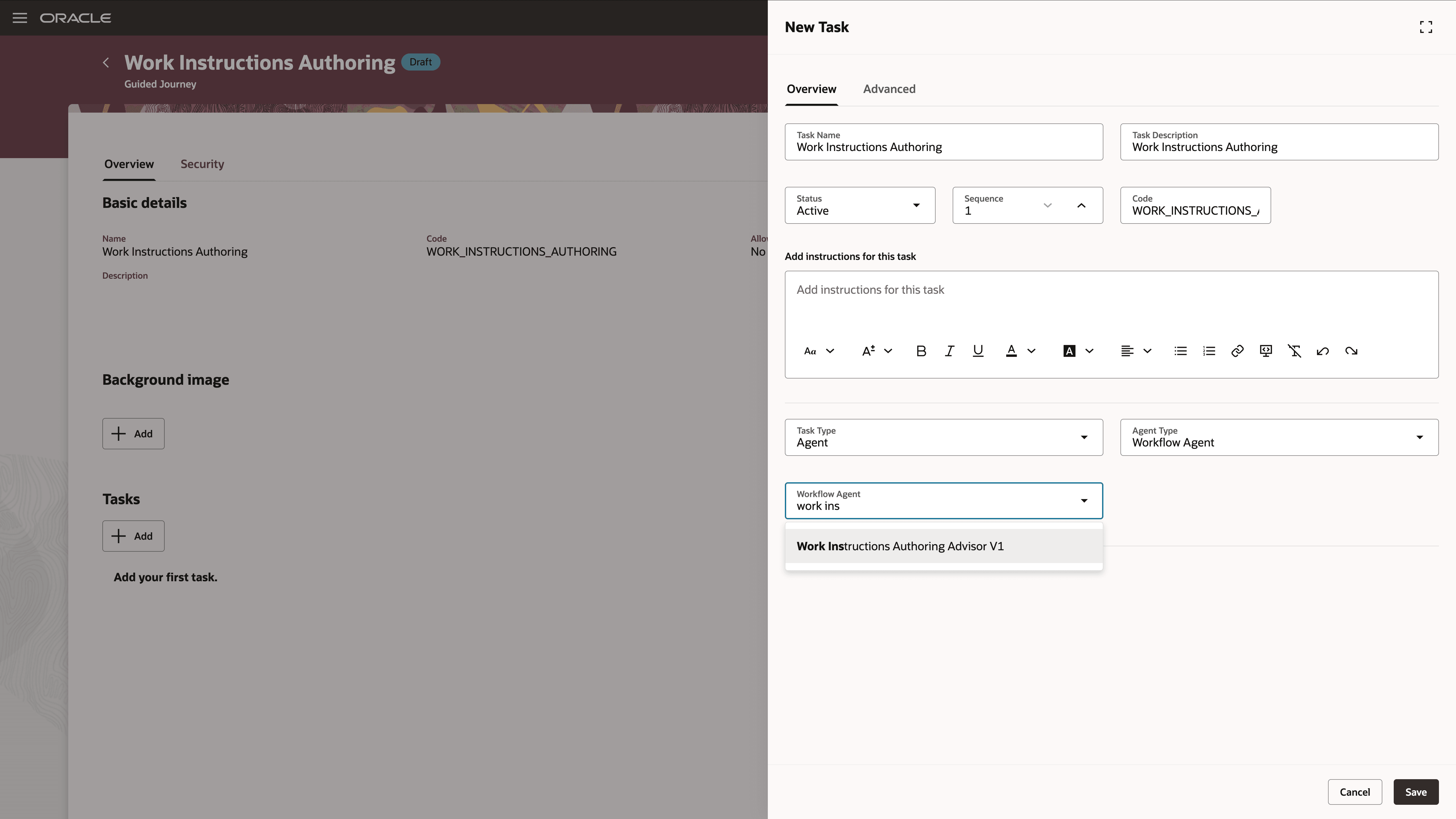

3. Add the Agent to a Guided Journey
  • Navigate to Guided Journeys from My Client Groups.
  • Create a new journey or edit an existing journey.
  • Add a task to the journey of the type Agent.
  • Select Workflow Agent as the agent type.
  • Pick the agent that you just published and associate it with this task.
  • You can add the same agent to multiple journeys or multiple agents to this journey by creating more tasks.
Adding the agent to a Guided Journey Task
Adding the Agent to a Guided Journey Task
