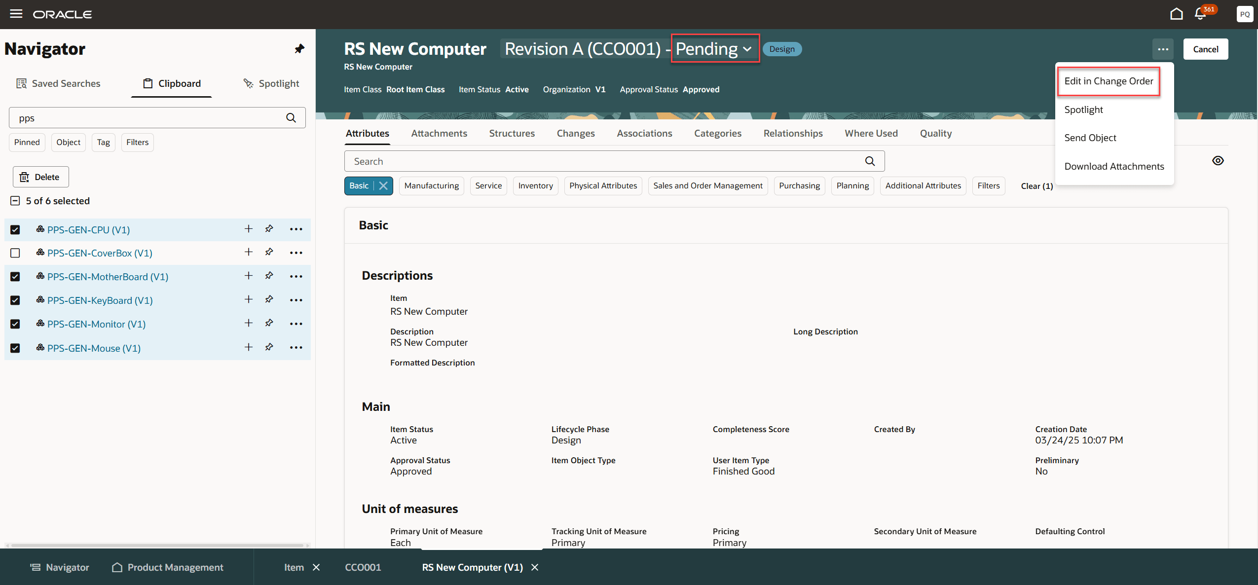

Select Edit in Change Order from the Actions menu to modify a pending revision. This will render the page in the change context and the changes made will be redlined.
Select Edit in Change Order Action to Edit Pending Revision

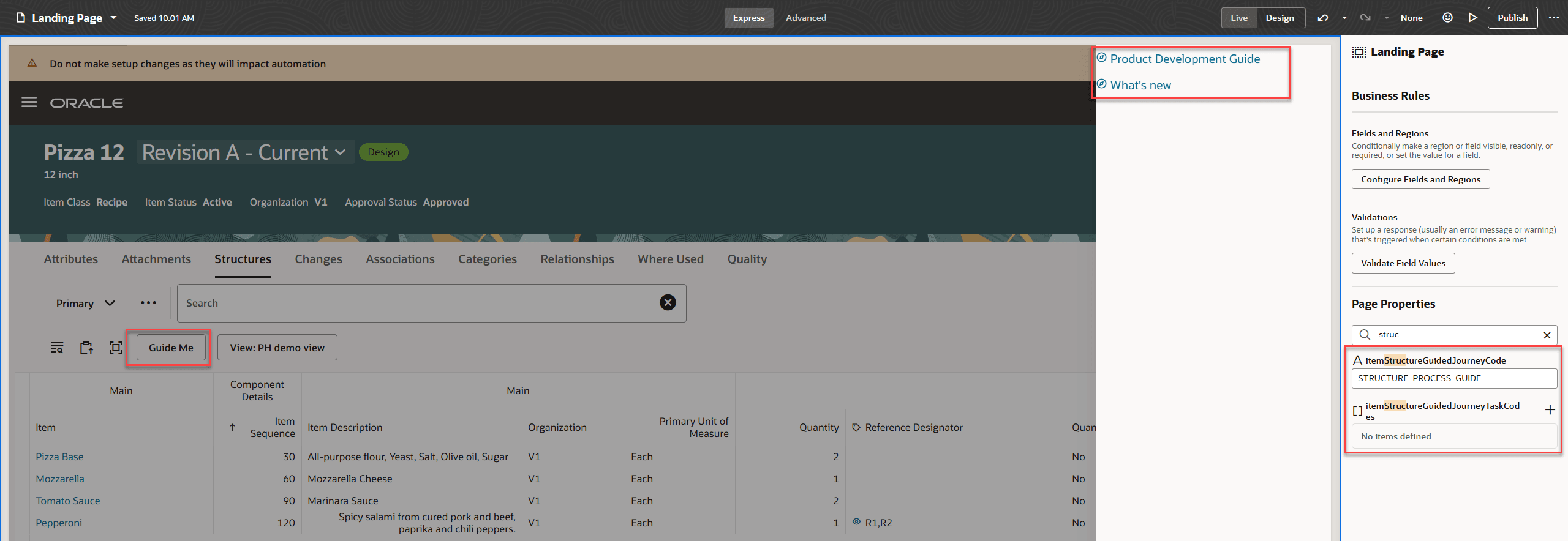

You can configure guided journeys for structures that will let you provide relevant instructions or guides to create or modify the structure. The Guide Me button is displayed when the Page Properties for structure guided journey is configured.
Guided Journey in Structure
