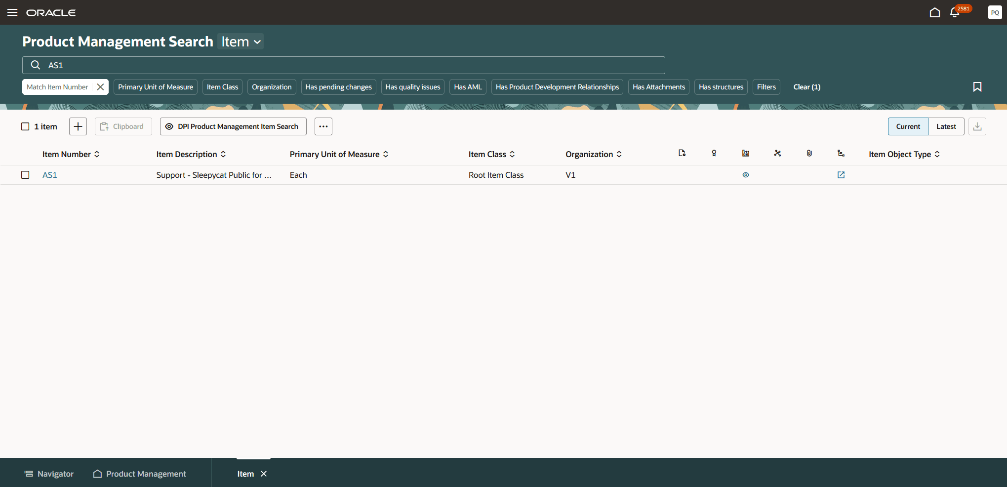

The following screenshot shows the search performed for a single item number using the Match Item Number filter option.
Match Item Number Search

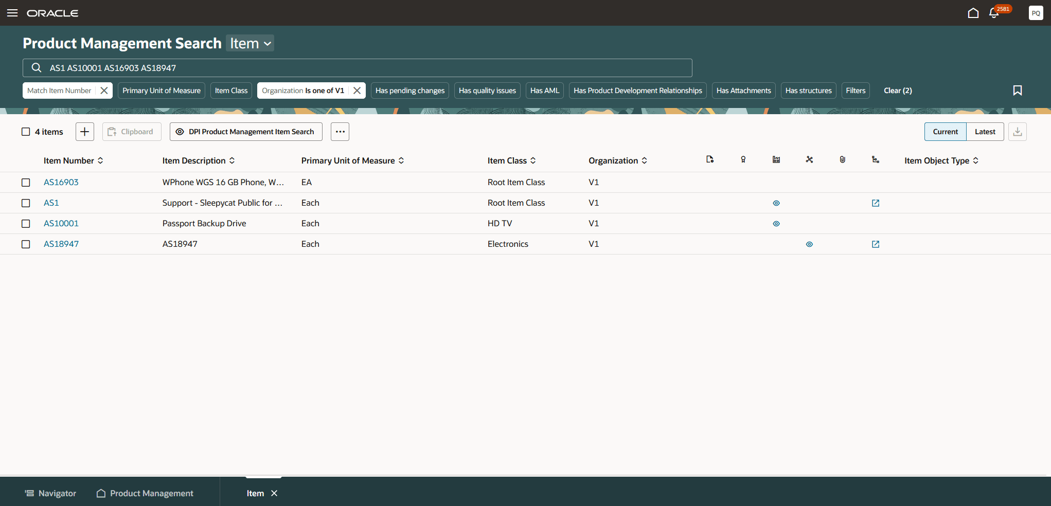

The following screenshot shows the search performed for multiple item numbers using the Match Item Number filter option.
Multiple Item Search Using Match Item Number

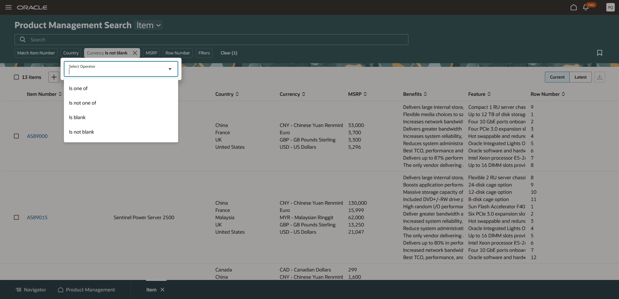

The following screenshot shows the filter operators for the Currency filter.
Select Filter Operator For Currency Filter
