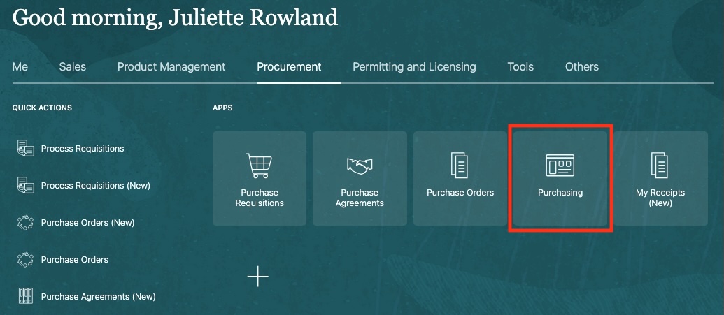

You can access the Purchasing landing page using the Purchasing icon to launch the page:
Tile to Access Purchasing Landing Page

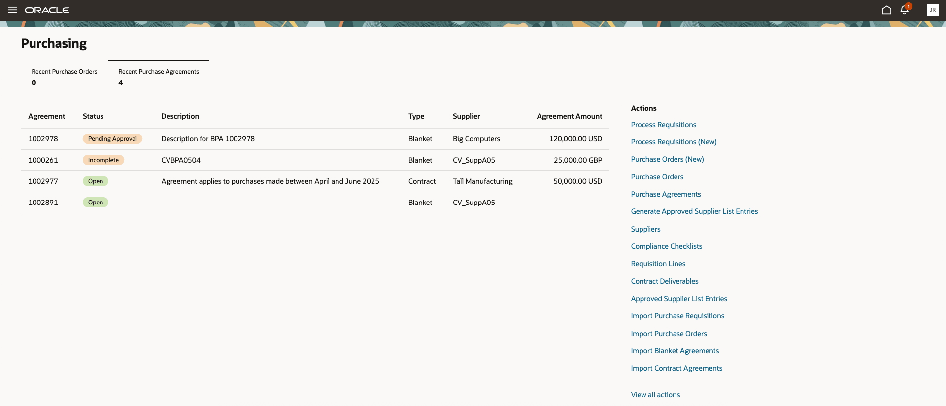

In this update, you'll see a new scorecard on the landing page. This scorecard shows your most recent purchase agreements, up to 25. Purchase agreements are added to this list when you view them or perform specific actions, such as opening the PDF or duplicating an agreement.
New Agreements Scorecard on Landing Page

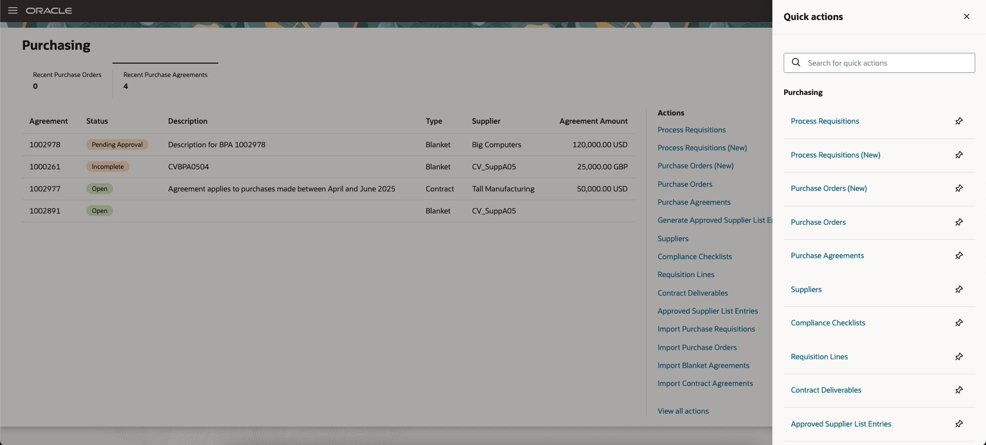

In addition to the Recent Purchase Orders scorecard, you'll find a list of quick actions or links to tasks that may be important for your job. By selecting the View all actions link, you can pin your favorite links to this panel for easy access.
Quick Actions
Quick Actions
