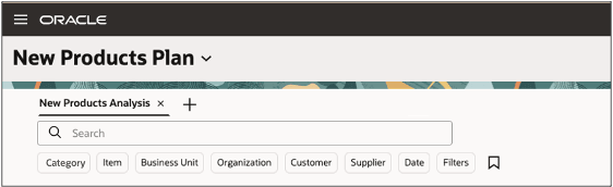

New Search Filters
The search filters are categorized as:
- Product Dimension: By default, two filters are displayed. In the screenshot, the lowest level, Item and its immediate parent level Category are displayed. If there are multiple product hierarchies in a plan, then the immediate parent level is displayed for all the product hierarchies. You can see all the other levels by clicking the Filters search option.
- Organization Dimension: By default, two filter are displayed. In this example, the lowest level, Organization and its immediate parent level, Business Unit in the Organization hierarchy is displayed. You can see all the other levels by clicking the Filters search option.
- Customer
- Supplier
- Date
The other filter options appear in the side panel drawer.

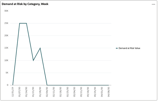

In the given visualization, the plan start date is 01/07/30 and the plan end date is 04/08/30. The time bucket defined for this plan is Week.
Visualization Filtered by Plan Start Date and Plan End Date

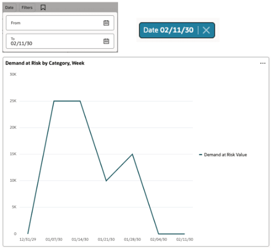

Consider a scenario when the From field is undefined and the To field is defined with a date. In this case, the visualization considers the plan’s start date.
Graph Filtered Using Only The To field

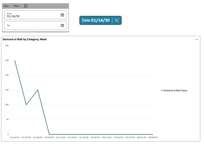

Now consider a scenario when the From field is defined and the To field is undefined. In this scenario, the graph considers the plan’s end date.
Graph Filtered Using Only the From field

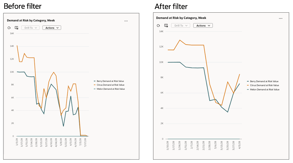

When a date range is included in a graph, applying a date filter changes the graph's time frame range to show the data in line to the date filter applied.
Visualizing a Graph with Time-based Filters

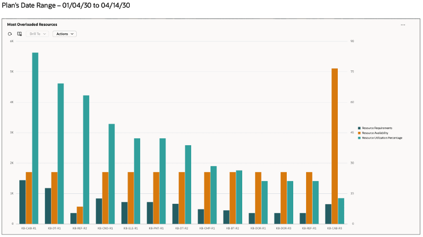

Data relevant to the date range chosen as the date filter is displayed in graphs that don't explicitly display a date range but have time range criteria. The following graph, Most Overloaded Resources doesn’t display any dates on the graph.
Graph filtered Without the Date Range
However, if you apply the date range filter criteria, the resource requirements for the date range are considered as the effective start and end dates. The following graph displays the associated resources data within the specifies date range.

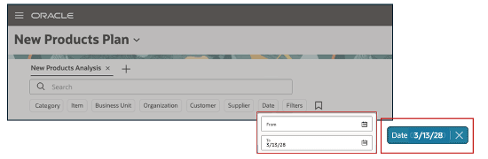

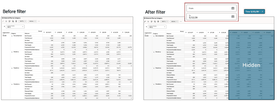

- Pivot Tables with time dimension: In Pivot tables, applying time range filters to the table shows or hides the data based on the specified time range. This also applies to the time range time buckets in the pivot table grid. Consider a scenario where the date range is specified in the To field as 3/13/28 for a pivot table.
Data is Displayed or Hidden Based on the Time Range Specified
In the given pivot table, the data for the dates after the To date, 03/13/28 aren’t displayed.

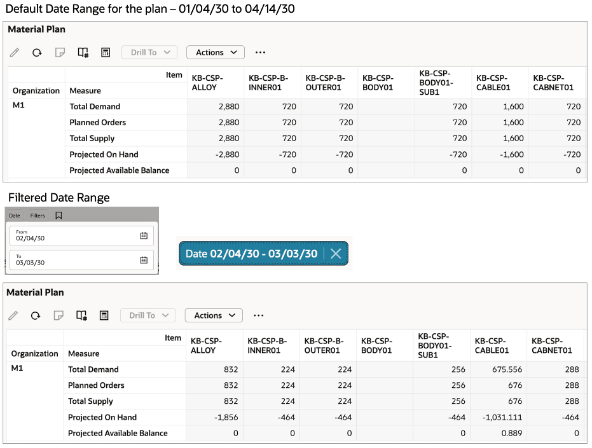

- Pivot Tables without time dimension: Pivot tables that don’t explicitly display a time dimension as rows or columns, the date range filter display the data as associated with the entity data for the respective time period. In the following example, the Material plan is filtered by a date range. The pivot table data shows the measure data related to the filtered date range only.
Pivot Table Using Date Range Filter

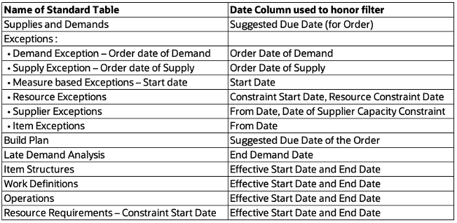

In case of standard tables, the data is filtered based on their corresponding time members. For example, Supplies and Demands use the time range Suggested Due Dates for orders.
Here’s a list of search filters based on the date columns and date range:
Date Columns for Standard Tables
