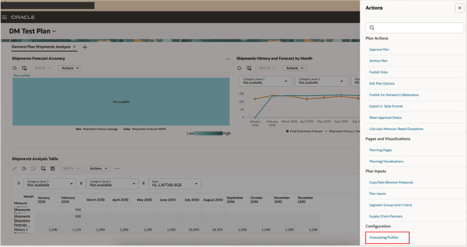

In the Redwood work area named Supply Chain Planning, for a demand, demand and supply, or replenishment plan, click More Actions > View More to open the Actions drawer, and then click Forecasting Profiles in the Configuration section.
Actions Drawer for Demand Plan

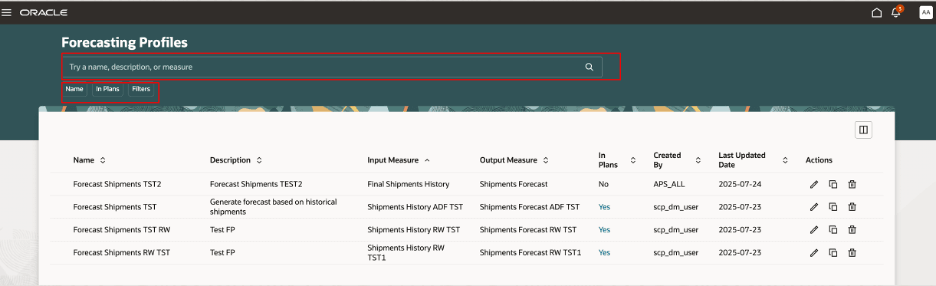

The Forecasting Profiles page will open on a new tab and display a list of forecasting profiles.
Forecasting Profiles Page

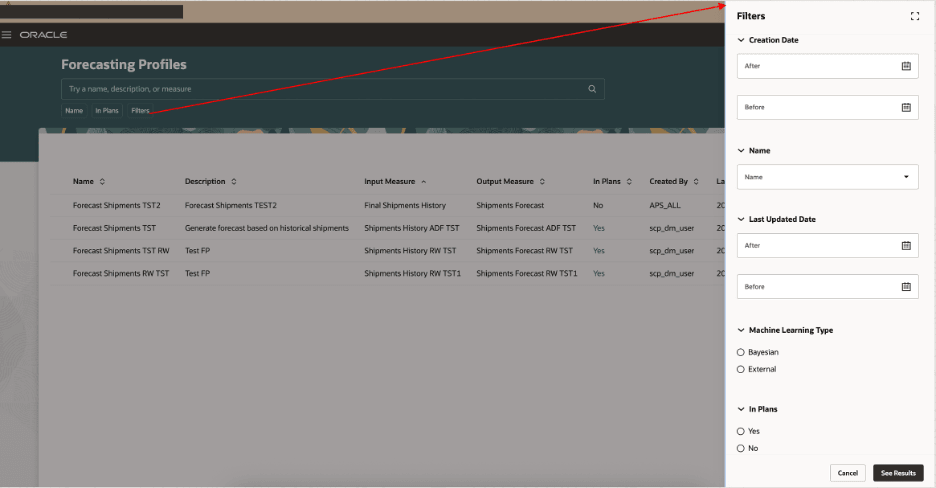

You can use the search bar to search for forecasting profiles by name, description, input measure, or output measure. You can use the suggested filters named Name and In Plans. When you click Filters, the Filters drawer opens and provides you with additional filters.
Filters Drawer on Forecasting Profiles Page

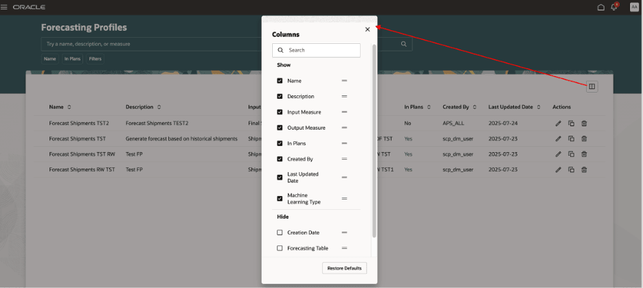

Click the Columns icon to open the Columns dialog box in which you can select the columns that you want to show or hide on the Forecasting Profiles page.
Columns Dialog Box on Forecasting Profiles Page

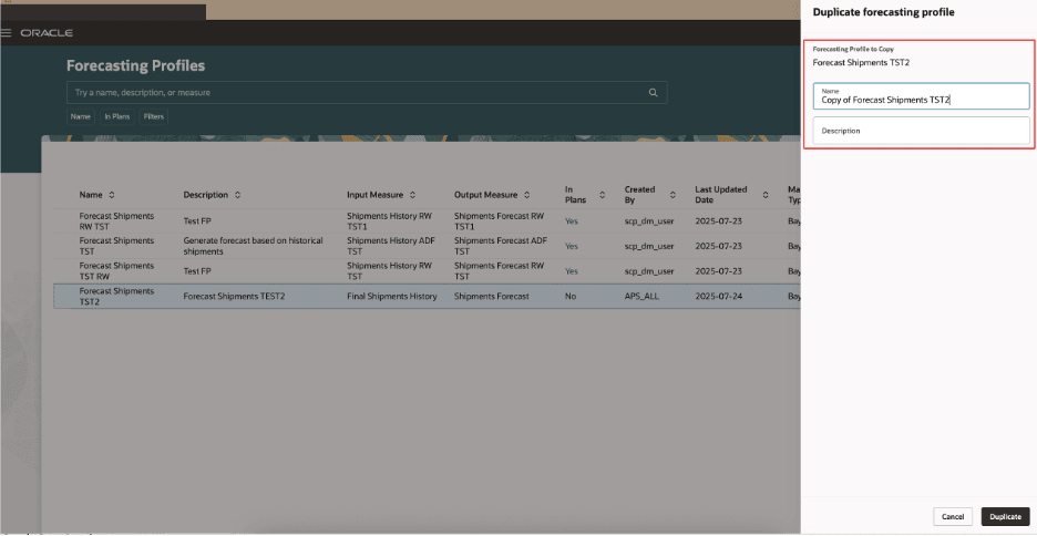

Duplicate a Forecasting Profile
Note these points about duplicating a forecasting profile:
  • You can create a forecasting profile by duplicating an existing one.
You can edit the new forecasting profile and use it in your plan.

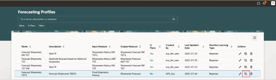

  • You can select the forecasting profile you want to use as the source for the new forecasting profile and click the Duplicate icon to open the drawer named Duplicate forecasting profile. The forecasting profile being copied is indicated in the drawer.
You can enter a name and description for the new forecasting profile.
When you click Duplicate, the duplicate forecasting profile is created, and a confirmation message is displayed.
  • If any errors or warnings occur, they will be displayed at the top of the page.
Duplicate Icon on Forecasting Profiles Page
Duplicate Forecasting Profile Drawer
Confirmation Message After Duplication of Forecasting Profile

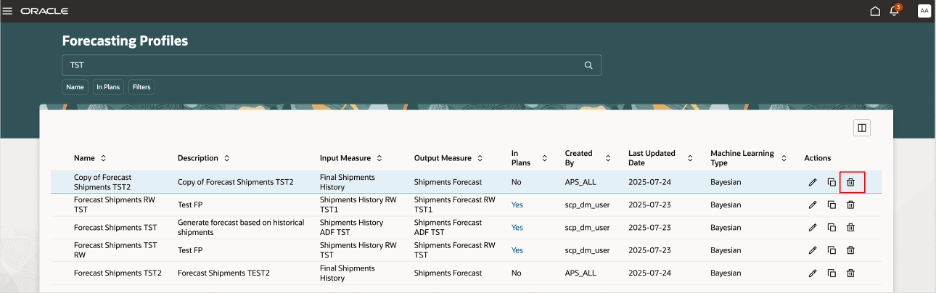

Delete a Forecasting Profile
Note these points about deleting a forecasting profile:

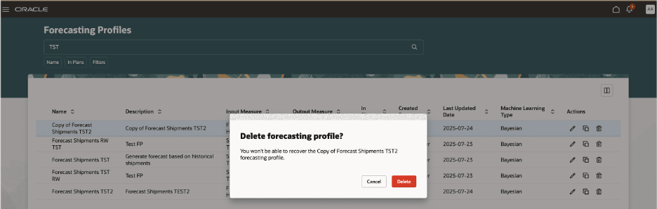

  • When you delete a forecasting profile, all configurations specific to the forecasting profile are purged and can’t be recovered.
  • You must select the forecasting profile you want to delete and then click the Delete icon to delete the forecasting profile.
  • When you click the Delete button in the confirmation message, the forecasting profile is deleted, and another confirmation message is displayed.
  • If the forecasting profile is associated with any plans, you won’t be able to delete the forecasting profile until you remove it from the plans. The Associations drawer will indicate the plans that contain the forecasting profile.
Delete Icon on Forecasting Profiles Page
Confirmation Message for Deleting Forecasting Profile
Confirmation Message After Deletion of Forecasting Profile

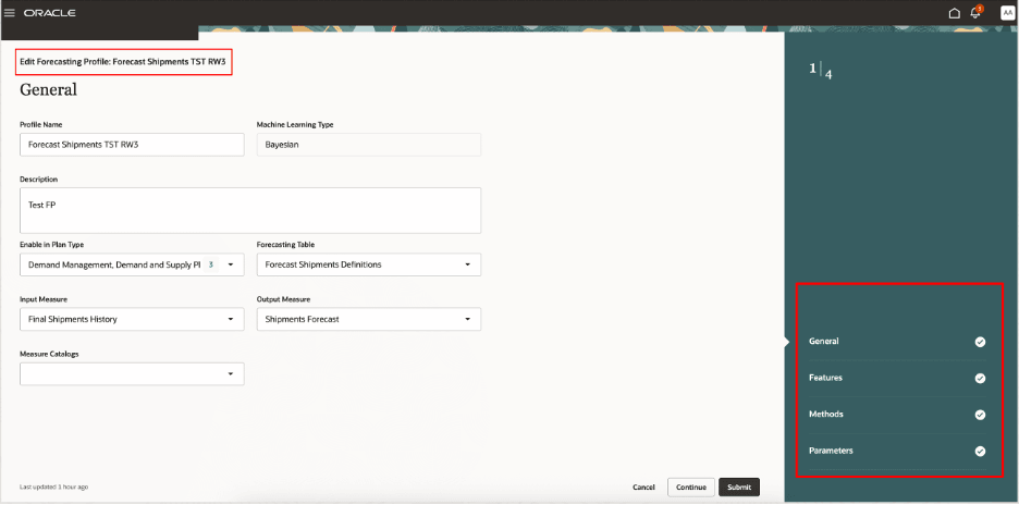

Edit a Forecasting Profile
Note these points about editing a forecasting profile:

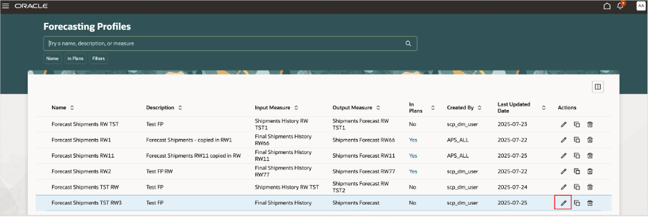

  • You must select the forecasting profile you want to edit and then click the Edit icon to edit the forecasting profile.
The guided process for editing the forecasting profile will open on the same tab.
  • If you have view privileges, you can only view the forecasting profile details. If you have edit privileges, you can edit the forecasting profile.
Edit Icon on Forecasting Profiles Page
Guided Process for Editing Forecasting Profile

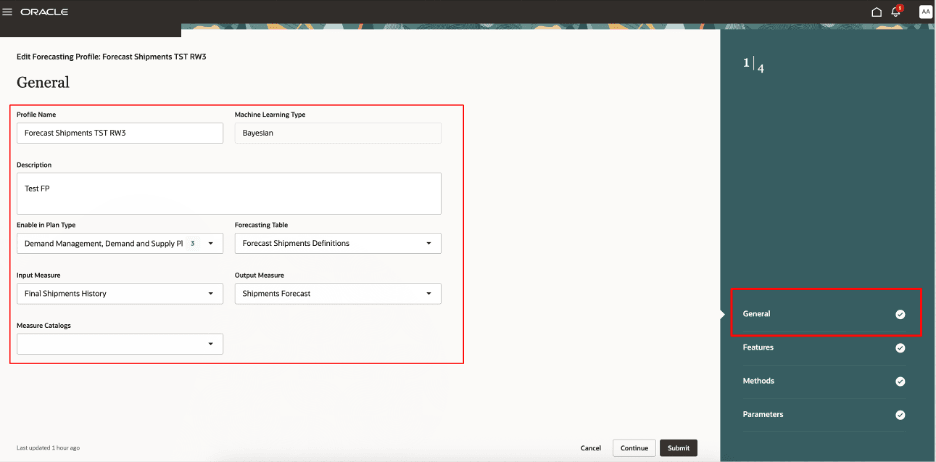

You can see the steps in sequence, click Continue to move from a step to the next step, or go directly to a step.
  • General: You can review the name, description, machine learning type, enabled plan types, forecasting table, input measure, output measure, and measure catalogs.
General Step in Guided Process for Editing Forecasting Profile

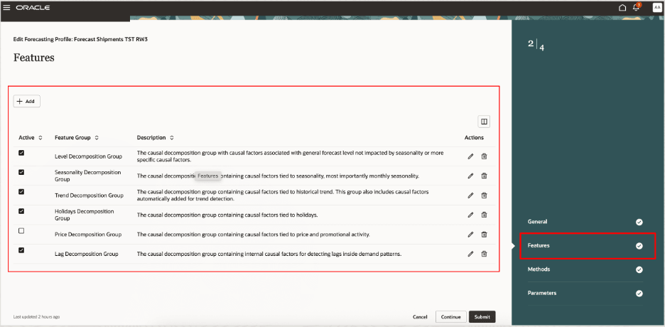

  • Features: In the classic interface, decomposition groups were used for grouping causal factors for forecasting profiles of the Bayesian machine learning type and listed on the Decomposition Groups tab in the Manage Forecasting Profiles dialog box. In the Redwood interface, decomposition groups are referred to as feature groups and listed in the Features step of the guided process.
Features Step in Guided Process for Editing Forecasting Profile

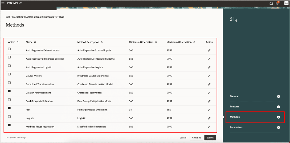

  • Methods: You can review and update statistical methods and parameters for the forecasting profile.
Methods Step in Guided Process for Editing Forecasting Profile

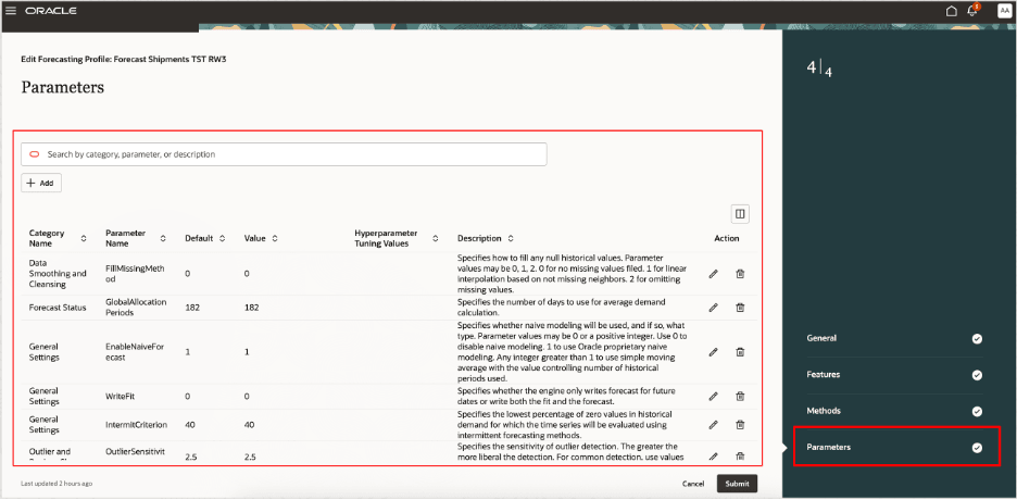

  • Parameters: You can review and update forecasting parameters for the forecasting profile.
Parameters Step in Guided Process for Editing Forecasting Profile
