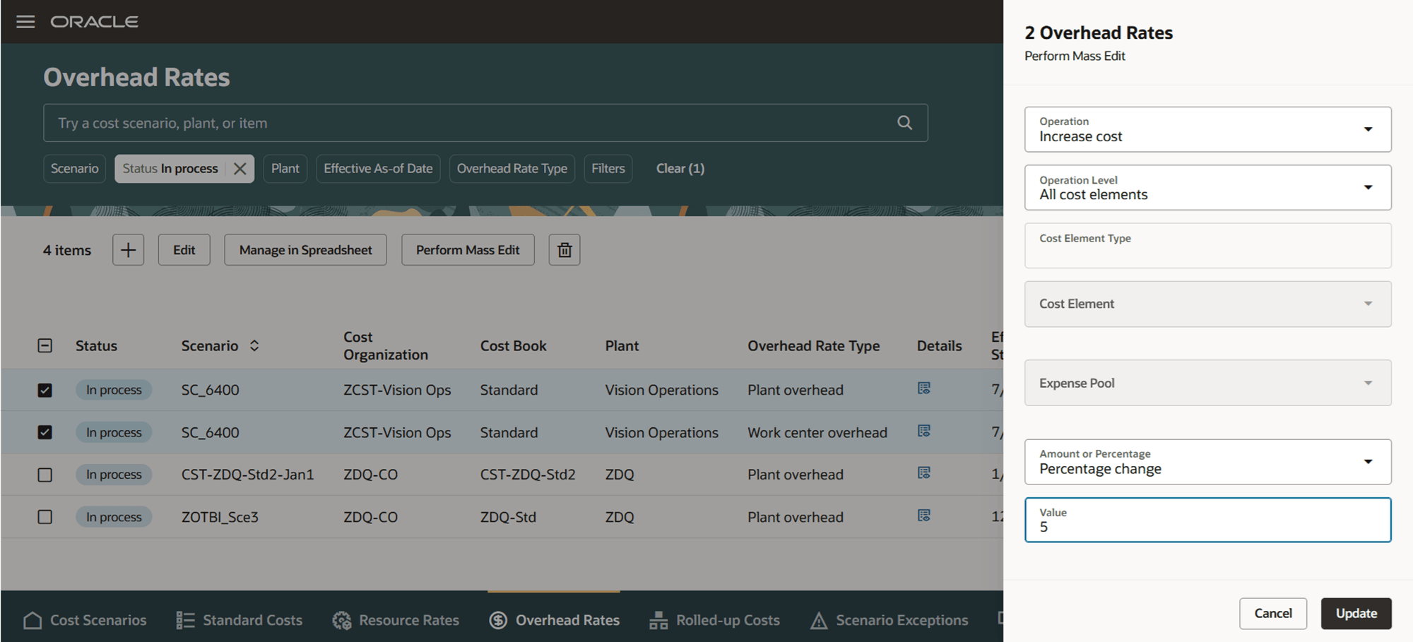

You can now select multiple unpublished overhead rates and simultaneously edit the selected overhead rates from the Overhead Rates Redwood page. You can:
  • Increase cost
  • Decrease cost
  • Replace cost
  • Add cost element
  • Delete cost element
  • Substitute cost element
  • Substitute expense pool
You can only use cost elements of type Overhead.
Screenshot with Mass Edit Capability
