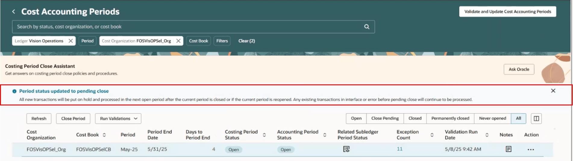

Set the Period to Pending Close
When you set the period to Pending Close, with this opt-in, you will see the message: "All new transactions will be put on hold and processed in the next period after the current period is closed, or if the current period is reopened. Any existing transactions in the interface or error before pending close will continue to be processed".
Figure 1: Period Status Update on Pending Close
Period status update on Pending Close

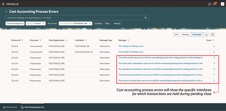

Cost Processing Errors
When you run the Create Cost Accounting Distributions process, held transactions from various interfaces will be reported. Click the transaction count to drill down to specific held transactions, organized by interface. This allows you to monitor and investigate any transactions awaiting processing due to the Pending Close hold.
Figure 2: Cost Accounting Process Errors

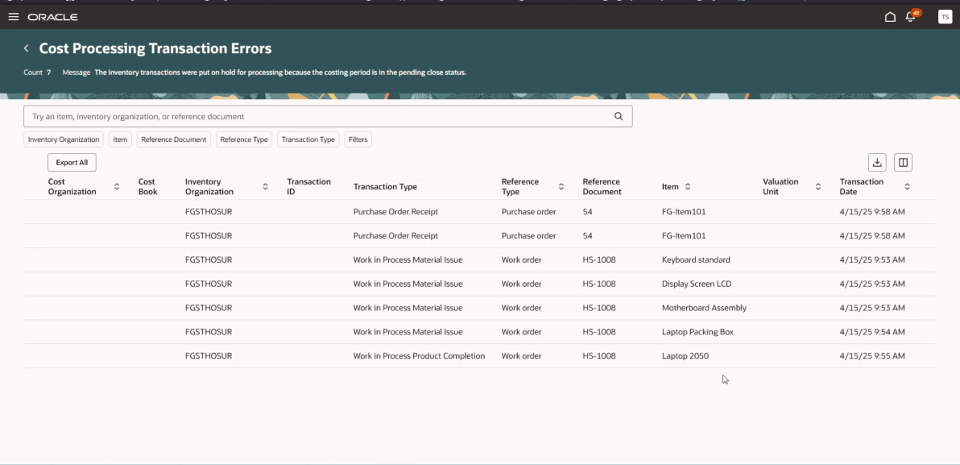

Transaction level drill down provides you full visibility to take further action:
  • Close the period if you want to sweep these transactions to the next open period.
  • Open the period again If you want to process the relevant transactions in the current period.
Figure 3: Cost Processing Transaction Errors

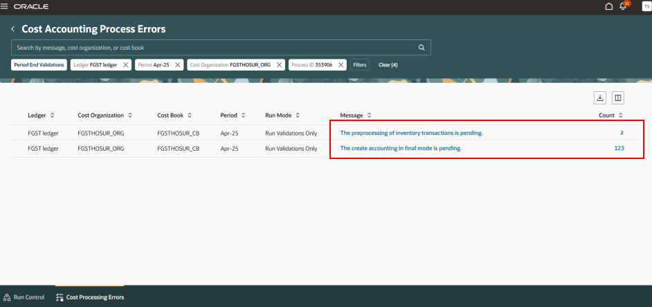

  • Run the cost processor before changing the period status to Pending Close.
    Make sure you run the following processes and then run the Create Cost Accounting Distributions process before moving the period to the Pending Close status. This ensures that the latest transactions are accounted for, and won't be held when the period is set to Pending Close:
    • Transfer Transactions from Receiving to Costing
    • Transfer Transactions from Inventory to Costing
  • Make sure to run validations, such as pending interface and pending preprocessing, before changing the period status to Pending Close.
Figure 4: Period End Validations
Period end validations
