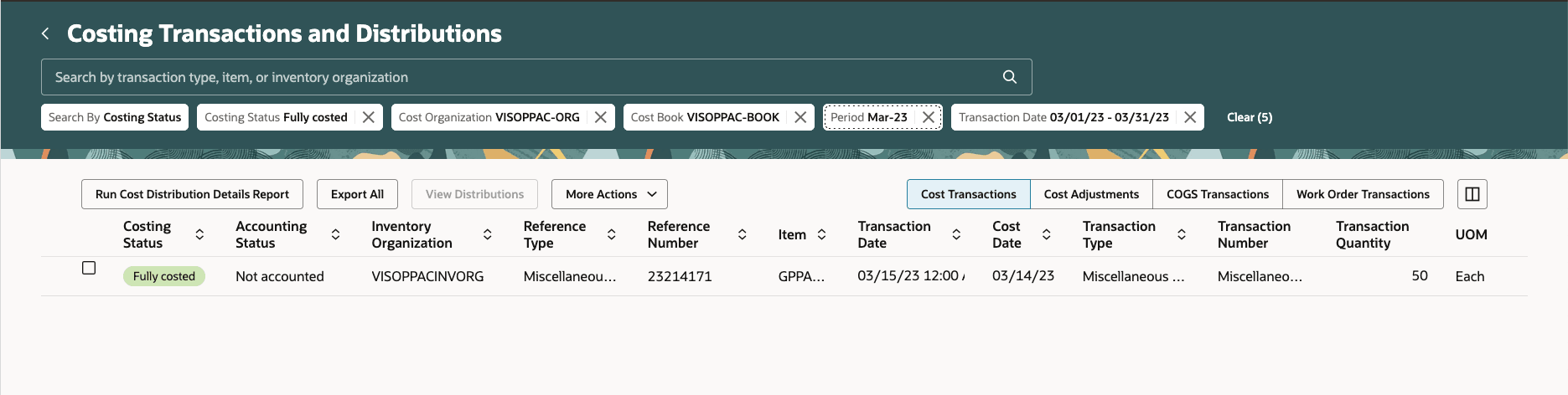

Using the Transaction Account Definition option in Cost Accounting that's introduced exclusively for customers using the periodic average cost method, you can set up mapping sets to identify and stamp the account combinations on costing transactions without having to run Create Accounting process for the same. You can use the Costing Transactions and Distributions page or the Cost Distribution Details Report to review the distributions with the account code combinations.
Let's take an example of a miscellaneous transaction that's fully costed and not accounted in a periodic average cost book.
Cost Accounting Distributions
Cost accounting distributions

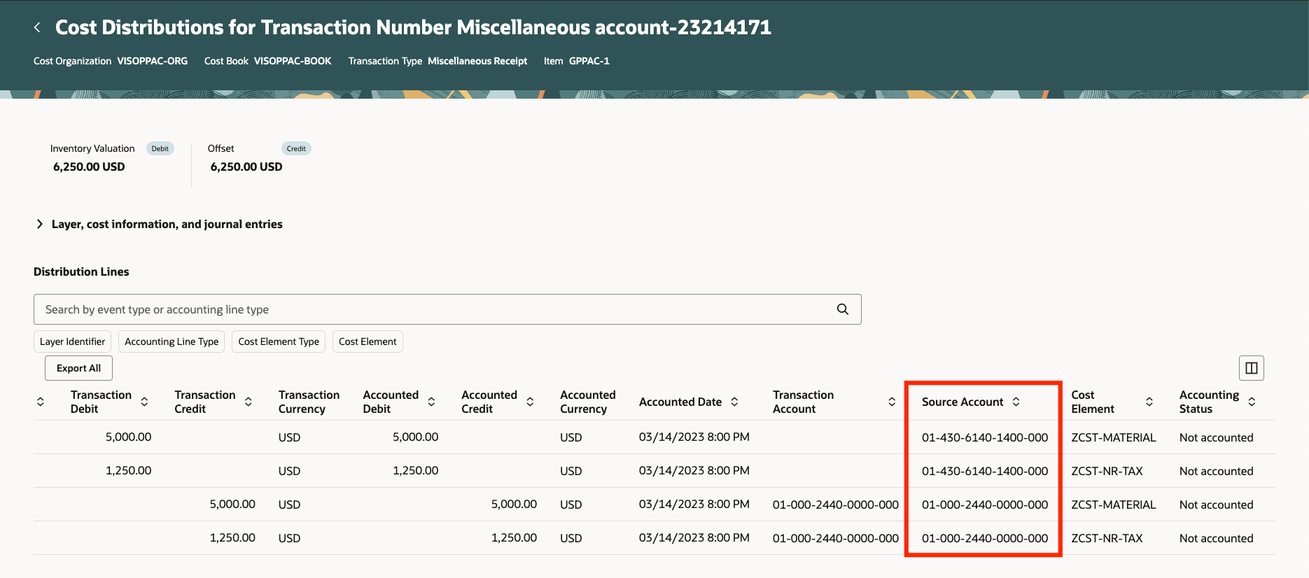

The Subledger transaction account builder process, which is a new subprocess in Create Cost Accounting Distributions, uses the mapping sets that are seeded in the Standard Accrual Subledger Method to identify a code combination and stamps this code combination on the distributions. These code combinations are visible under the Source Account column as shown here.
Distributions showing the source account stamped

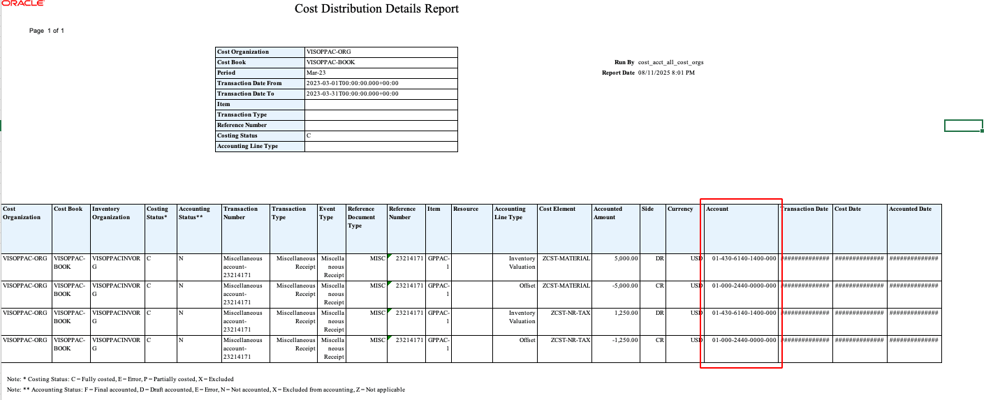

You can also see the source account in the Cost Distribution Details Report.
Cost Distribution details report

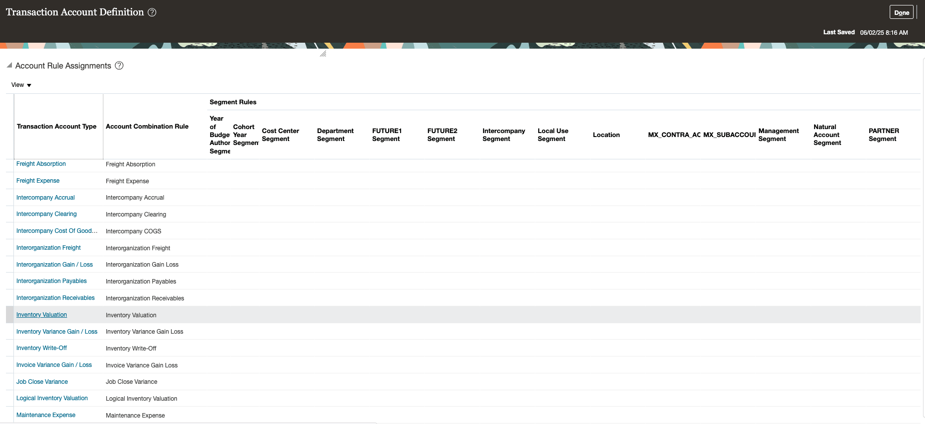

Task 4: Configure the Mapping Sets

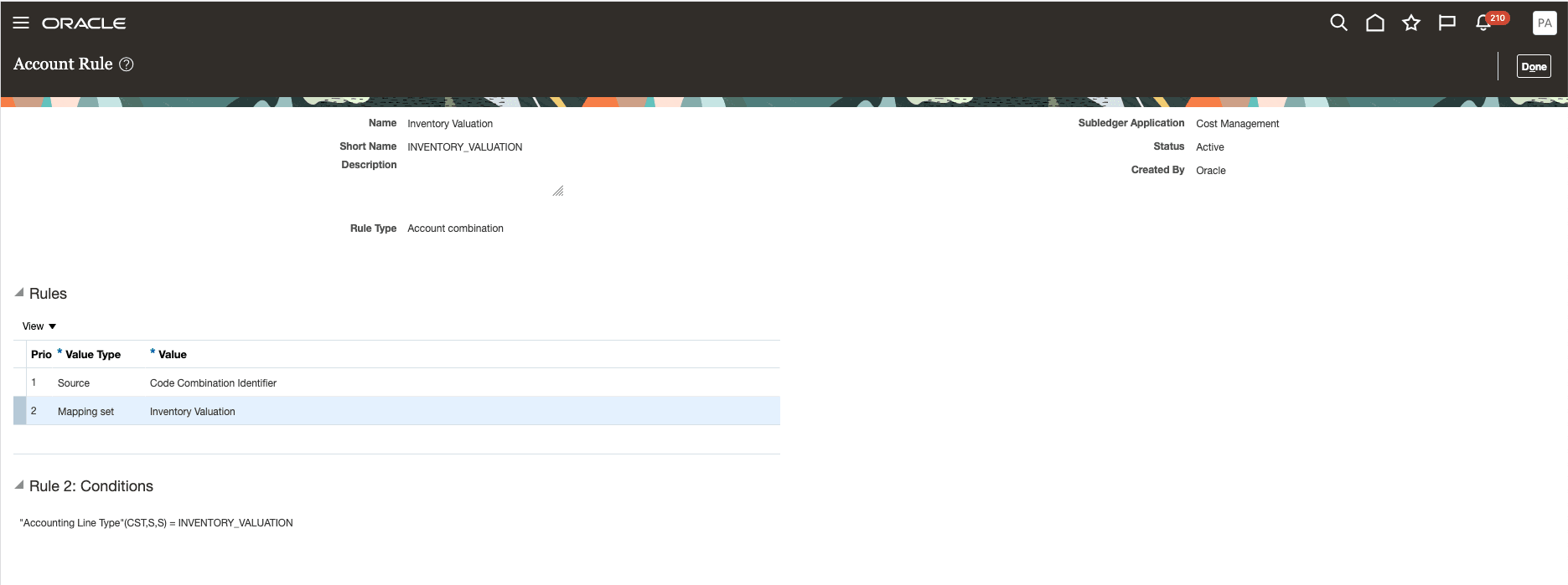

In the Setup and Maintenance work area, access the Manage Transaction Account Definitions task. The Transaction Account Definition uses the seeded Account Combination Rules, as shown here.
Transaction account definition
You can use the seeded mapping sets that are linked to these Transaction Account Types to set up the mapping sets. For example, for the Inventory Valuation account, you need to identify the mapping set linked to the Inventory Valuation account combination rule and modify it as per your requirements.
Account Tule
Account rule

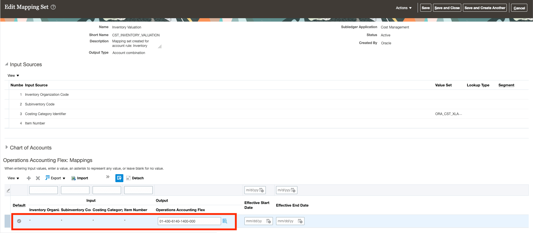

Because this is a seeded mapping set, you can only add the chart of accounts and enter the conditions in the Mappings section.
Mapping Sets
Mapping sets

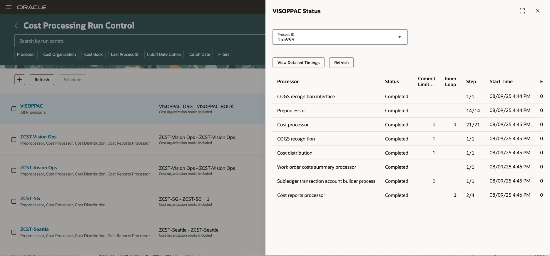

After you've enabled the profile option, you'll notice a new subprocess as part of the Create Cost Accounting Distributions process called Subledger transaction account builder process.
Cost Processing Run Control
Cost processing run control
