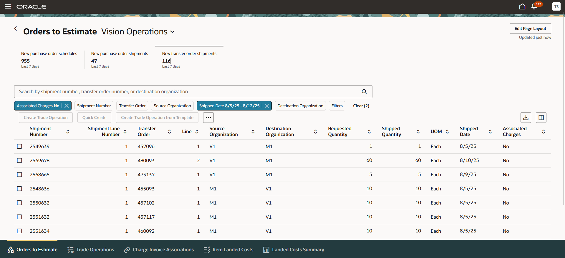

  • Search, filter, and process transfer order shipments from the Orders to Estimate page. The scorecard on this Redwood page provides a quick overview of transfer orders received in the last 7 days.
Orders to Estimate page with transfer order shipments created in last 7 days.

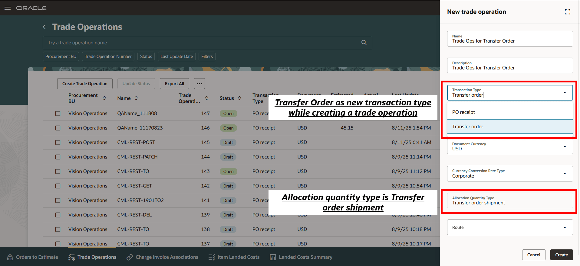

  • Create trade operations on the shipment quantity for transfer orders. Transfer orders are now supported as a valid transaction type in trade operations, allowing for proportional distribution of charges across transfer order shipments. Trade operations can be created from the Trade Operations page as well as the Orders to Estimate page.
Create trade operations screen

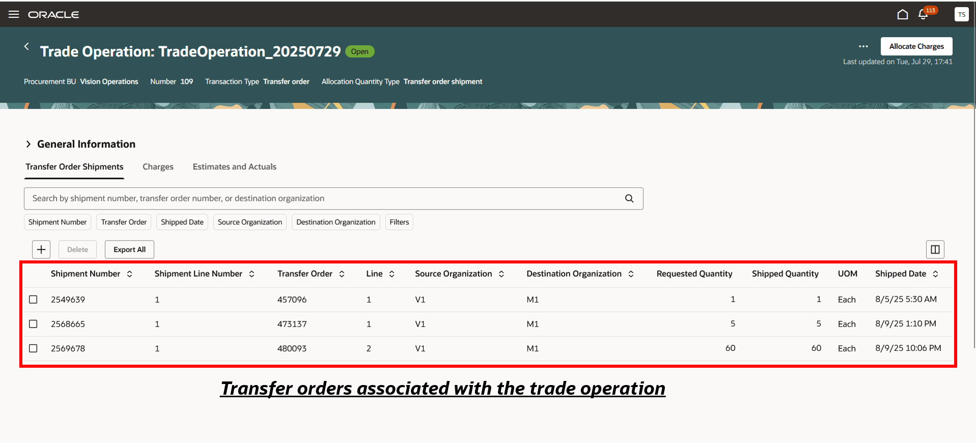

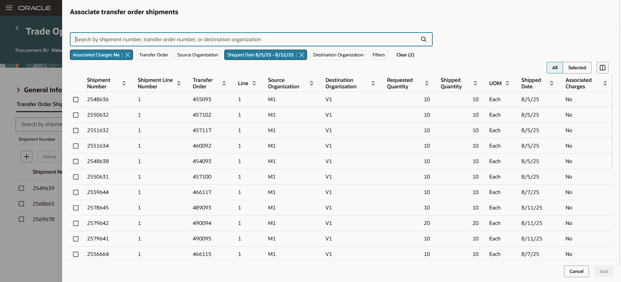

  • Automate transfer order shipment allocation by associating transfer order shipments at the trade operation level:
    • Add transfer order shipments to a trade operation from the Edit Trade Operation page or by using the new Default Transfer Order Shiplines REST API.
    • Use the extensive search options to quickly get to the list of transfer order shipments to be added to the trade operation.
    • Shipments added are automatically associated to each charge line in the trade operation along with the shipment quantity. The allocation process uses the shipment quantity to allocate landed cost charge estimate and actual amounts.
Edit trade operation screen
Add Transfer Order Shipments to a Trade Operation

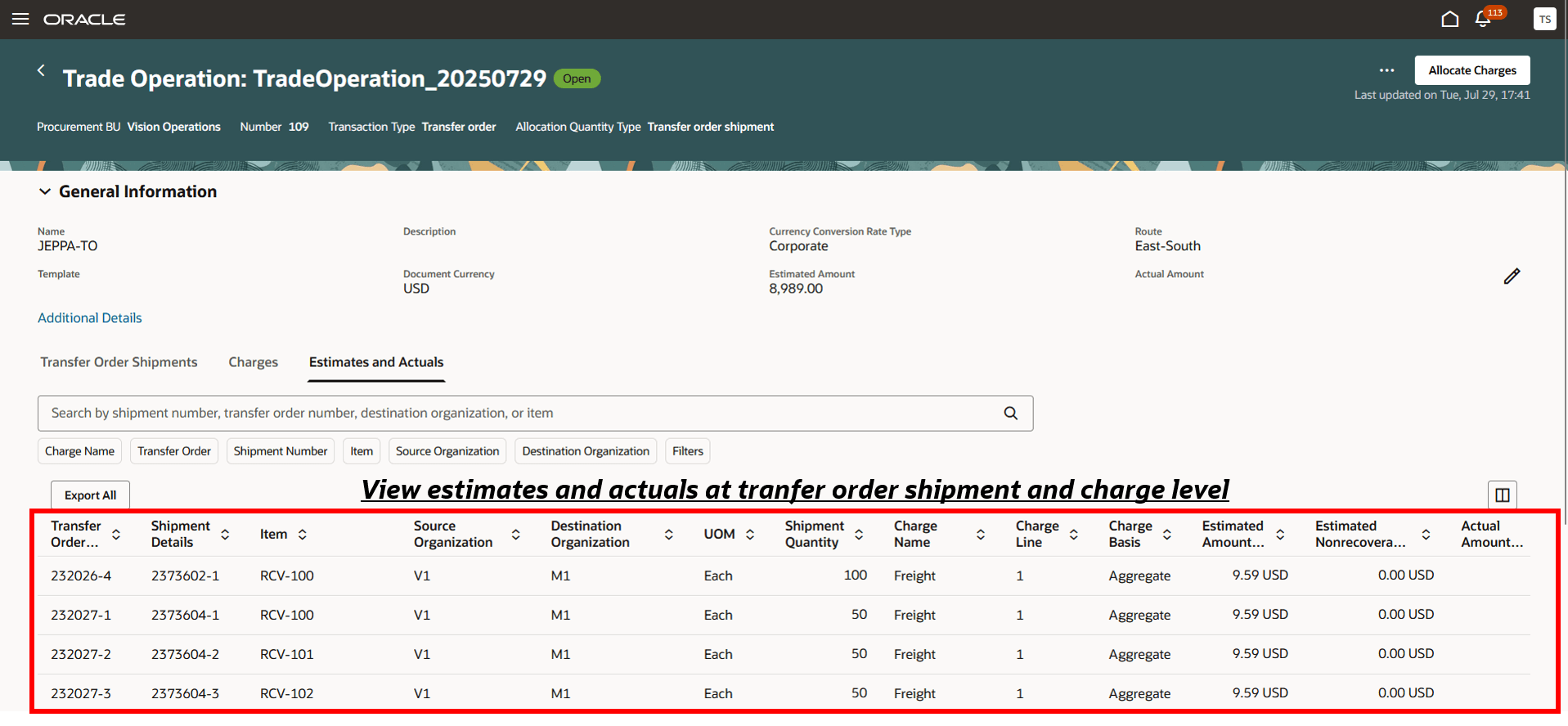

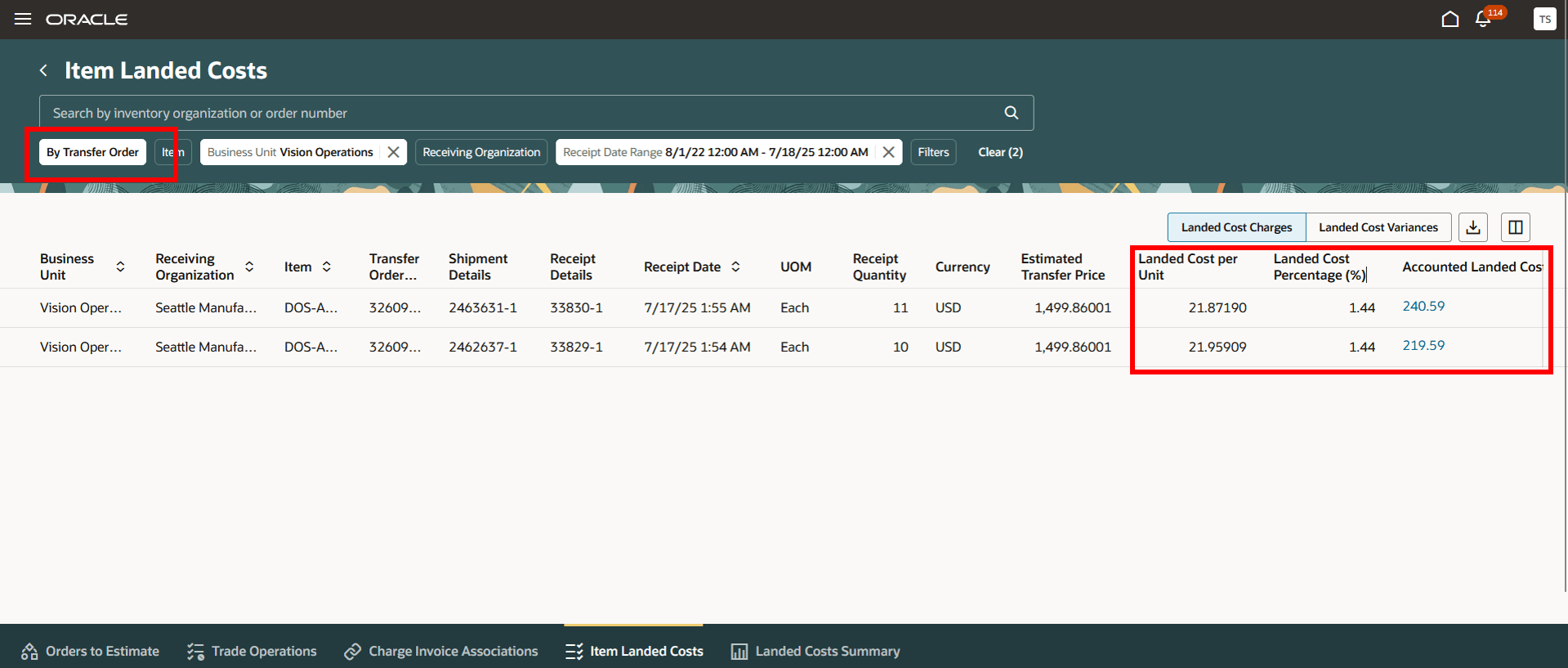

  • Allocate landed cost charges based on transfer order shipment quantity. You can view the allocated estimate and actual amounts in the Estimates and Actuals tab of the trade operation. You can also use the view item landed costs to get an overview of the total landed cost on the transfer order receipts.
Screenshots for Estimates and Actuals tab in Edit trade operation
Screenshot of the Estimates and Actuals tab for a trade operation
Screenshots for view item landed costs
Screenshot for Item Landed Costs

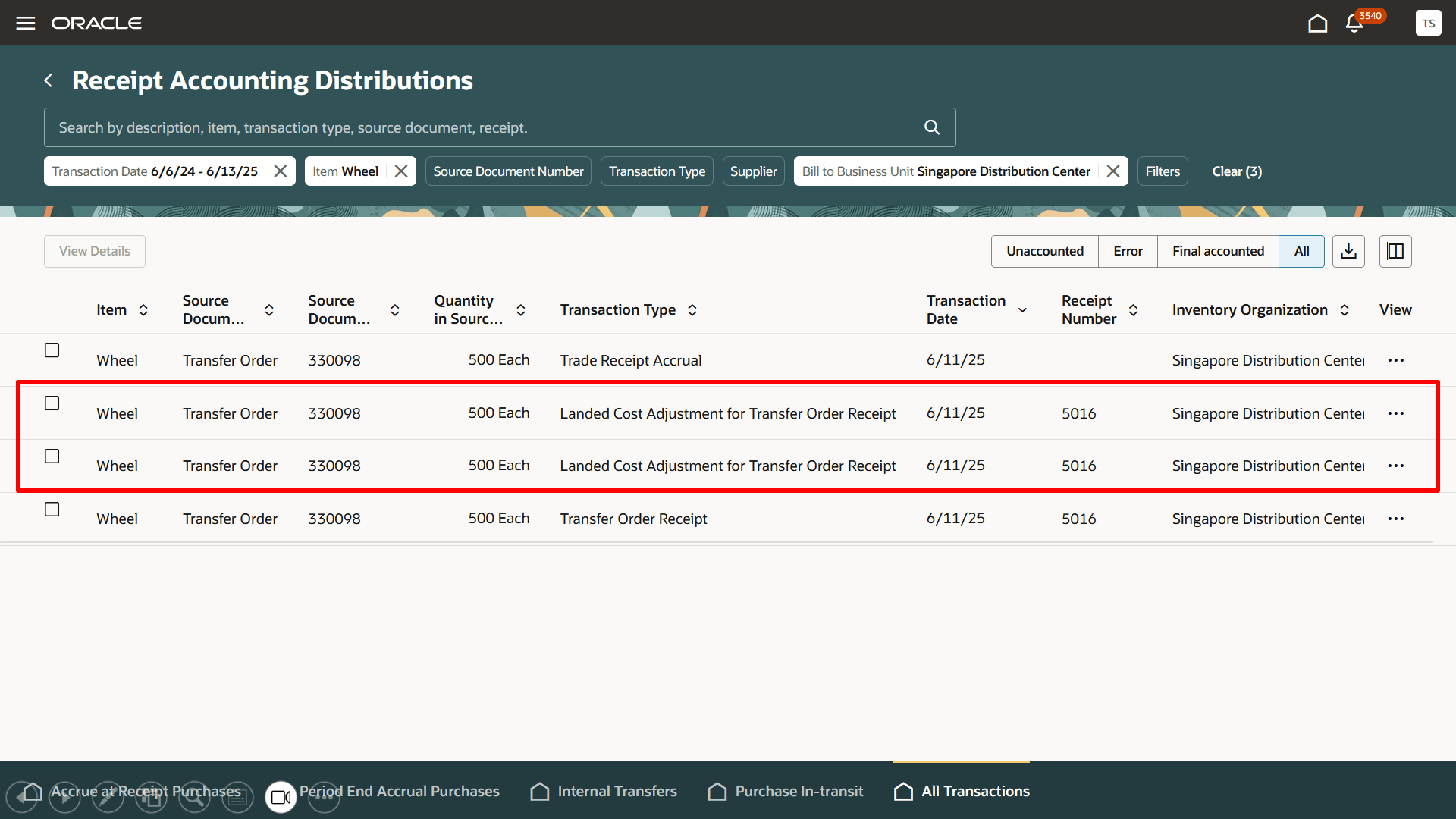

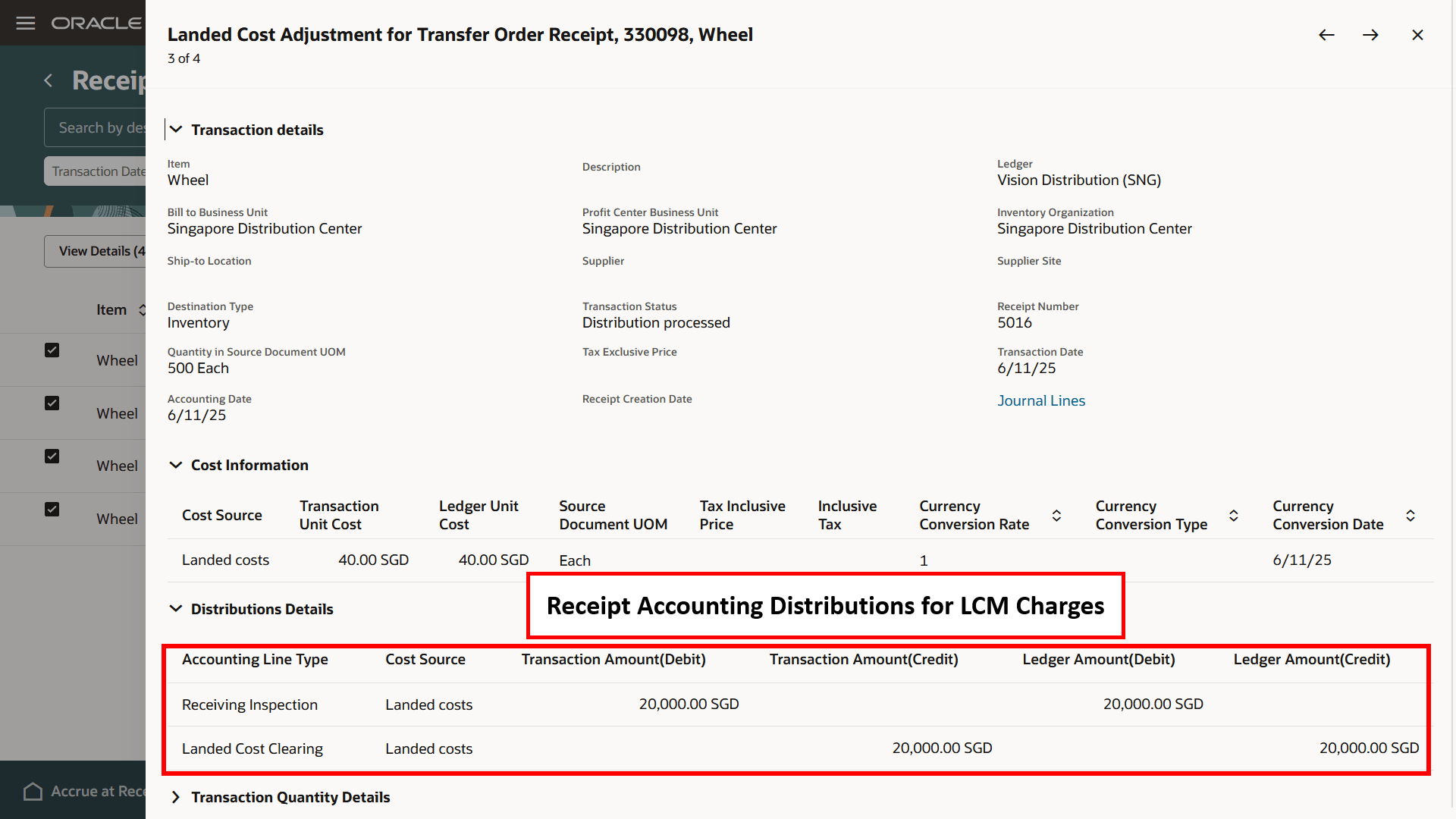

Receipt Accounting Distributions page
Receipt Accounting Distributions for Landed Cost Charges
Receipt accounting distributions for landed cost charges

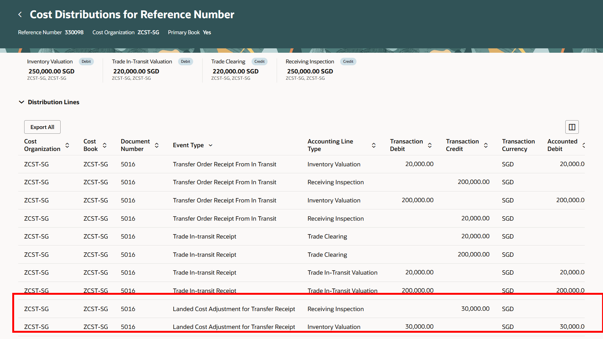

Cost Accounting Distributions for Inventory Destination Landed Cost Charges
Cost accounting distributions for inventory destination landed cost charges
