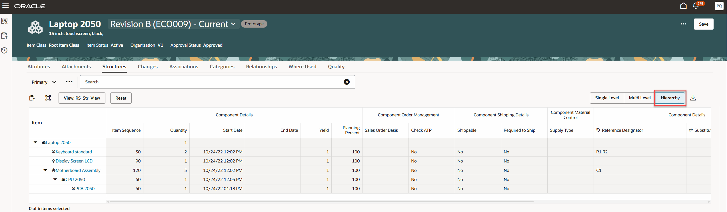

With the new hierarchy view that’s available in this release for the structure grid, you can see the entire tree of the structures in read-only mode with separate icons for parent sub-assembly, item, or document sub-assembly document, and document. This view is also available in the change context and will display redlines for the first-level only.
.Hierarchy View of the Structure

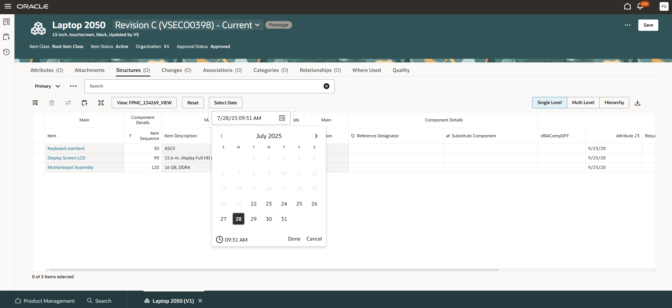

You can also view the structure and where used as of the selected context date. For structures, you can select the context date only for the current revision. Regardless of the component revision you choose, the where used report is derived based on the current revision.
Date Selector in a Structure for Current Revision

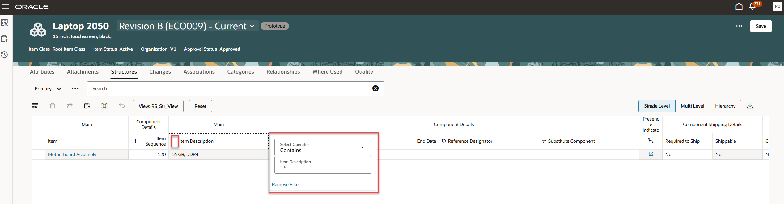

You can use Filter columns to narrow down the components that require review. The column filter icon appears when you hover over the column header.
Column Filters
Column Filters

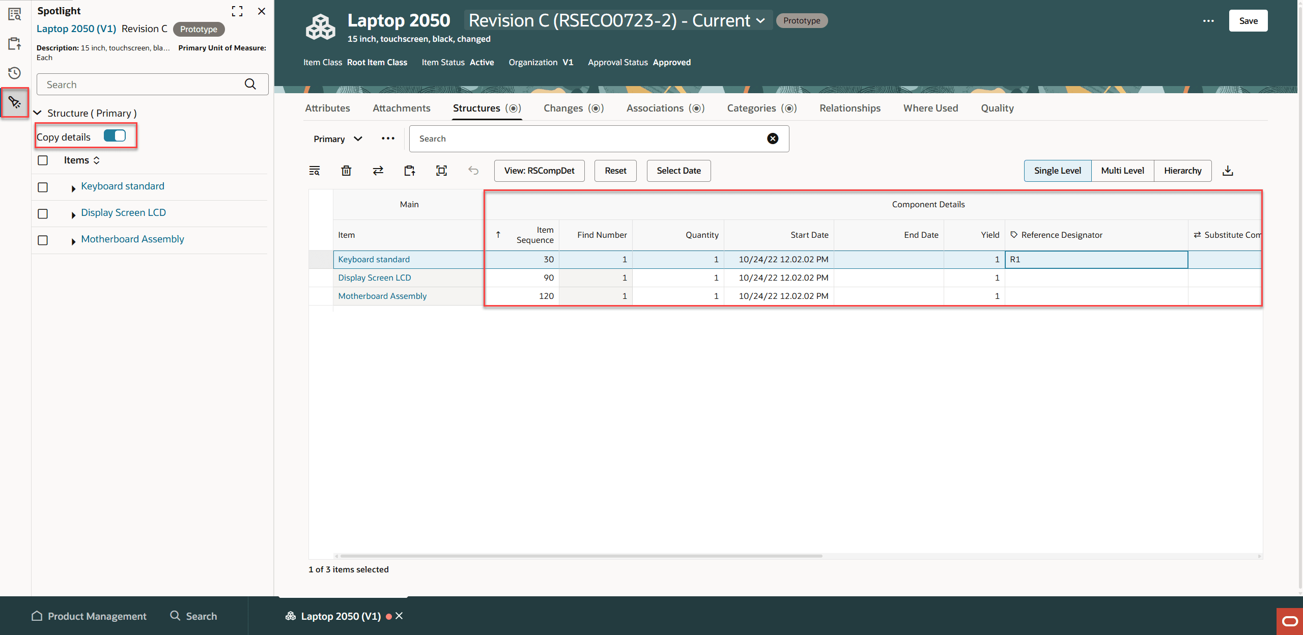

To help modify the single-level structure, an enhancement that provides a spreadsheet-like functionality has been introduced. Using the fill handle capability you can easily copy values to multiple components. As in a spreadsheet, you can select a cell, grab the small square in the corner, and drag it in any direction - up, down, vertically, or horizontally to fill cells.
To perform bulk edits, select multiple cells and drag up or down.
To quickly update cells, select multiple cells, right-click and select Autofill.
Fill Handle Action to Copy Quantity

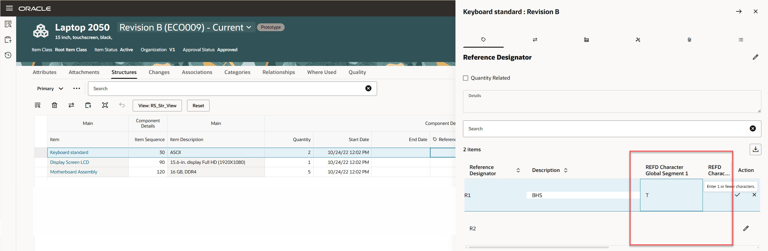

With the enhancement for reference designators in this release, you can modify the reference designator descriptive flexfields in the side panel.
Modify Descriptive Flexfield of Reference Designator in Side Panel
