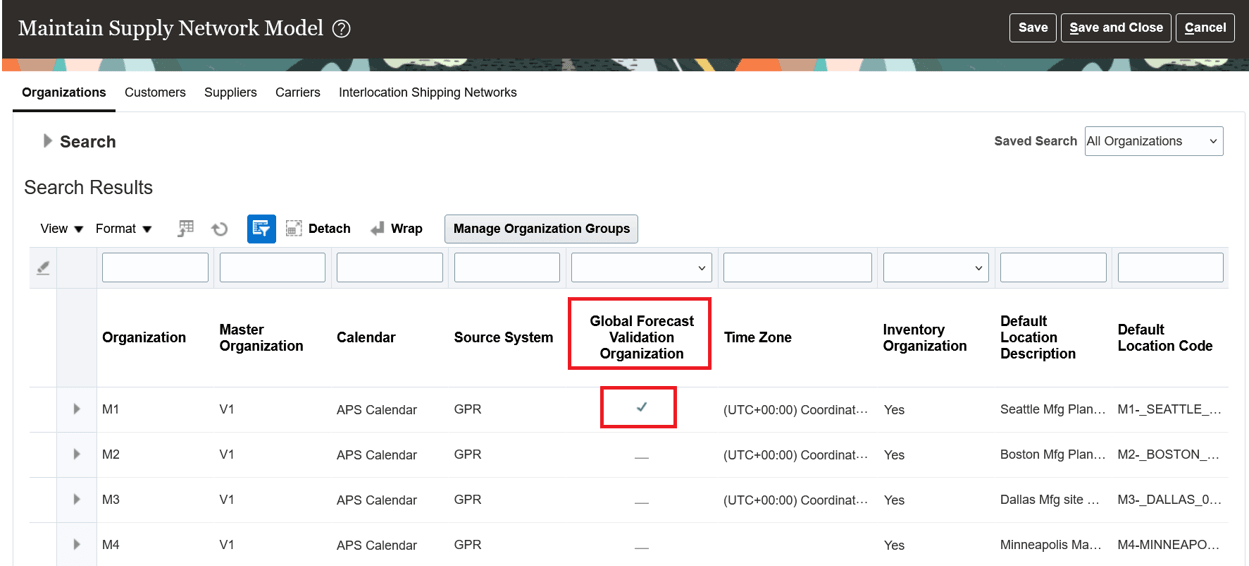

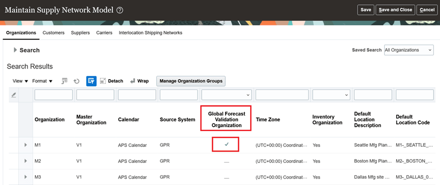

In this update, a new parameter Global Forecast Validation Organization is introduced in the Organizations tab of Maintain Supply Network Model page. You can select any one of the organizations within a source system as the validation organization for global forecasts. Supply Planning considers the primary UOM defined for items in this organization as the UOM of global forecasts.
If the parameter Global Forecast Validation Organization is selected and one of the included demand schedules is a global demand schedule in a supply plan, then supply planning by default includes this organization in the list of planned organizations.

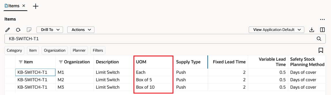

In this use case, consider three fulfillment organizations M1, M2, and M3 for item KB-SWITCH-T1. Following are the unit of measures for this item across fulfillment organizations:
Items
Organization M1 is selected as the global forecast validation organization in Maintain Supply Network Model page. The primary unit of measure of item KB-SWITCH-T1 is Each in organization M1.

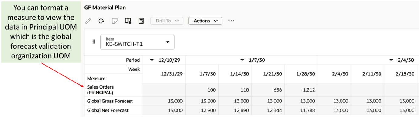

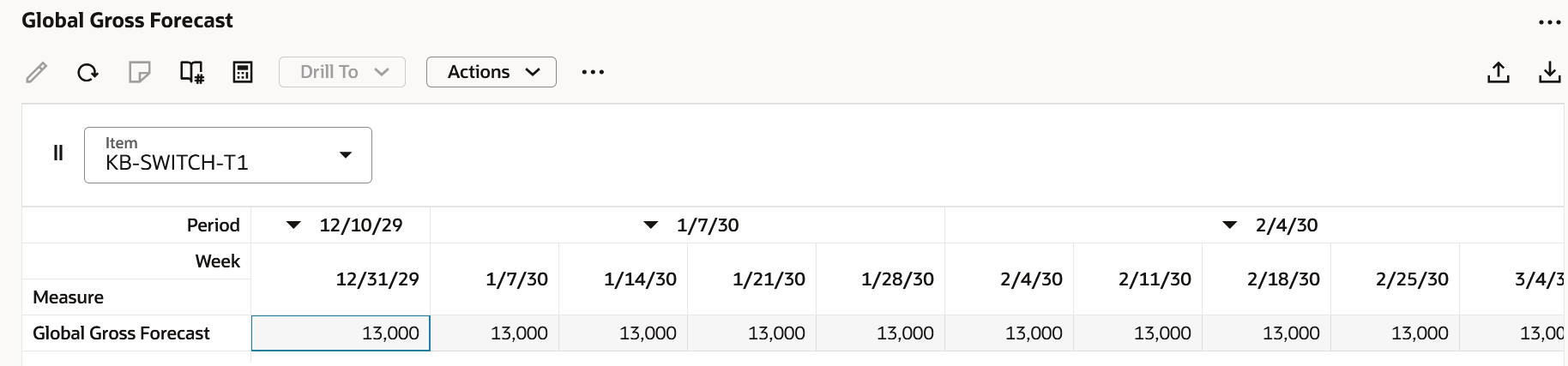

A supply plan is created with demand plan as input demand schedule and a global forecast is generated at Item and Week measure levels as shown in the given screenshot. Global gross forecast is generated in Each unit of measure.
Global Gross Forecast

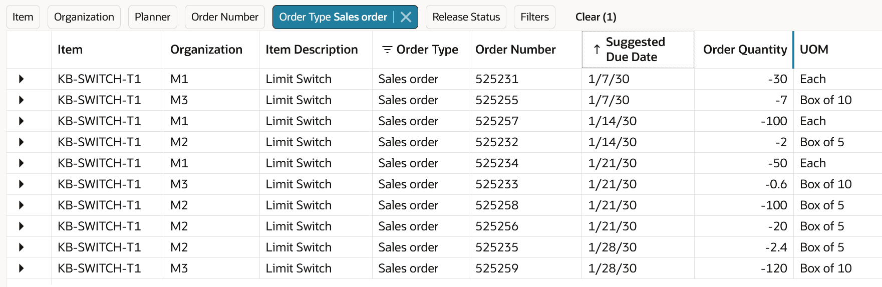

Following are the sales orders at various fulfillment organizations:
Sales Orders
The picture after consumption of the global gross forecast is:
Global Forecast Consumption
In this case, the sales orders are aggregated to Item measure level in the UOM of global forecast validation organization. There are two sales orders on 1/7/30 of quantity 30 (UOM: Each) and 7 (UOM: Box of 10), in the organizations M1 and M3 respectively. These sales orders are rolled up to Item level after converting their quantities to Each UOM as (30*1 + 7*10) = 100. Similarly, there are four sales orders on 1/21/30 of quantities 50 Each, 0.6 Box of 10 and (100+20) Box of 5 in organizations M1, M3 and M2 respectively. These sales orders are aggregated to Item level with quantity as (50*1 + 0.6*10 + 120*5) =656.
These sales orders consume the global gross forecast. On 1/7/30, the aggregated sales orders consume the global gross forecast for quantity 100 and a global net forecast is generated of 12, 900 (13000-100). Similarly, on 1/21/30 the global gross forecast of 13000 is consumed by sales orders for quantity 656 and global net forecast is generated as 13000-656=12344.

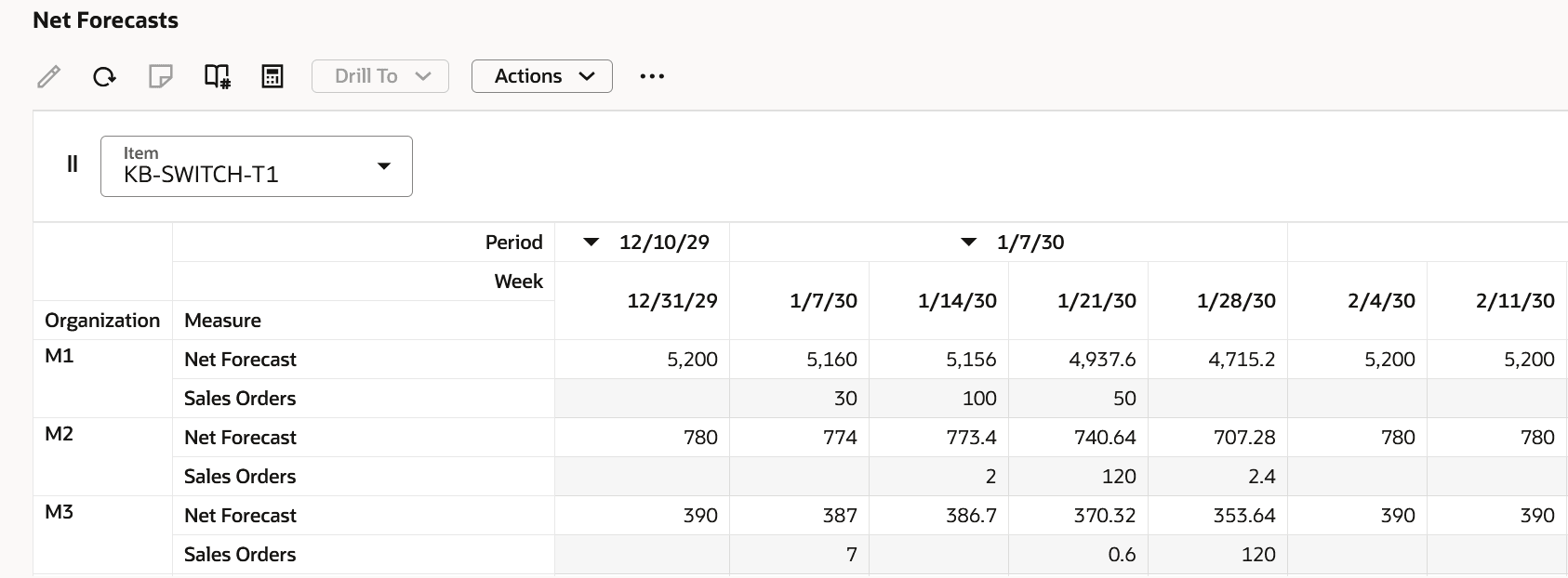

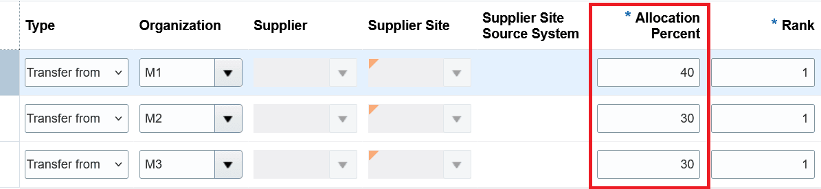

After consumption, the global net forecast is distributed to the respective shipment facilities for further planning. This forecast distribution is based on the sourcing split percentages as defined in the sourcing rules attached to the forecast distribution assignment set. In this case, the global net forecast is distributed to shipment organizations M1, M2 and M3 in the ratio of 40%, 30% and 30% respectively.
Sourcing Rules
The global net forecast on 1/7/30 of quantity 12900 is distributed as 5160 (12900 * 0.4) to organization M1, 3870 (12900*0.3) to M2 and 3870 (12900*0.3) to organization M3. While distributing the forecasts, quantities are converted to the item’s primary unit of measure for respective shipment organization. In this case,
- net forecast in the organization M1 would be 5160*1=5160,
- net forecast in the organization M2 would be 3870/5=774 and,
- net forecast in the organization M3 would be 3870/10=387
Net Forecast After Distribution in a User Defined Pivot Table
Similarly net forecasts are computed for each bucket.

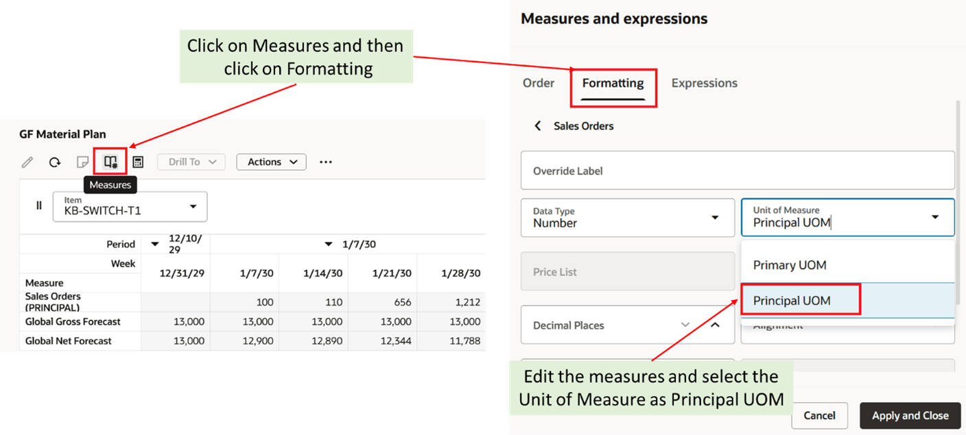

You can format the measure in a pivot table to view the data in global forecast validation organization UOM. You need to edit the measure under Formatting and select the unit of measure as Principal.
Viewing Data in Global Forecast Validation Organization UOM
Steps to Enable
You need to select one of the organizations within a source system as the Global Forecast Validation Organization. Navigate to the Organizations tab of Maintain Supply Network Model page, and then select the check box for Global Forecast Validation Organization for one of the organizations within a source system.
