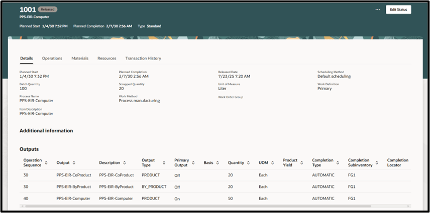

Let’s assume we have a work definition where the Batch Quantity is greater than the Primary Product Quantity.
| Batch quantity | 100 | ||||||
| Operation | Component | Initial Quantity | Output Item | Output item quantity | Product type | Resource | Resource required(hrs) |
| 10 | PPS-EIR-CPU | 111.25 | PPS-EIR-R1 | 100 | |||
| 20 | PPS-EIR-Monitor | 111.25 | PPS-EIR-R2 | 100 | |||
| 30 | PPS-EIR-KeyBoard | 111.25 | PPS-EIR-ByProduct/ PPS-EIR-CoProduct | 20/20 | By product/Co product | PPS-EIR-W1 | 100 |
| 40 | PPS-EIR-Mouse | 111.25 | PPS-EIR-COMPUTER | 50 | Primary | PPS-EIR-W2 | 100 |
Work Order in Oracle Fusion Manufacturing
Work Order

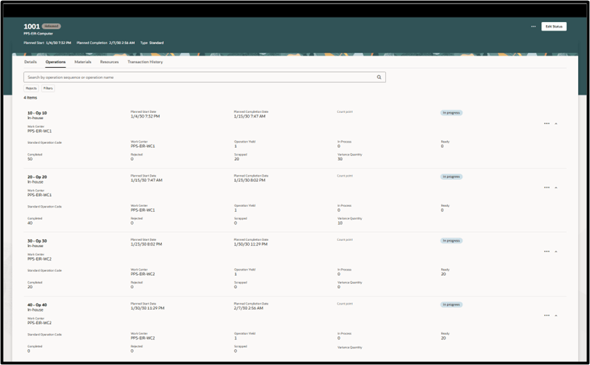

In-Progress Work Order Status:
The status of Operation 10 is recorded as follows across multiple transactions:
Transaction 1
- Completed Quantity: 50
- Scrap Quantity: 20
- Variance Quantity: 30
Transaction 2
- Completed Quantity: 40
- Scrap Quantity: 0
- Variance Quantity: 10
Transaction 3
- Completed Quantity: 20
- Scrap Quantity: 0
- Variance Quantity: 0
Transaction 4
- Completed Quantity: 0
- Scrap Quantity: 0

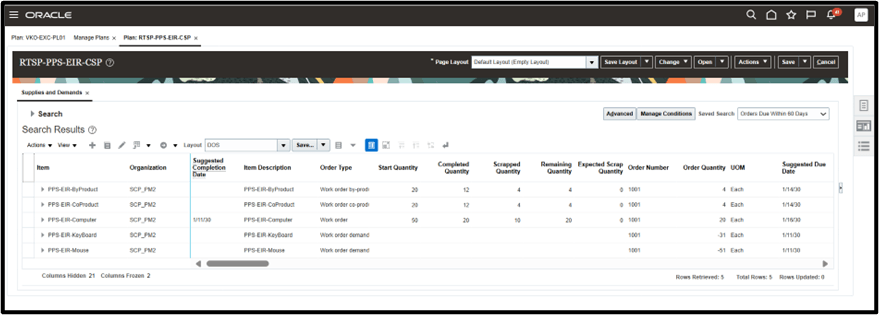

Once the work order is collected and the supply plan is executed, the Work Order Supplies for by-products, co-products, and primary products are calculated based on the estimated open operation end quantity for the operation.
The formula used is:
Order Quantity = Initial Start Quantity – Quantity Per Product × (Cumulative Variance Quantity + Cumulative Scrap Quantity + Completed Quantity)
Supplies Calculation
- By-Product Supply for
PPS-EIR-ByProduct
= 20 – 0.2 × (40 + 20 + 20)
= 20 – 0.2 × 80 = 4 units - Co-Product Supply for
PPS-EIR-CoProduct
= 20 – 0.2 × 80 = 4 units - Primary Product Supply for
PPS-EIR-Computer
= 50 – 0.5 × (40 + 20)
= 50 – 0.5 × 60 = 20 units
Component Demand Impact by Operation
- Operations 10 and 20:
No component demand is generated since there is no open quantity remaining for these operations. - Operations 30 and 40:
Component demand is based on the estimated open operation start quantity:
Order Quantity = Initial Quantity – Quantity Per Product × (Cumulative Variance + Scrap + Completed Qty)
Component Demand Calculation
- For
PPS-EIR-KeyBoard
(Op 30)
= 111.25 – 1.001 × (40 + 20 + 20)
= 111.25 – 1.001 × 80 = 31.17 units - For
PPS-EIR-Mouse
(Op 40)
= 111.25 – 1.001 × (40 + 20)
= 111.25 – 1.001 × 60 = 51 units

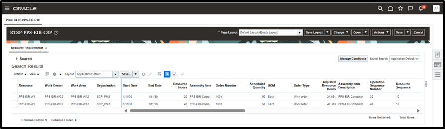

Resource Requirements Impact
For the given work order:
No Resource Requirements are generated since these operations are marked as complete. - Operations 30 and 40:
Resource Requirements are calculated based on the open operation start quantity, using the following formula:
Resource Hours = Initial Resource Hours – Resource Usage × (Cumulative Variance Quantity + Cumulative Scrap Quantity + Completed Quantity)
Example Calculations
- For PPS-EIR-W1 (Operation 30)
= 100 – 1 × (40 + 20 + 20)
= 100 – 1 × 80 = 20 hours - For PPS-EIR-W2 (Operation 40)
= 100 – 1 × (40 + 20)
= 100 – 1 × 60 = 40 hours
