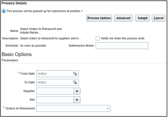

- From the Scheduled Processes area, schedule the Select Orders to Retransmit and Initiate Retransmission job.
- The Process Details dialog appears.
Select Orders to Retransmit and Initiate Retransmission ESS
- You can choose these options for the Orders to Retransmit field:
- Orders for which B2B transmission wasn't initiated: Retransmits all untransmitted POs including prior untransmitted versions.
- Orders with terminated B2B messaging status: Retransmits POs that have a Terminated status.
- All: Retransmits all untransmitted POs and those with a Terminated status.
- Select Submit to initiate retransmission of the selection of orders. The scheduled process ID is displayed. The ESS log shows the status of the orders that were retransmitted.
