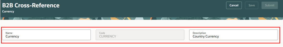

Define B2B Cross-References
  1. Select B2B Cross-Reference from the Tasks panel tab.
  2. Click Add to define a new B2B Cross-Reference.
  3. Enter the details and click Save.
Add a new B2B Cross-Reference
Add a New B2B Cross-Reference

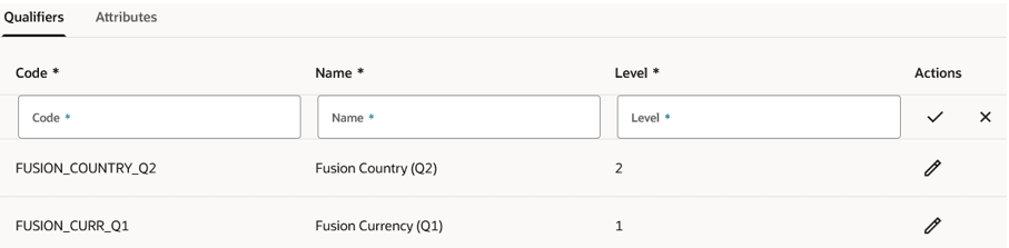

Add B2B Cross-Reference Qualifiers
  1. Under the Qualifiers tab, enter Code, Name, and Level.
  2. Under Actions, click Create to add your entries.

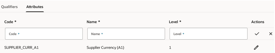

Add B2B Cross-Reference Attributes
  1. Under the Attributes tab, enter Code, Name, and Level.
  3. Click Save and Submit after you have added the details.

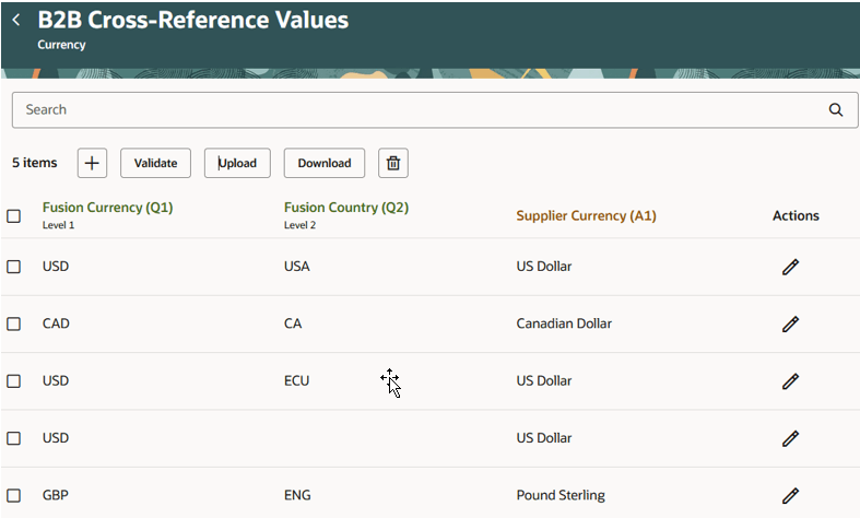

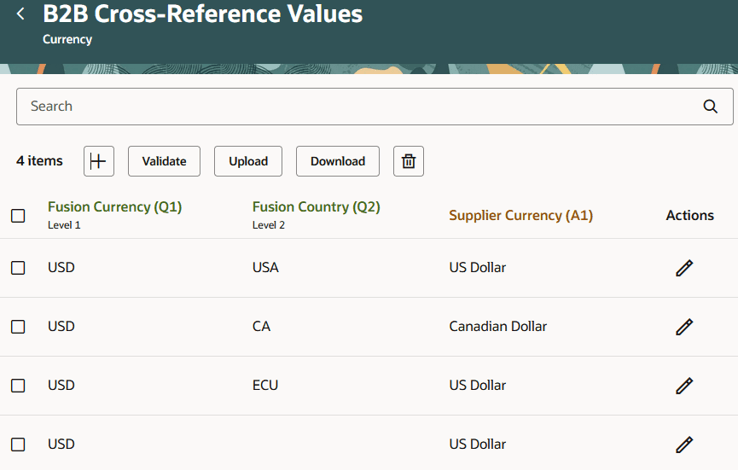

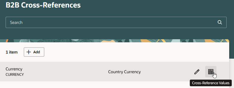

Configure Cross-Reference Values
  1. On B2B Cross-References page, click Cross-Reference Values.
B2B Cross-References – Cross-Reference Values icon
B2B Cross-References: Cross-Reference Values icon
  1. The qualifiers and attributes created earlier display as column headers.
  2. Click Add.
B2B Cross-Reference Values

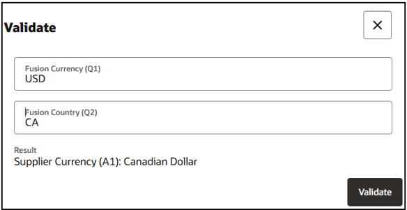

Validate Cross-Reference Values
  1. On the B2B Cross-Reference Values page, click Validate.
  2. Enter a value for each of the qualifier fields. If a matching attribute value exists, it will be displayed in the result.

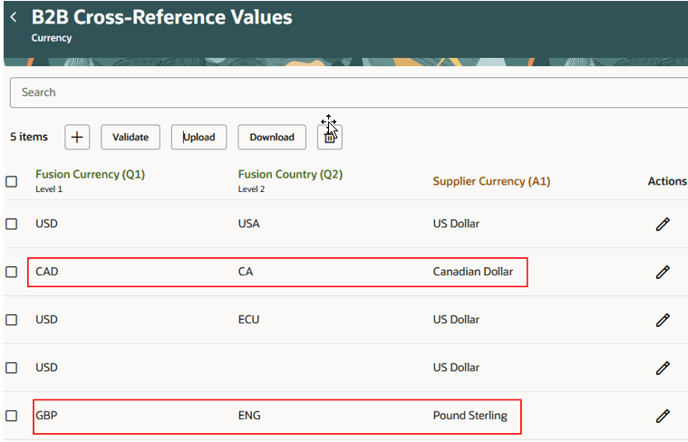

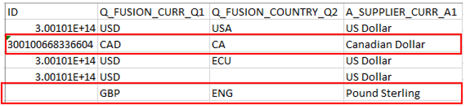

Upload and Download Cross-Reference Values
  1. Click Download to generate and save .csv on your computer.
  2. To make changes, open the .csv and modify the intended values. Format the ID cell as Text without changing its value.
  3. To add new rows, enter the qualifier and attribute values. Leave the ID cell blank.
  4. Save the .csv.
Csv file with a change to existing row and with a new row added
.csv File With a Change to Existing Row and With a New Row Added
  1. Click Upload. The values will appear on the page.
Updated B2B Cross-Reference Values

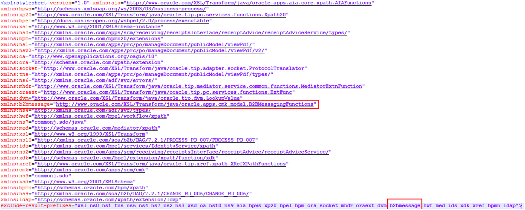

  3. Navigate to the XSL folder and open the file.
  4. Make these updates:
    1. The class below needs to be added to the namespaces area at the top of the XSL:
xmlns:b2bmessage="http://www.oracle.com/XSL/Transform/java/oracle.apps.cmk.model.B2BMessagingFunctions"
    1. b2bmessage needs to be added to the exclude-result-prefixes:
Stylesheet declaration area
Stylesheet Declaration Area

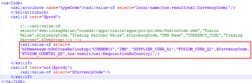

    1. Look for the dvm:lookupValue that you need to cross-references. For example, CURRENCY_CODE.
    2. Comment it out.
    3. Add the b2bCrossRefLookup() function:
<xsl:value-of select="b2bCrossRefLookup('DecisionCode','DefaultValue','AttributeCode','QualifierName1','QualifierValue1','QualifierName2','QualifierValue2',...)"/>
b2bCrossRefLookup() Function

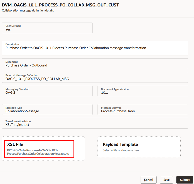

    1. Save the XSL file changes.
  1. On the B2B Message Definitions > Collaboration Message Definitions tab, create a duplicate of the message you downloaded the transformation package for. Upload the customized XSL.
  2. Click Submit after you have added all other details.
Duplicate message definition-upload custom XSL
Duplicate Message Definition - Upload Custom XSL

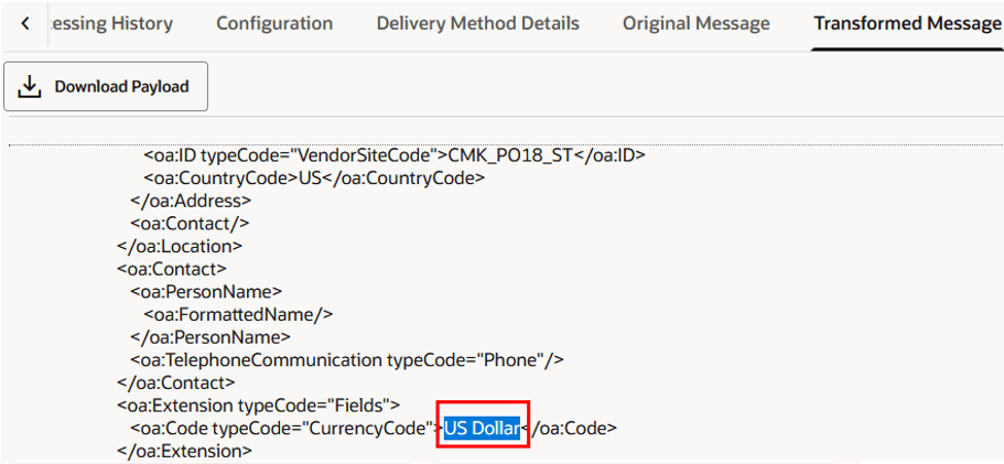

  2. After the message is processed, the transformed file will show the value of the attribute.
Transformed Message payload
B2B Cross-Reference Values - Structure
The b2bCrossRefLookup() function first looks for a match for FUSION_CURR_Q1=USD and FUSION_COUNTRY_Q2 = US. Since it doesn't find one, it removes the qualifier with the highest level, which is FUSION_COUNTRY_Q2 = US. At this point, it finds a match for FUSION_CURR_Q1=USD which is would be SUPPLIER_CURR_A1= US Dollar.
