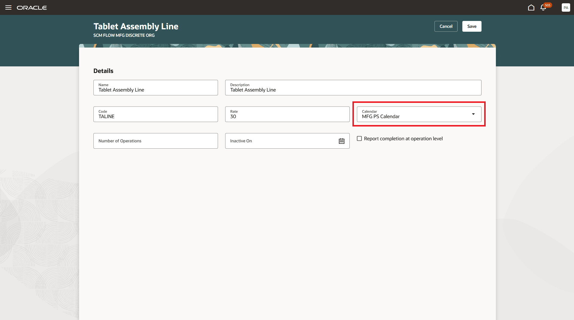

In hybrid environments, using the same production calendar for discrete, process, and flow manufacturing and maintenance activities can create challenges when different shift patterns are needed to accurately reflect actual resource capacity and availability. You can now model a different shift pattern for a specific production line by assigning a calendar that is used for flow schedule execution. This setup determines the available hours and is used in conjunction with the line rate to facilitate flow scheduling.
Associating a Calendar to a Production Line

- If no calendar is associated to a production line, then the plant level calendar is used for flow scheduling.
