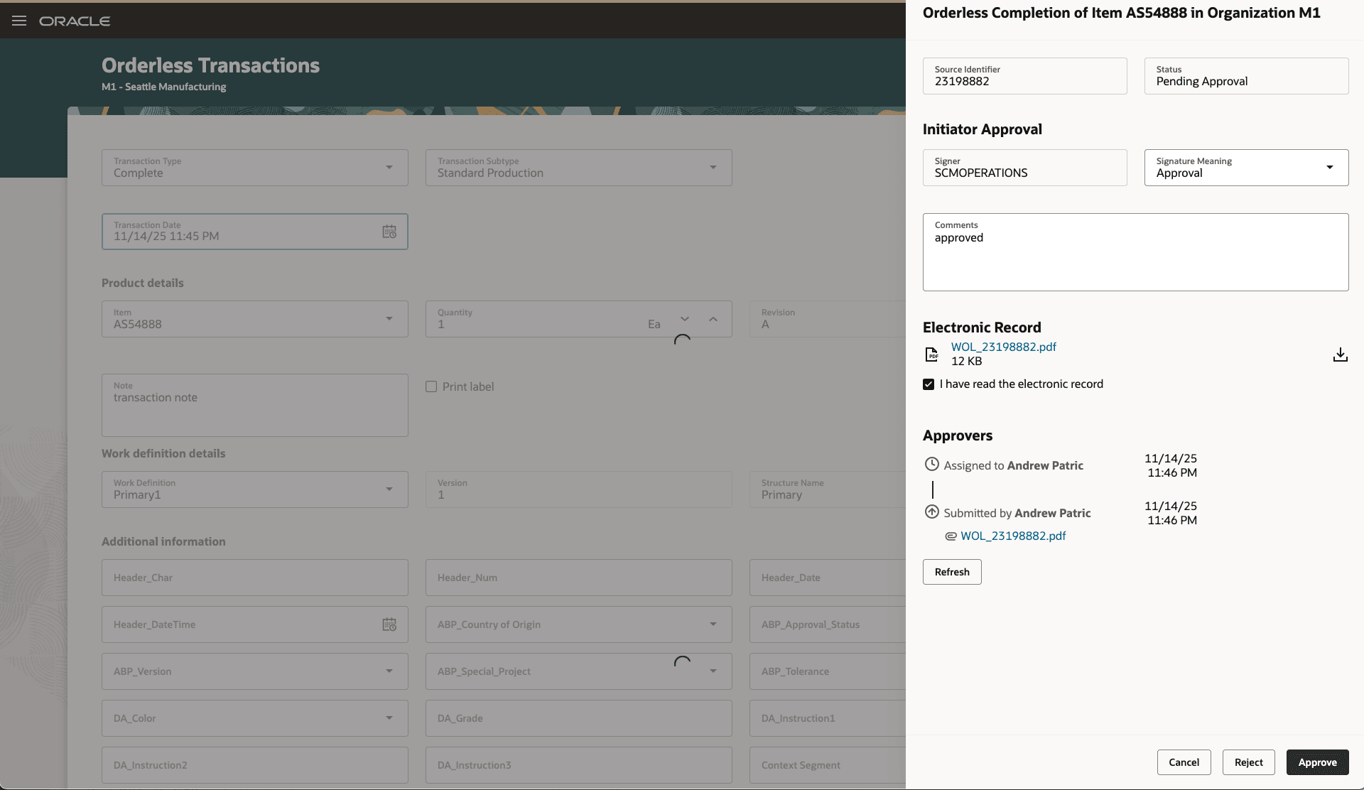

When lean manufacturers are also in a regulated industry, they require efficient production reporting without the administrative tasks associated with work order management in addition to secure, auditable production records to ensure regulatory compliance. You can now capture inline electronic signatures and automatically generate compliant electronic records when reporting orderless transactions using the Redwood user experience.
With this feature you can:
- Report orderless transactions with an inline approval using electronic signatures and approval comments.
- You can approve or reject the transaction, or refresh the page to view inline approval statuses.
- View the electronic record template to review the transaction before approval.
- See the approval history of the transaction.
Approve Orderless Transactions Inline and View Approval History
E-signature and e-record support for orderless transactions aids the regulatory compliance documentation required for the manufacture of products in regulated industries.
