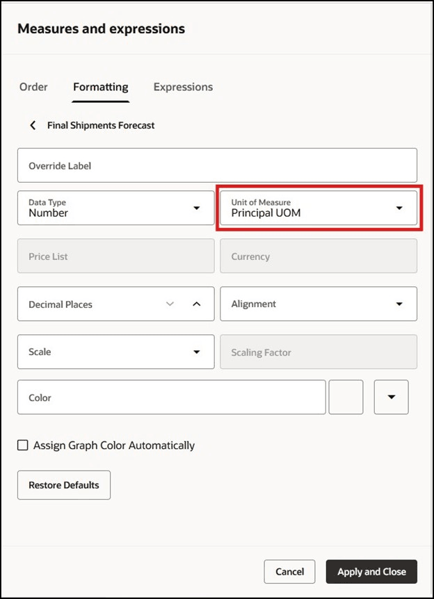

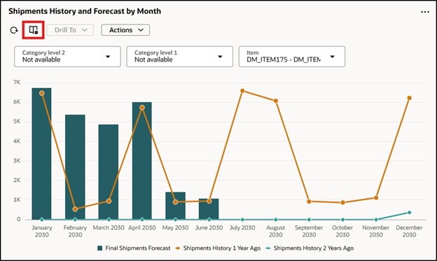

To convert the measure values in the Redwood UI for an open table or graph, follow these steps:
  1. On the toolbar, click the Measures icon.
The Measures and expressions drawer will open.
  1. Go to the Formatting tab.
  2. Click the Edit icon in the Display column for the measure for which you want to display values in the principal UOM.
The fields for the measure are displayed.
  1. In the Unit of Measure field, select Principal UOM.
  2. Click Apply and Close.
Measures Icon for Redwood Graph
Formatting Tab in Measures and Expressions Drawer

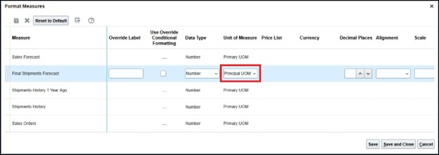

To convert the measure values in the classic UI for an open table or graph, follow these steps:
  1. On the toolbar, click View > Format Measures.
The Format Measures dialog box opens.
  1. Select the row for the measure for which you want to display values in the principal UOM.
  2. In the field in the Unit of Measure column, select Principal UOM.
  3. Click Save and Close.
Format Measures Dialog Box

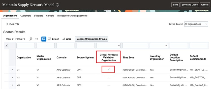

The principal UOM is available for selection only if an organization has been selected as the global forecast validation organization on the Organizations tab on the Maintain Supply Network Model/Supply Network Model page for any source system, and this source system doesn’t have to be the one assigned to your plan.
You should select the principal UOM for a measure for a table or graph only if the organization selected as the global forecast validation organization belongs to your plan’s source system. Otherwise, selecting the principal UOM will result in blank values being displayed for the measure.
Column Titled Global Forecast Validation Organization on Organizations Tab on Page Titled Maintain Supply Network Model
