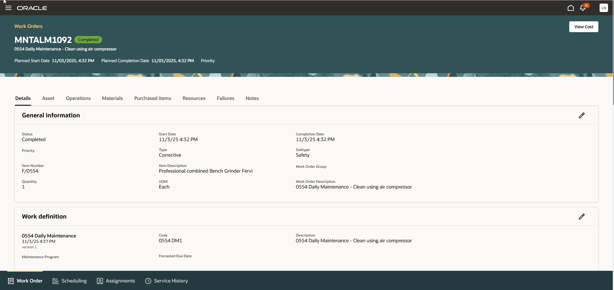

You can now access the Maintenance Work Order Costs page by clicking the View Cost button on the Edit Maintenance Work Order page in Maintenance Supervision as seen in the screenshot below.
View Cost Button in Maintenance Supervision

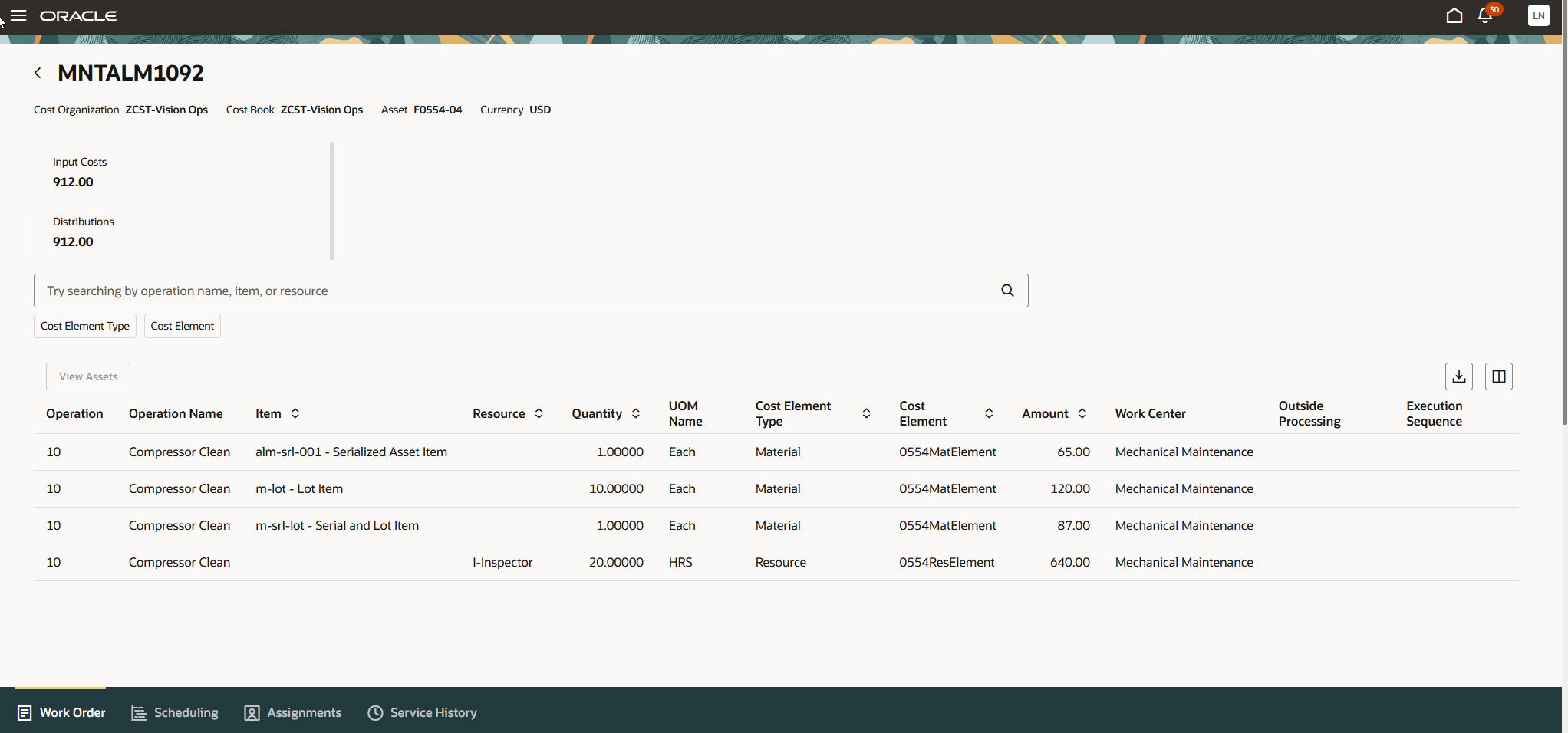

The Work Order Costs page shows a detailed breakdown of material and resource costs for the selected work order. In addition, you can use the available search capabilities to quickly locate relevant cost information and export reports for further analysis.
Work Order Cost Details
